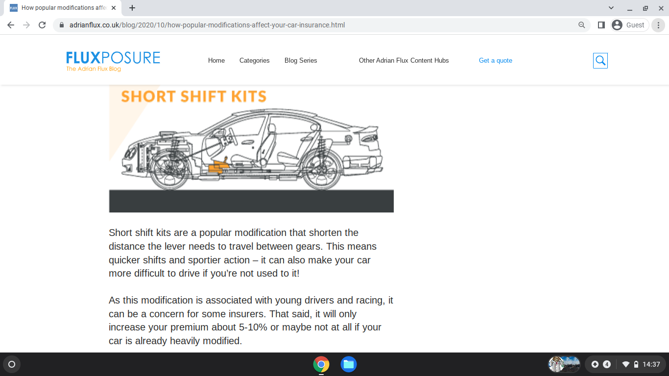

1 hour ago, Smoothrunnings said:
ShortShift \ QuickShift
What does this even mean?
Short shifting a gearbox (manual or automatic) can mean either "changing gear earlier" (to keep the revs down) or modifying the gear linkage to reduce the travel between ratios.
Quick shift usually means either moving the lever faster or reducing the time an auto (or automated manual) spends in neutral between gears.
So Quick Shift / Short Shift conversions are not uncommon and AF have it in their 'Declared Mod blog'.
Edited by roottoot
Pedal box has nothing to do with the gearbox. It more closely relates to a mode selector that changes to the response of the accelerator on a manual car.
I'd be phoning about for a company that knows what it is.
