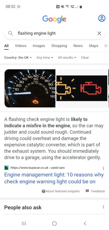

Well this screenshot from Google plus the link below suggests this is most likely to be spark plugs.

An Engine Management light / Exhaust Management light can be a Brain Fart of the car / ECU.
There can be a misfire, there can be a fuel issue, there can be an many issues including the car sitting ticking over too long and then a bit of sooting up, over fueling or under fueling, it can be a ca sitting in the sun and the under bonnet / airbox getting hot and the ar starting.
Arnold Clark Techs are the ones that can have a car infront of them and be clueless unless the machine tells them exactly what is wrong.
So any websites or help generalising is not much cope IMO & IME.
