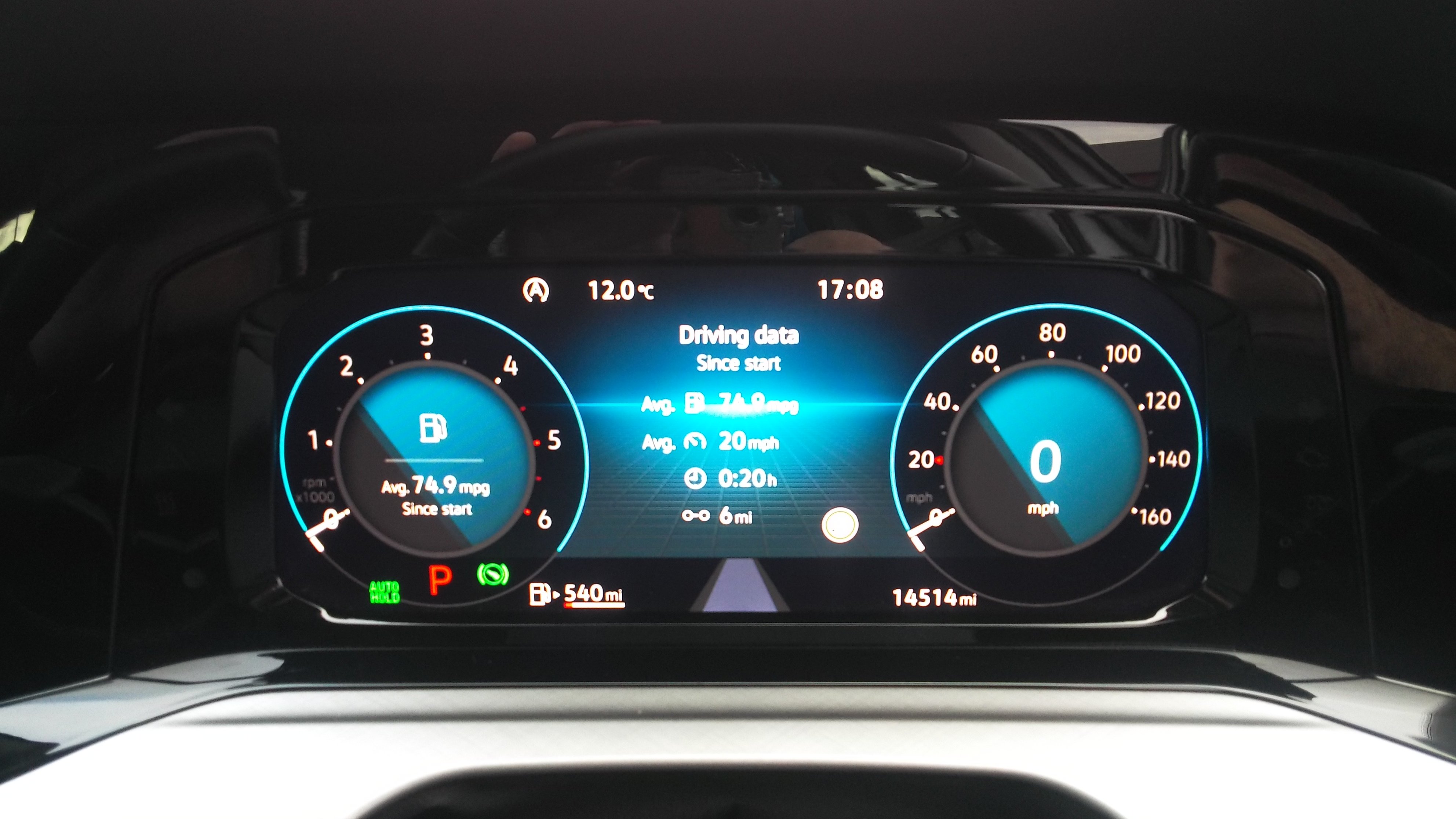

10 hours ago, b1ackb1rd said:
I get MUCH worse economy figures than that with my 1.6tdi, do you draught buses and HGV's, or have pedals fitted ?
70mpg even 84 mpg I can only reach when driving 30 mph all day long. But that is not real world. 60-70 mph equals  50mpg to 54 mpg.
edit: using cc all the time.
