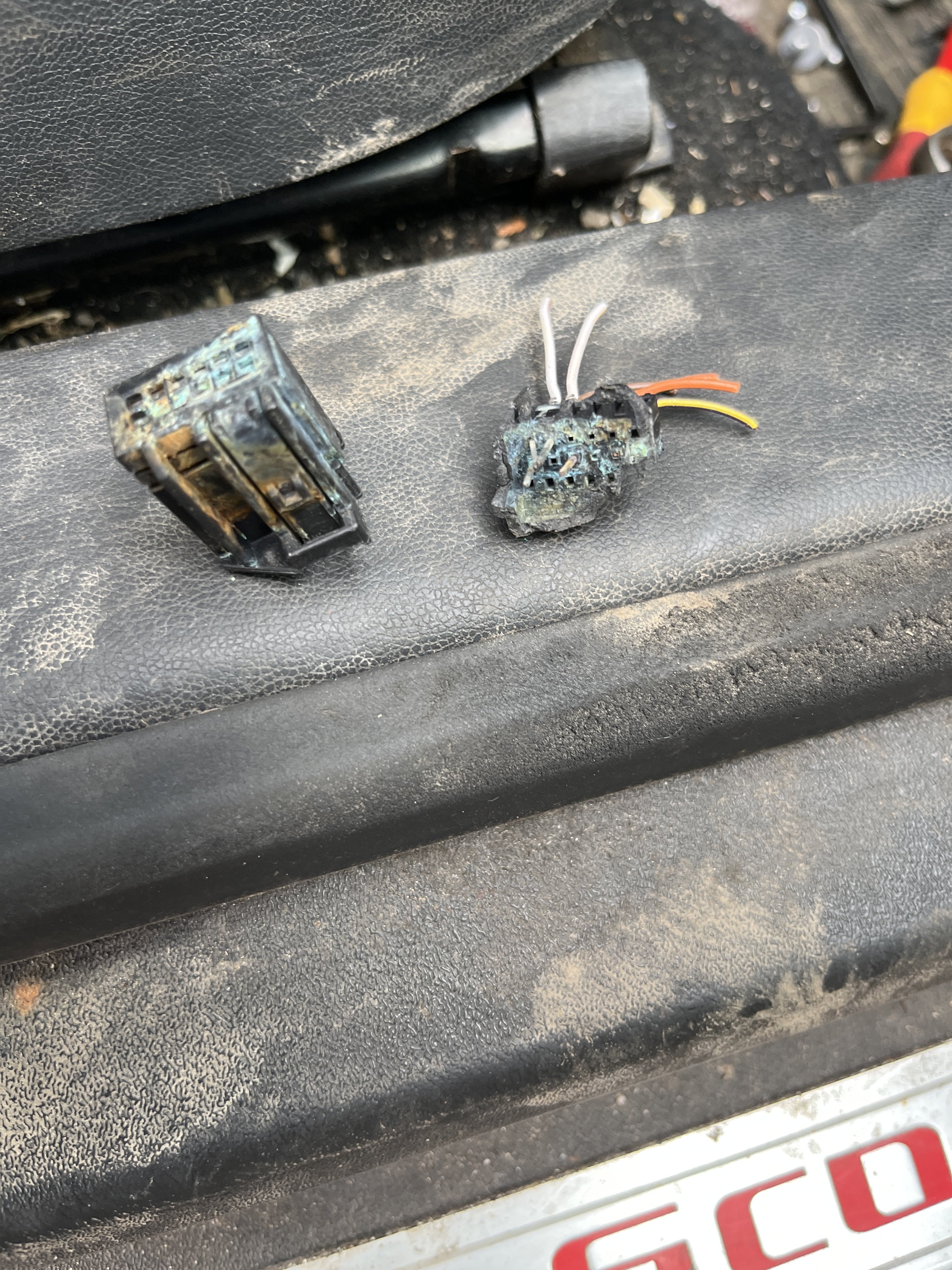

Hi everyone. I have a ex paramedic scout 2012 . Drivers central locking off side central locking and electric window and also drivers mirror repeater all stopped working at same time. Anyone know of a common control far all ? Thanks
Most likely a broken wire in the door bellows area.
Open the door, activate the hazard lights and carefully manipulate the bellows all the while watching for life in the repeater/puddle light.

Thanks will give it a try/test loom 👍
Sorry for delay. Just had chance to look at it. Tried wiggles no joy so took apart bellows etc one of plugs half of the pins corroded away. Plug and socket damaged. Temp repairs made all now working.thanks help appreciated. Everything changed around 2009 . Again thanks
