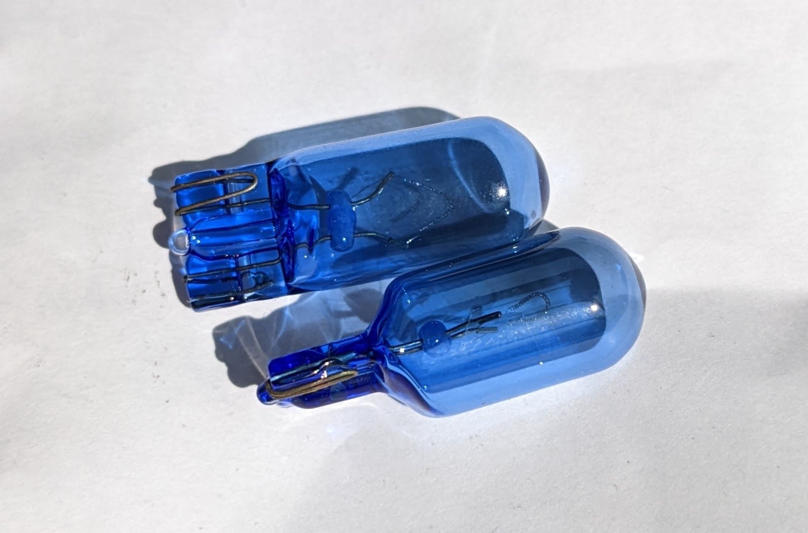

I have now changed the sidelight bulbs, but I found that the old ones were blue! The replacements, purchased from a reputable online store, are clear.
Anyone know what colour they're supposed to be? I can't find anything in the manual.
Are the blue ones perhaps non-standard and giving the sensor a hard time?
These are not the standard bulbs. Any led lamps need coding in. Mine were showing an intermittent fault until coded.
The replacements were also tungsten, but clear. Osram W5W.
Seems weird but I had a set of these in my daughters fiat 500 that threw up errors. Ebay cheap crap.
