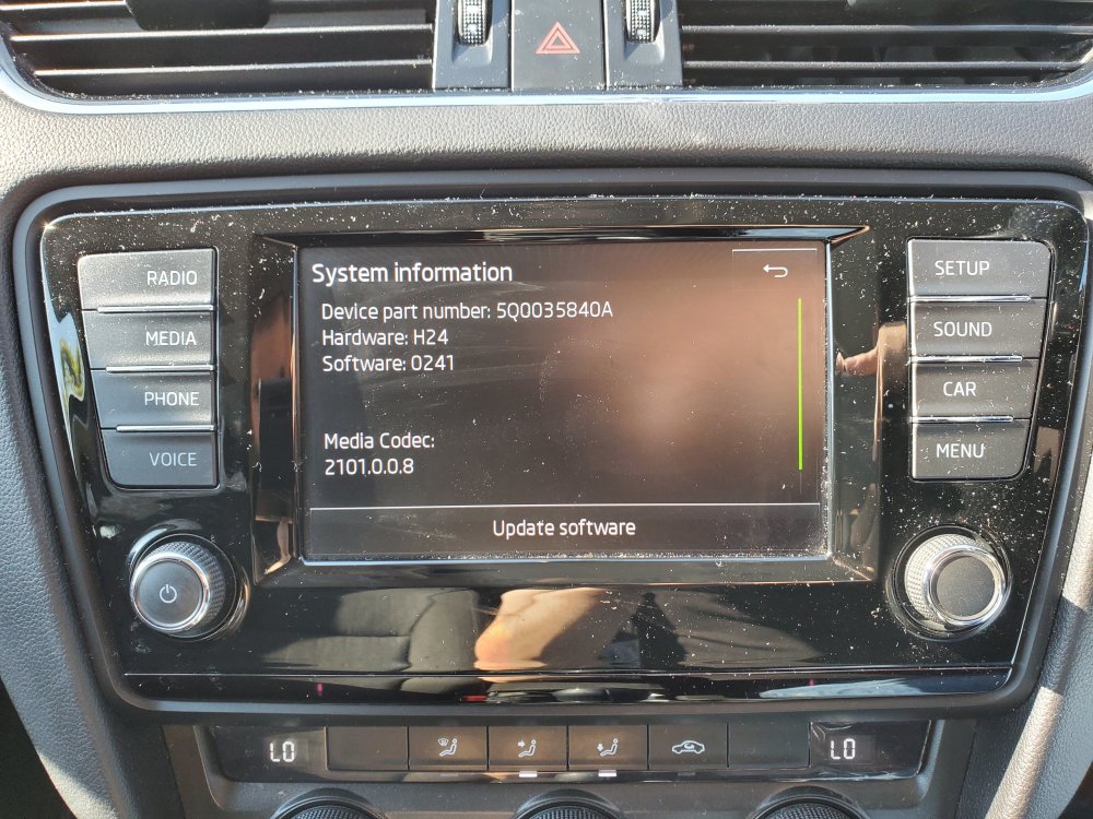

Do you know which model you have? I upgraded my screen - assuming it's an issue with your screen - for about £150 with a 2nd hand one from ebay. If you don't know which model, post a picture of the model number from the settings screen.
That sounds better. So you just took the touchscreen from another head?
Attached a picture here.

Screen does not need coding. Pretty sure that is an MIB2 bolero. Should be able to fit any MIB2 screen apart from the 9.2 Columbus screen. Just needs the VAG removal tools and maybe a tweak to the cable plug if the shape is off slightly. Common mod for this type of car.
If I got it wrong and you have MIB1 unit then you will need the matching screen which should be cheaper as it's older and less desirable.
A couple of hundred should see you done.
Be careful. The model number is the infotainment system, not the screen. You can see screen model number on the back of the unit in the photos. You could always remove yours to check the model number. The one in the link looks a slightly different shape. I'd stick with an Octavia one.
