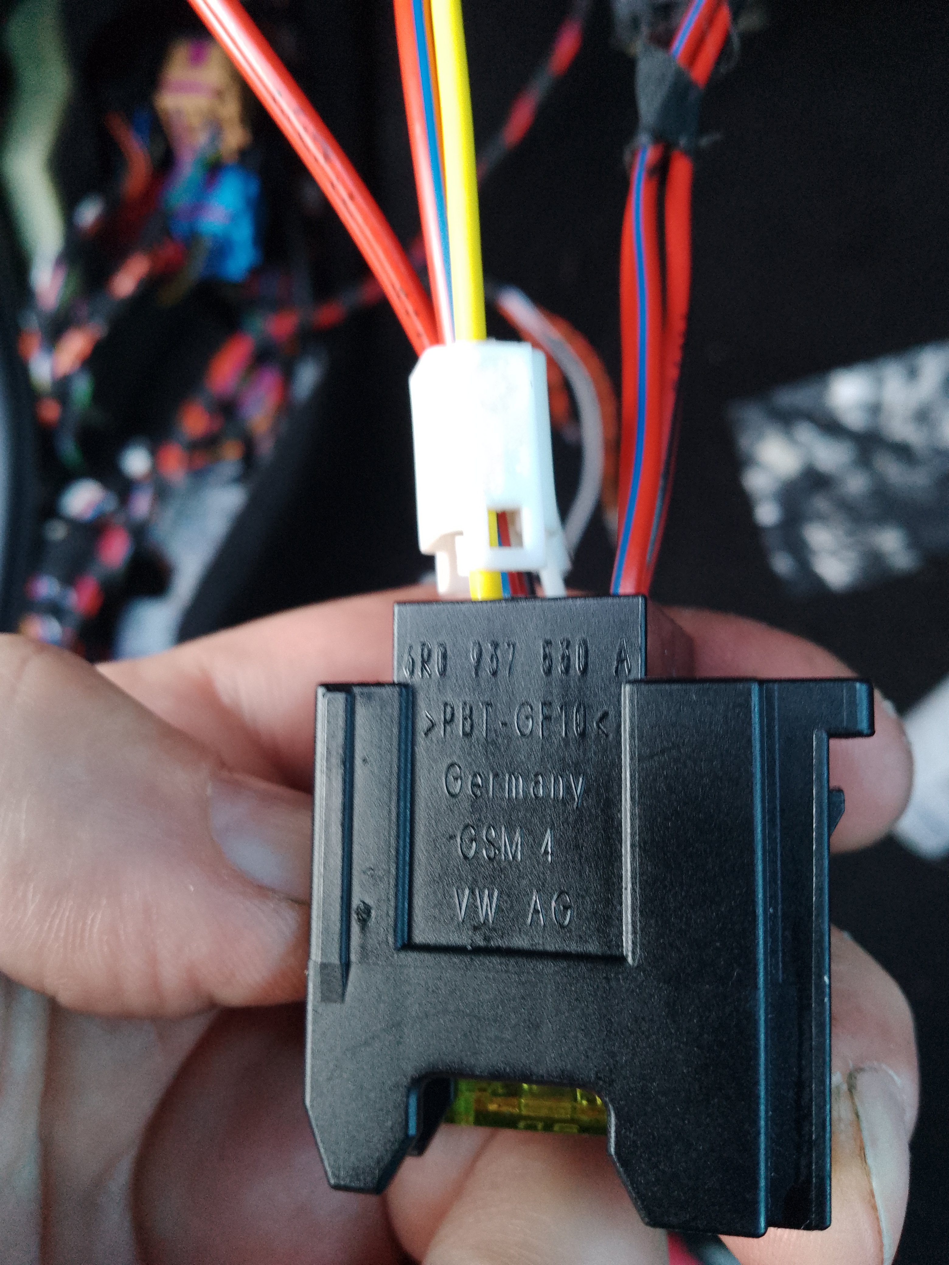

Towbar fitting help - help urgently please, can't get westfalia piggy back slotted into back of fusebox
help urgently please, can't get westfalia pinout cables piggy back slotted into back of fusebox
They are tight as hell to push in and won't just push in even, wondering if they actually have something needing removing from them or ideally a special tool to push them firmly in from rear.
They do seem to be caged in a surround but presuming this ( with springs) is part of the fitting.
Also I don't have existing fuses at F28 and F38, should there be fuses in front of the fusebox as well as in the accessory fusebox ? It only came with 3 fuses already in the accessory one.
I will donate £10 in beer funds to anyone who can give me successful advice please, otherwise I'm seeking an auto electrician to complete it annoyingly !
Still got the BCM to do yet also ! This sucks, it went reasonably well to this point, mousing the cables and plastics removed carefully etc.

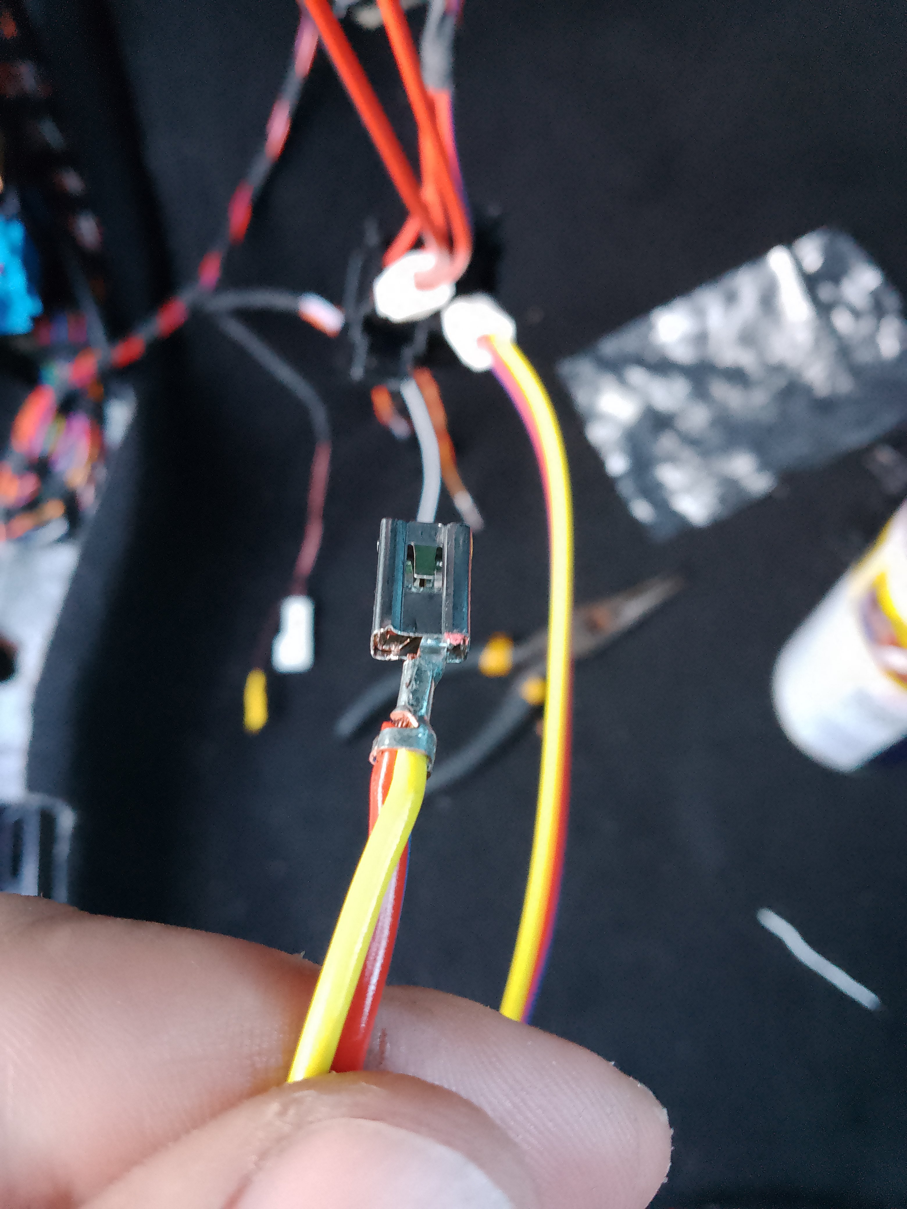

They are just so tight, they are not push fit or even with force down with a screwdriver
Its the pre-cabled extra fuse holder (6r0937530A)
Its the bit where you Clip snap tail wires into additional fuse box rear....they just are so tight they don't want to push in !
I got one about 3/4 down and just not fully seating.
and the other only just in or half way so I got it back out again before trying to force any further.

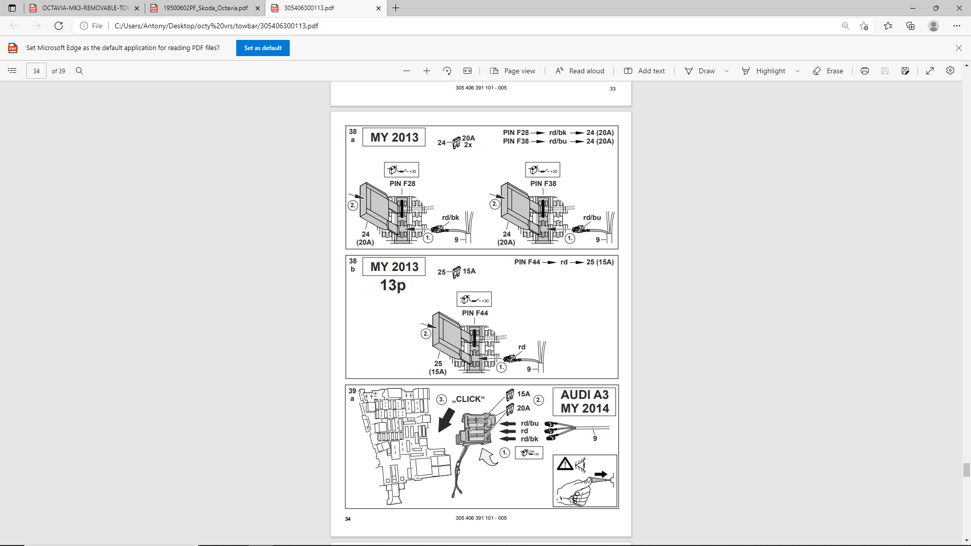

All sorted, a 2013/2014 car confusion lol.
In case anyone is ever wondering, the 2013 car ( up to around June) dont need the extra fuse harness but the 2014 cars do.....
They appear to have a totally different fusebox layout....I find reading these "instructions" difficult at best, what happened to written instruction.....
On my car ( for 13 socket lectrics) you need F28, 38 and 44 and pair the loom DIRECT.
DO NOT follow OCTAVIA-MK3-REMOVABLE-TOWBAR-FITTING-IMG-v1.0.pdf as this is seemingly for 2014 fuseboxes I was kind of getting in limbo between the guides and following that and should have stopped and focussed on original guide from scratch.
This explains the differences better, you don't pair them into the fusebox which is the mistake I made and now have to remove them lol.
I couldn't plug in those other wires as they are really meant for D122 / J126 for later 2014 on cars. I think the 3 tails I plugged into the fusebox extra, probably fit easily into the 2013 fusebox.
