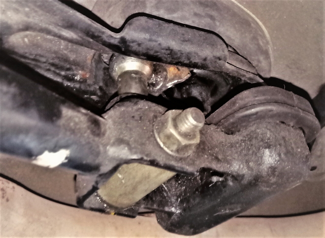

This is mine:
Those 2 O-rings are in place, the bolt is tightened, OK till this point.
Look higher the semi-sphere, is unbuttoned from the end of the rod, one push and is buttoned but since the inside metal ring is worned out after few weeks is poped out again.

The end of the rod was covered wirh grease (to be honest i don't know why) and i couldn't see more about it.
The ring is one, inside the ball cavity has only one groove, no space for 2 rings.

No26 is like sponge, never seen it before.
No27 is present, i saw it, has dropped down in the base of the T and it's not visible in my photos.
The ring and the slot inside the cavity are one, posted separetely in one e-shop photo maybe for informational purposes, here are two examples:
thumb?id=8942345&m=0&n=0&lng=en&ccf=9407
The No28 (the T) looks like bronze but i think is alloy with steel.
