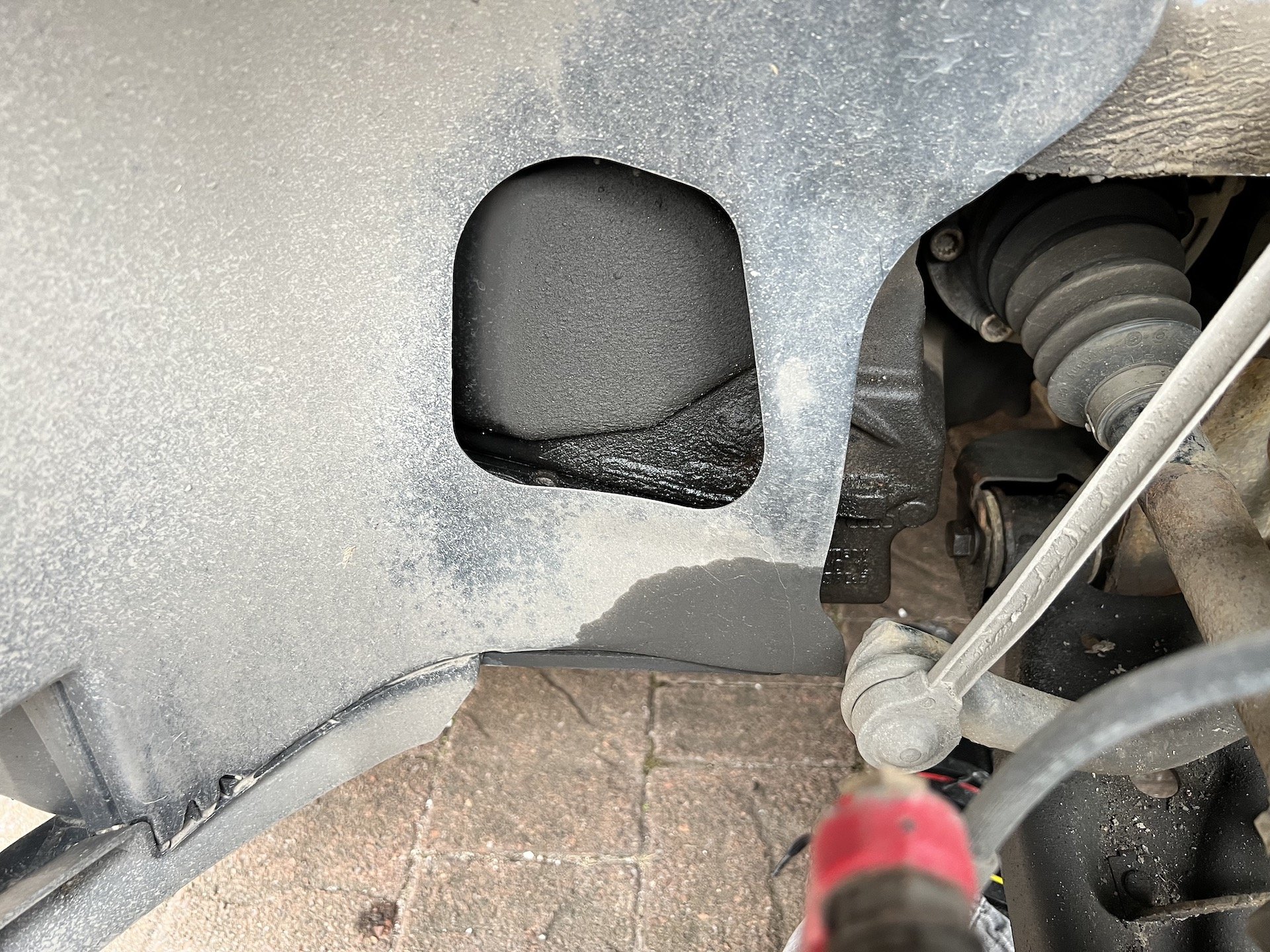

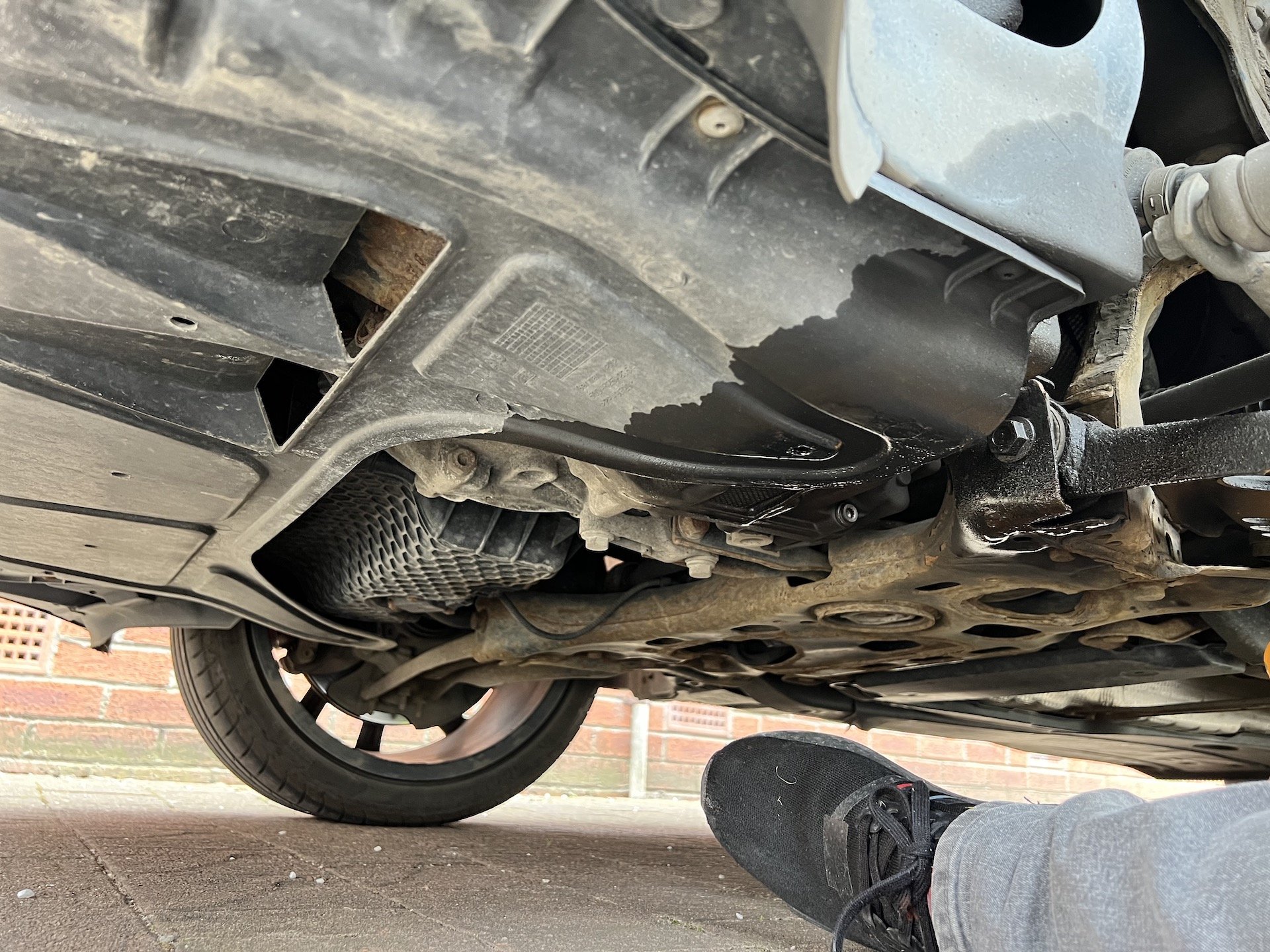

Looking for some advice from you knowledgeable members. I have discovered some sort or oil/fluid leak from I assume the DSG box. You can see the pictures attached. It's pretty wet under there, with it all on the suspensions arms and some fluid splashes on the wheel liner. I have checked from within the bonnet/engine bay and I cannot see anything.

The only sure way to find out is to get the undertray off and see where it coming from.
As @Ecomattsuggested, remove the undertray. Clean it well with brake cleaner and then dry it.
The other option is just go for DSG service as it's due and ask them to do the inspection for you. There is no point to change the DSG fluid if you have a leak.

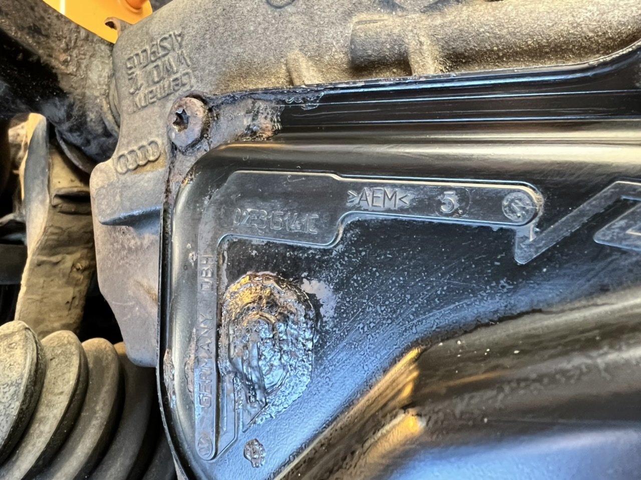

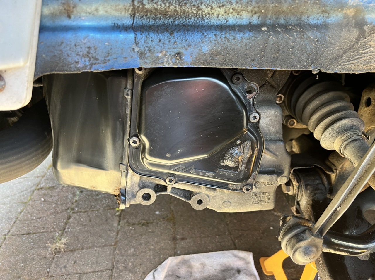

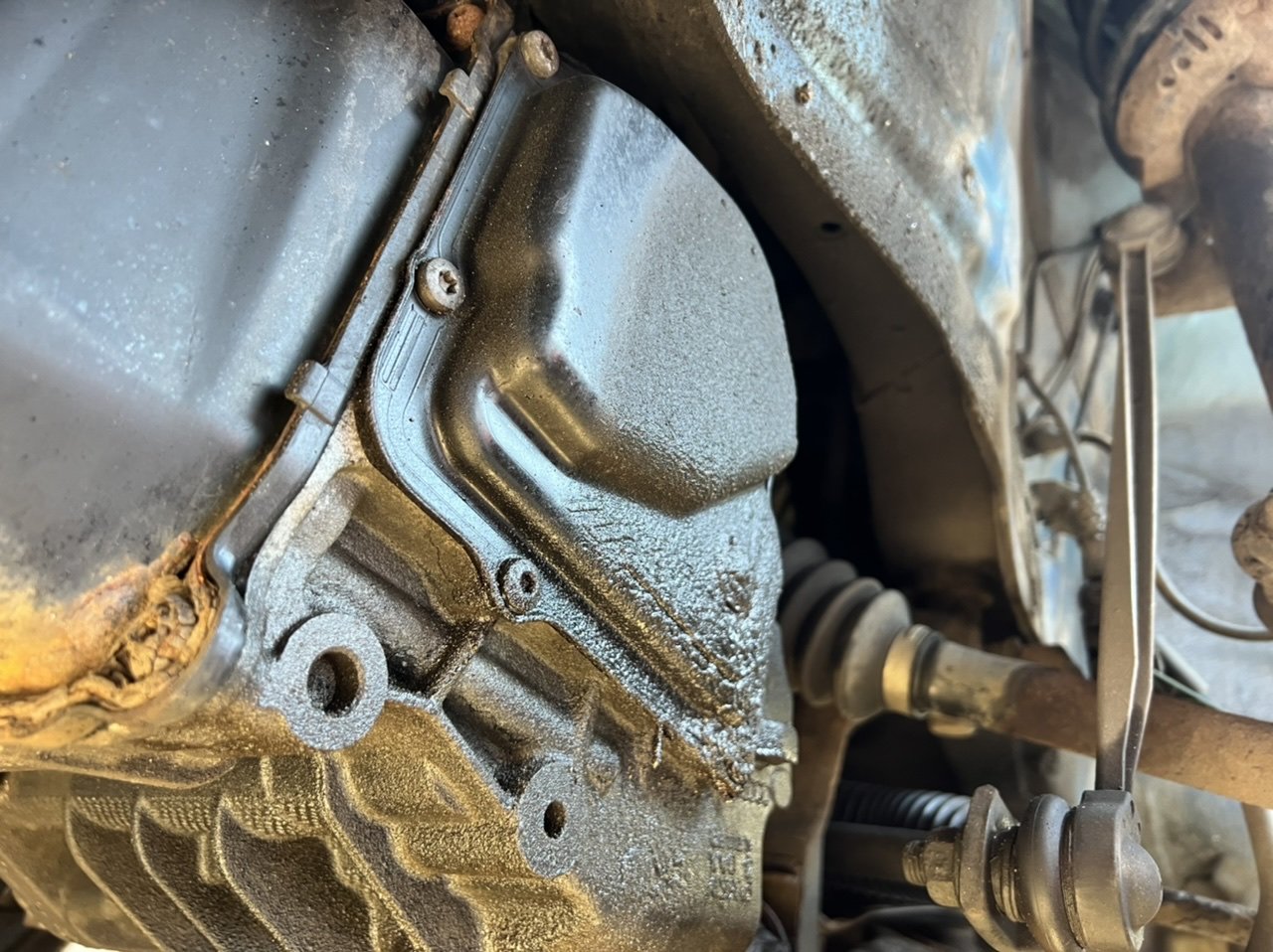

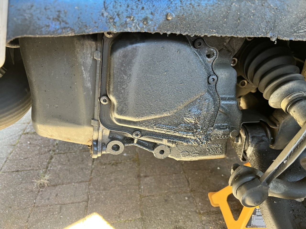

I’ve stripped the wheel arch lining out and under tray. Here is where the leak is coming from. It’s like a side box, can anyone identify this section of the box? I’ve cleaned it all up so will see if it further leaks and needs attention. Any advice appreciated.
Is that corrosion on the bottom corner of the cover plate nearest steering-arm ?
It was just a build up of oil and crap from the roads. All cleaned as above and its ok. Is that the part you mean? I found out the leak is coming from the oil pump cover.
There is corrosion on another part of the box cover but no oil was coming from it.
