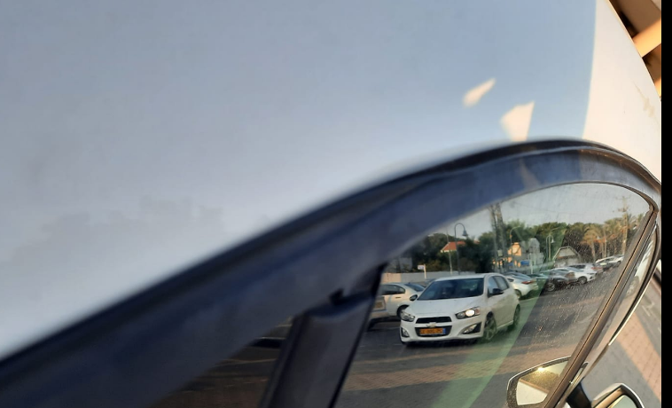

My rear left rubber window seal had worn out, is this something recognized by Skoda? (my car is out of warranty).
It looks like window is pushing the rubber and forcing it out of it's place, can this be fixed? or it must be replaced?, anyone can recommend on replacement steps ?
*attached a photo of the issue (this is not my car, but the issue is the same), i'll upload later today picture of my car
