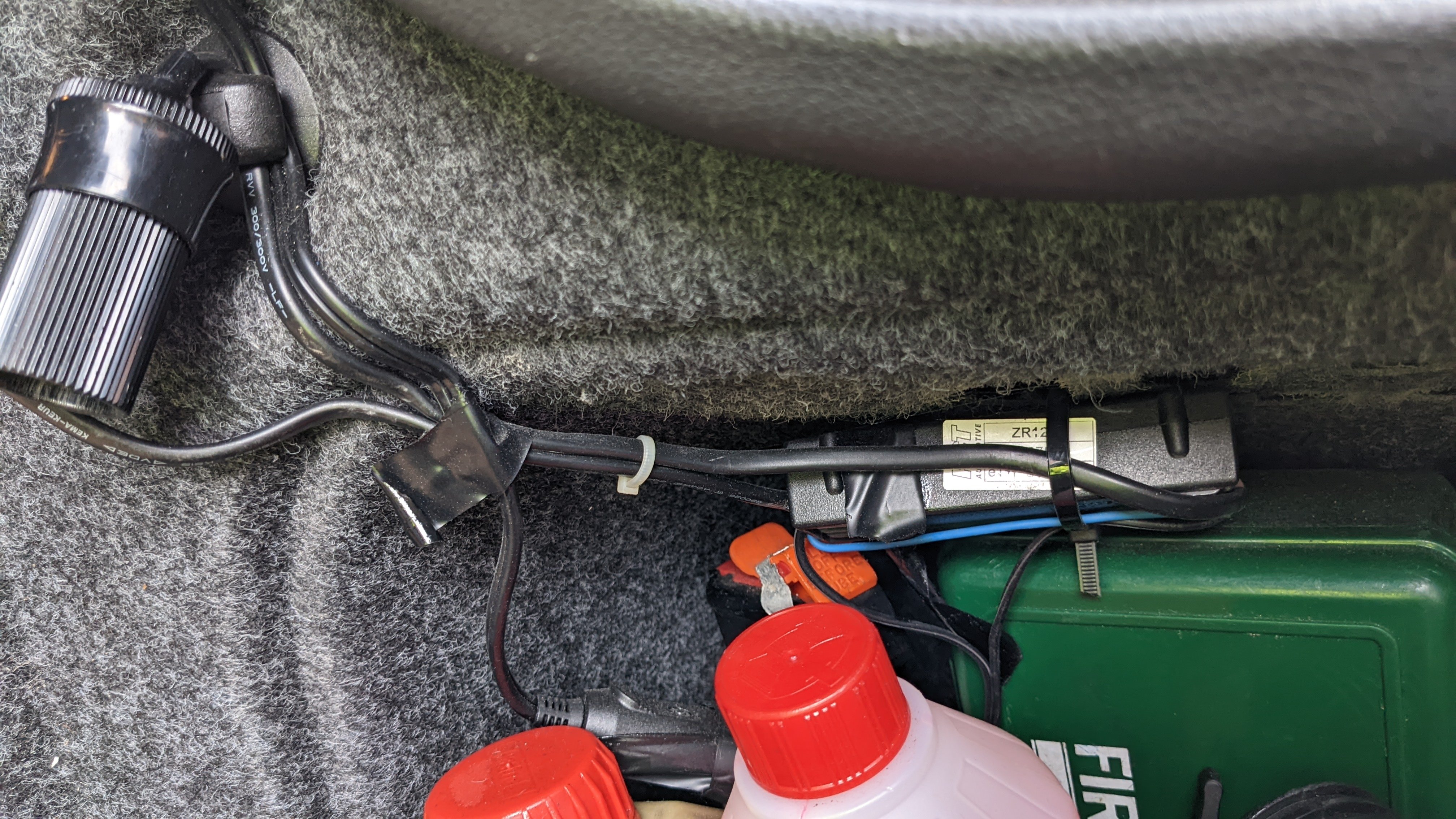

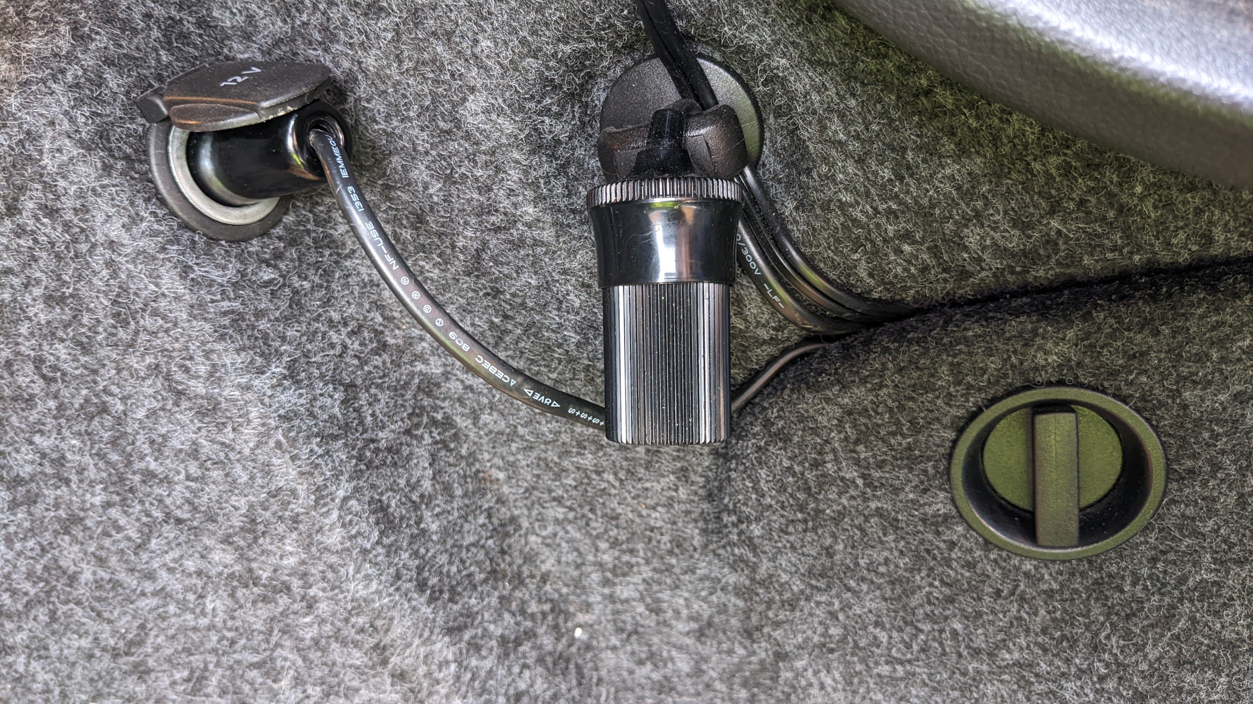

In my Superb I use a "PCT Volton Relay ZR1220" plugged into the boot 12v socket wired into an inline socket to run my cool box in the boot without flattening the battery.
[EDIT] https://www.just-tow.co.uk/product/volton-split-charge-relay/
Edited by bigjohn
