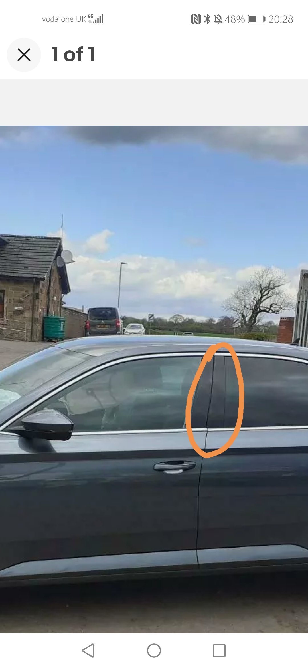

I'm looking at trying to replace the front drivers side rubber door seal as it keeps moving backwards and catching on the rear door.
I know I need to remove the door card and wing mirror but the seal goes behind a glossy bit of trim. Does anyone know how this would be held on and the best way of removing it please.

I think, open the front door, lift the rubber seal on the front edge and there are three screws to remove.
https://www.ebay.co.uk/itm/264569695629
that shows the screw locations.
Ah thanks for the reply. That's helpful. I was thinking it was going to be stuck or somthing.
