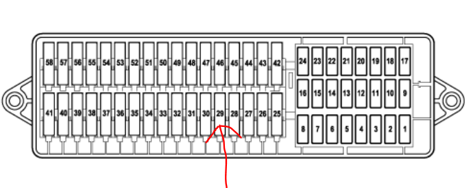

Hi Jason; have you checked fuses? Fuse 29  (10Amp rated) appears to be the one at  a quick glance.  Watch out for confusing fuse diagrams that may need mirroring or rotating to look like the one in your car.
Knowing what engine is in the car may help me to be more sure about that.

Are you getting any other fault codes flagged up ? as looking further at the wiring diagrams that fuse #29 also supplies the turbo control valve & the EGR valve so if that fuse has blown I would expect more fault codes to be shown ?
Where did you get the replacement pump from ? as there is very little in the circuit just the supply from fuse 29, a ground wire and a signal direct from the ECU

changed the fuse last night, havent had chance to clear the fault yet, but it seems as though there was a 5A fuse in 29 which the diagram says should have been 10A
cleared the fault light, it hasnt come instantly back which is promising! as before it was coming back instantly when i cleared it. fingers crossed it was a fuse error.
