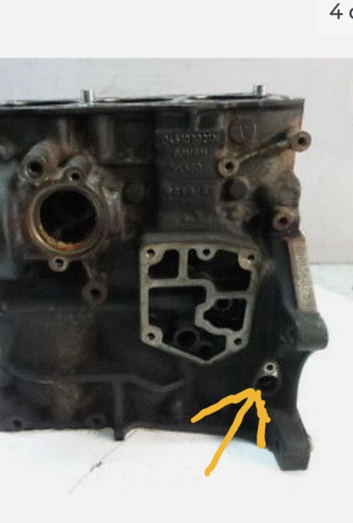

It looks like maybe it points at the crankshaft through this hole
According to Elsawn that is the location for the G28 crankshaft sensor 👍
