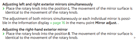

At least the old Octavia owners manual I have makes clear the expected behaviour:
As Pete mentioned, there are reasons for the mirrors to move together. Although I always thought the vertical was matched and the horizontal was reversed which makes sense to me at least...
Still - I'm not sure if this is related to the problem the OP is happening so lets see what they come back with 👍
