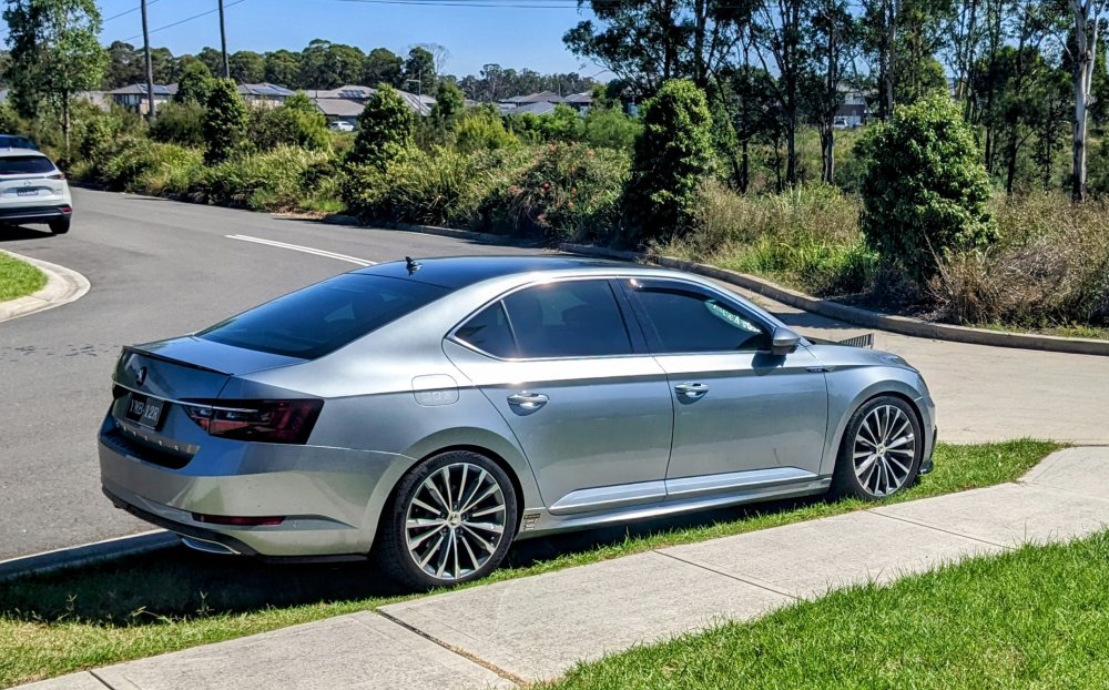

Not my pic obviously, but I ended up with 15mm spacers all round on 235/40/19 and zero rubbing issues.

When I had 235/40/19 tyres before, I had no rubbing/scrubbing issues with 15mm spacers front & rear.
My car is also lowered 20mm.
Now I have switched to 245/40/19 tyres - front was fine with the 15mm spacer, but the rear would scrub on full compression.
So I now have 10mm spacers at the back.
