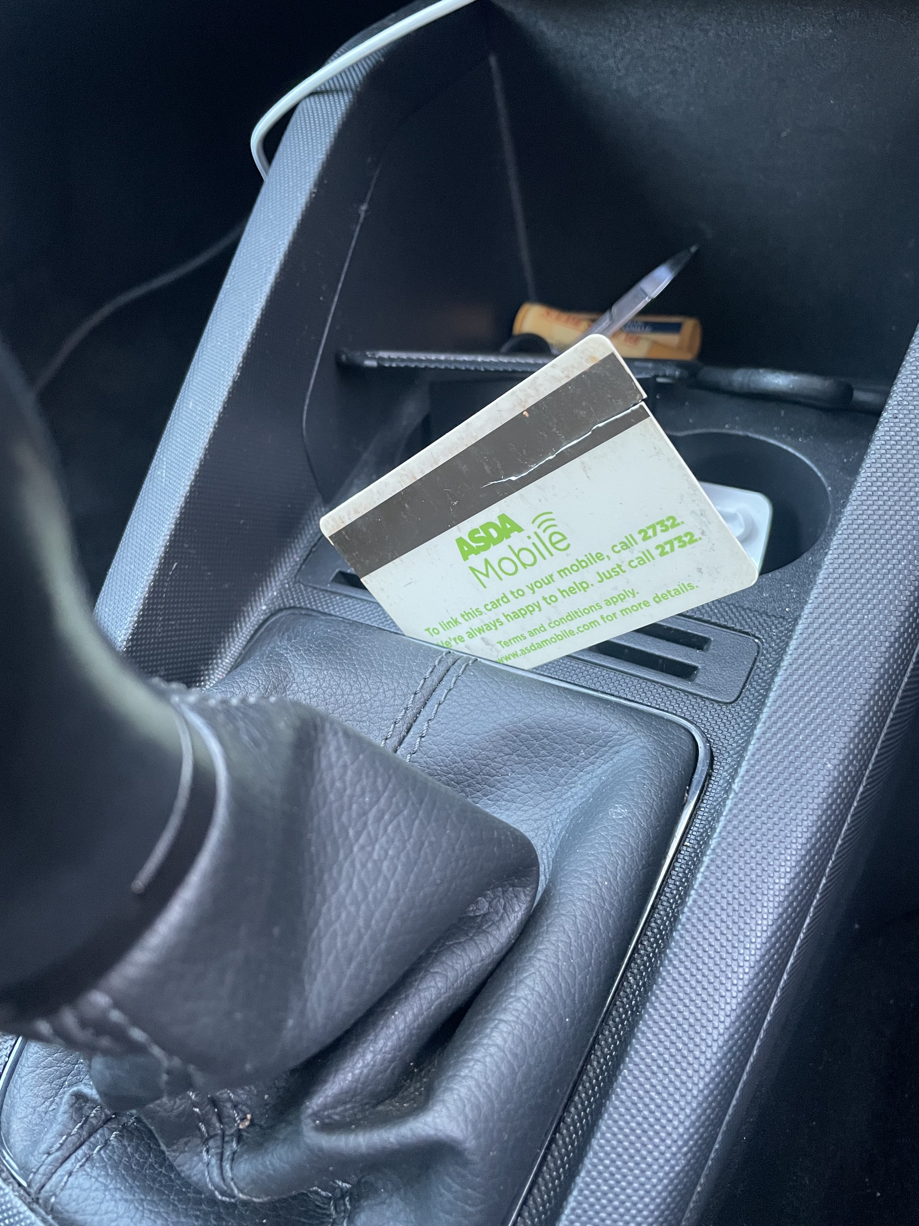

Hi I was struggling to access the gear lever locking pin as the on line vids etc did not seem to fit with what I could see.
On my daughters 2020 1.0 60 SE. I got some suggestions from other members and managed by 1. Working at the back edge 2. Inserting an old plastic card between the shiny trim and the centre console until it felt something. 3 sliding the card toward the left corner while pushing down on the card and gently pulling up on the gaiter. The corner clip just clicked and let go then it was easy to free the others.
Photo below if inserted card.
Hope someone finds this helpful.
