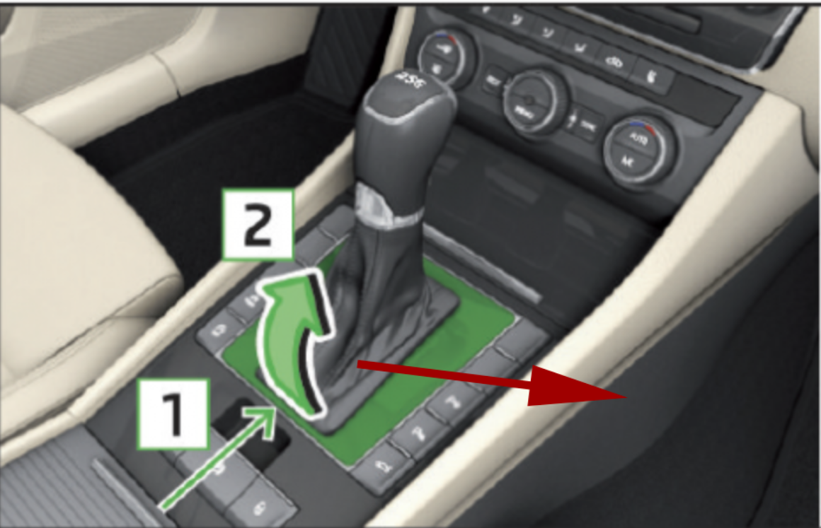

My mother this evening has lost my fathers debit card, it slipped down the back of the storage compartment in front of the DSG.
Had a quick google and I think it is a case of removing the side panel to try and get access.  See attached image, the panel being where the red line is pointing to.
Any thoughts / advice gratefully received.
Thanks
Paul
4 hours ago, pentaxian said:
Tis fairly easy to remove the black trim on the side.
On the far right, u'll c a small plastic cover (#1), that can b popped out using a small flathead screwdriver.
This will reveal a torx screw (#2) that u remove.
Once the screw is out, u simply slide and pull out the trim (#3) gradually.
