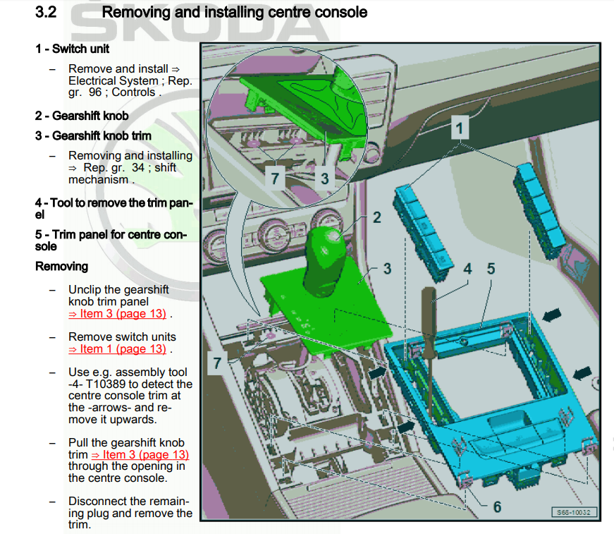

Not sure if this helps much...
Thanks mate, that was immensely helpful. Actually an easy job once you figure it out. The removal tool can be just a flat hook to pull on the locking tabs. Now the only thing missing is the sliding lid for the phone compartment 😁, but that one won't come out without removing parts o the upper center console, or so it seems. I'll just try to do it in place

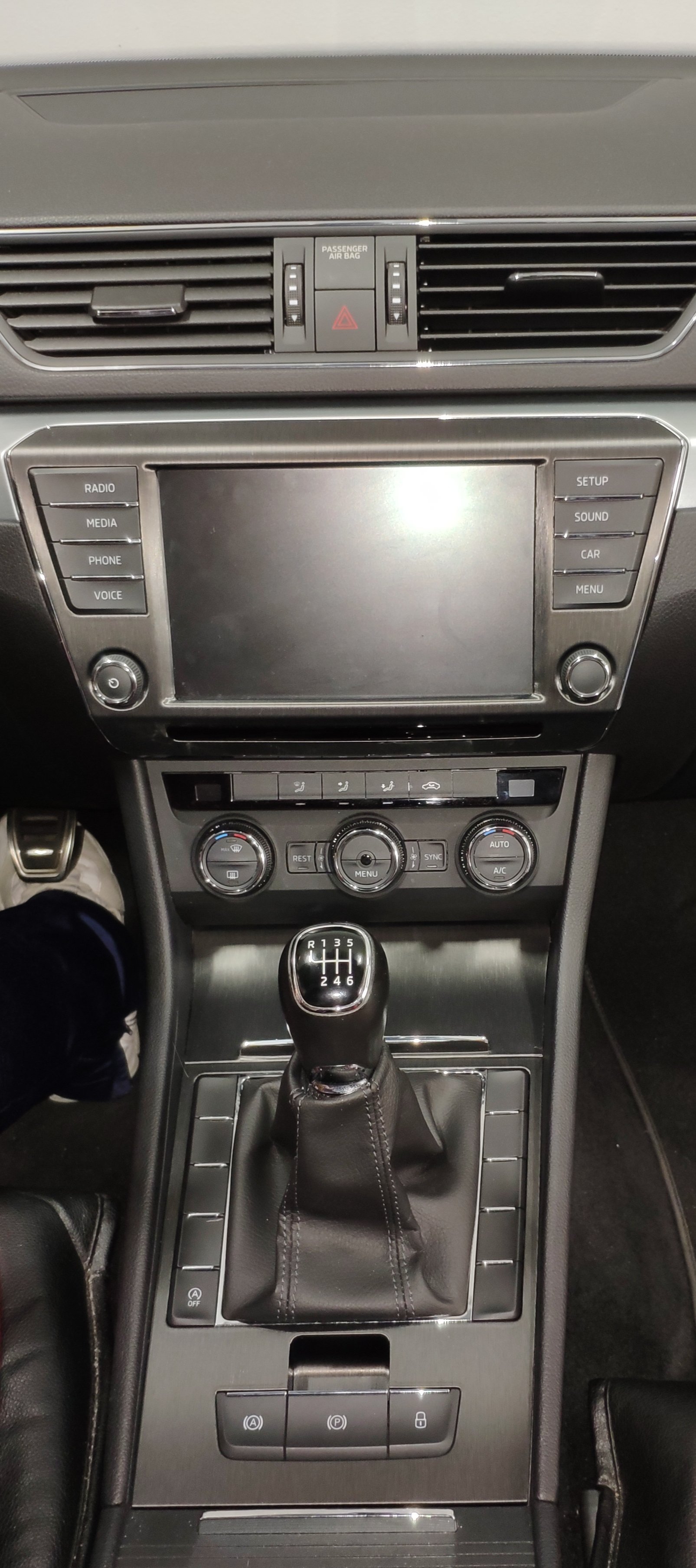

Here's how it looks now
Nice, that's how it should have come from the factory. Any surface you touch or is in a high traffic area should be matt and scratch resistant.
I assume you pulled from the front edge (toward the charge-pad area) first to get the main surround up?

Here's a couple of photos taken outside with better light. Somehow the camera can't capture the true color of the vinyl wrap, maybe because of the brushed effect. But it does look super good, I'm very pleased with how this turned out.
https://photos.app.goo.gl/7xKDGPom29kTjGPc6
Cheers!
Thanks for the pics. Good to know there is a future solution for the day when mine is a mess. What wrap did you use?

I need help, how to remove number 3 and then number 1 to connect Start Stop Off module?
Instruction is not detailed.
From where should I start, front, back, should I use some tool, should I pull it from inside, to grab with gaiter?
I'm sure you just pull the gaiter up and the clips let go quite easily...........not sure about how the switch banks are held in.
Switches are next step.
I tried pulling gaiter and surrounding together, but without success. Guess I have to try harder.
u don't need to remove the gaitor to remove the switch panels.
i have removed the switch panel myself as i also put in a start-stop module.
u need a trim removal tool to pry the front of the switch panel.  while jamming the top side, carefully pry the middle up - it should then pop out.

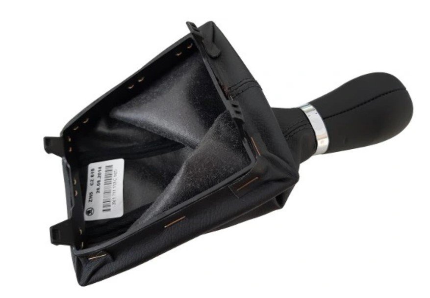

How did you manage to remove the stich gaiter/boot?
I tried to pry it up front and back between chrome frame and the leather but with no luck.
I'm afraid to use too much force not to break something.
Thank you @MartiniB.
But I need to remove just the leather part in manual.
It looks different than with an automatic transmission.
Hmm. Maybe I should to remove this shiny part first and then unhook the leather part from the bottom.
I'll try.
