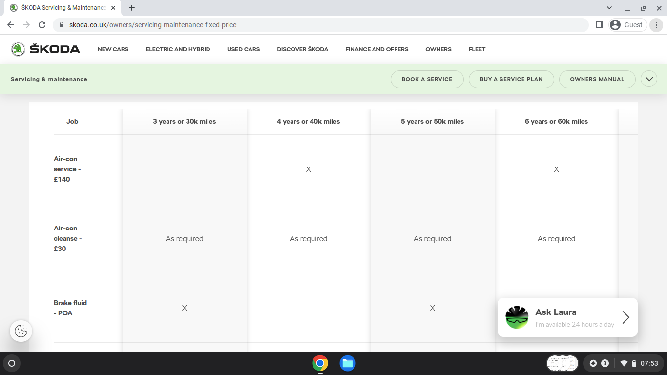

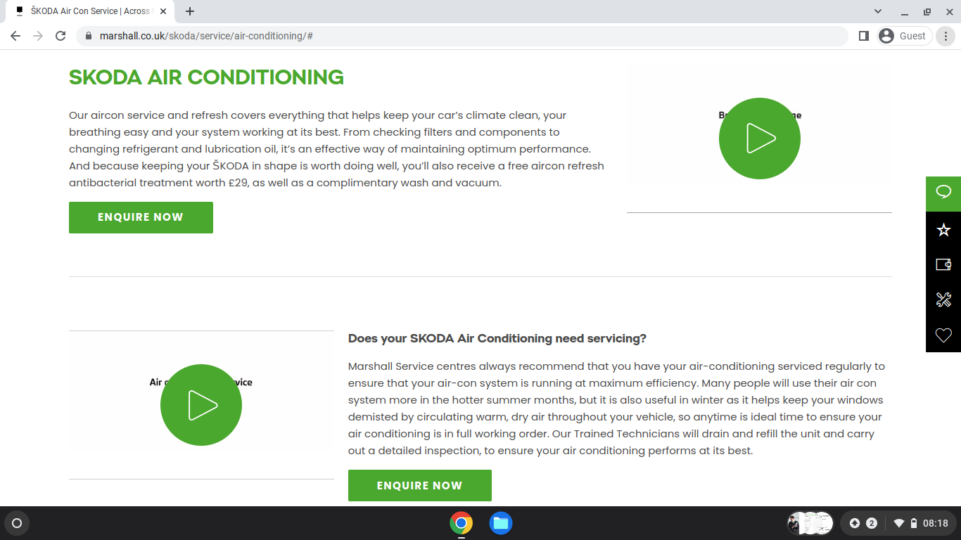

You are getting conflicting information because the Service Desk staff are just Upsellers.
A Service Plan, or a 3 or 4 year old Skoda Approved Used car with FMDSH might not have had a AC Service.
It is about Recommendations.

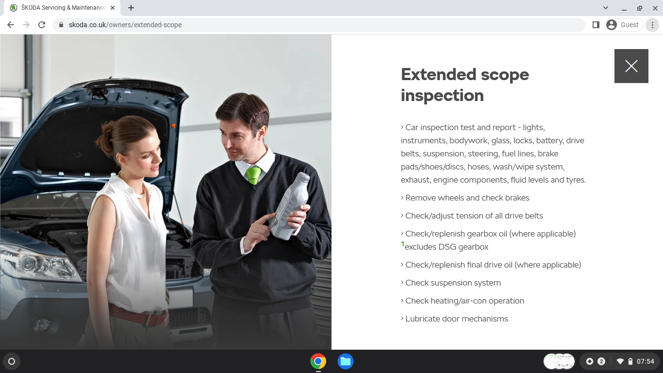

Supposedly the EXTENDED SCOPE part of the Oil & Inspection SErvice now checks the AC.     Take all Skoda stuff with a pinch of salt.
