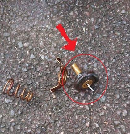

Does anyone have an original thermostat for 1.3mpi facelift felicia?
So like topic title says does any one have an original thermostat for the facelift felicia? 1.3mpi (the one that fails all the time)
Mine is starting to get slugish in operation.
I don't need the whole plastic body, just need the just the metal cylinder with the plunger (the bit that contains the wax and sits behind the spring)
This part:
Mabey one that the plastic body has broken on, but this part still works from.
Everyone here knows the issues with new ones not operating properly, thats why I am after an original one.
I know a lot of people will have thrown theres away, but I am hopeing there might be someone like me out there that keeps there removed parts even when they are broken.
