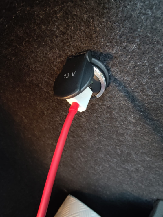

When I plug-in a charger (I have actually plugged in 3 different ones), it doesn't charge at all.
Is it a problem with a fuse (it has passed 2 major inspections in the last 12 months), or is this not really a charger at all?!

Yes that is a 12v socket. Have you checked the fuse as suggested by stuart56?
Also be very careful about small metal objects like that hair clip near the socket.
So, as suggested by @Stuart56, I checked the 12v socket in the boot as well (as shown by the attached photo, there should be a green LED light if the charger was working). That didn't work. So I'm assuming @langers2k was right, and the issue is the fuse.

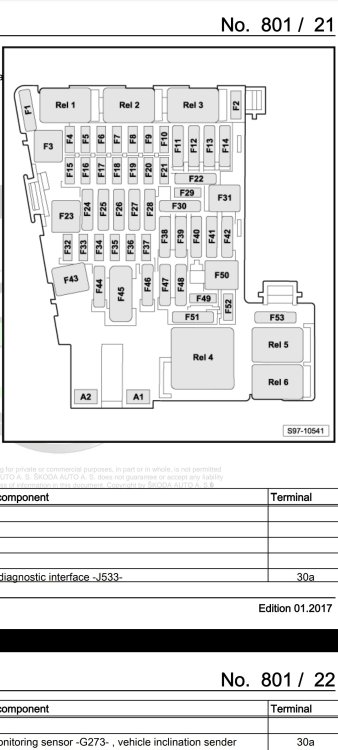

F40 as mentioned, and 30Amp fuse
Can be brought from local motor factor, should be plenty of places to buy.
Screenshot_2022-08-02-20-47-17-917_com.google.android_apps_docs.thumb.jpg.e9f71aa67a8fc18098d12aba689d191c.jpg

Slightly different method of removing the glovebox here as well where the guy explains a bit more in depth the process. This video helped me a lot when I was trying to hardwire a dashcam.
