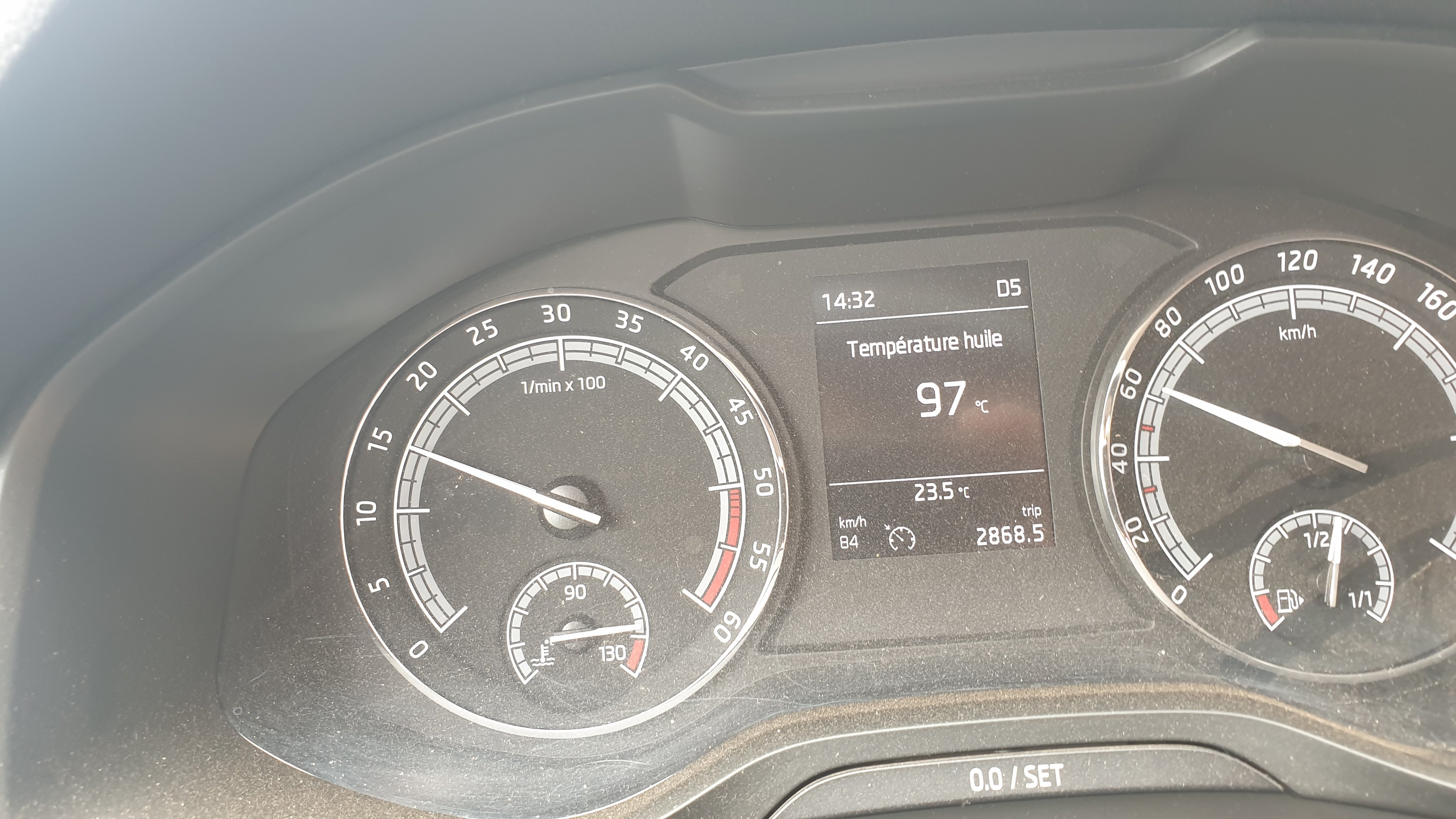

I recently purchased a used skoda kodiaq 2019.
I travelled to another city with a decent mountain roads and the temperature needle is going up to 120 but the oil temperature is bel 100 C.
The coolant level is at max.
Any help is much appreciated.
Where on the engine (or radiator) are the sensors in question? This may make a difference.

Yes it was a water pump issue.
I changed it and all good today.
