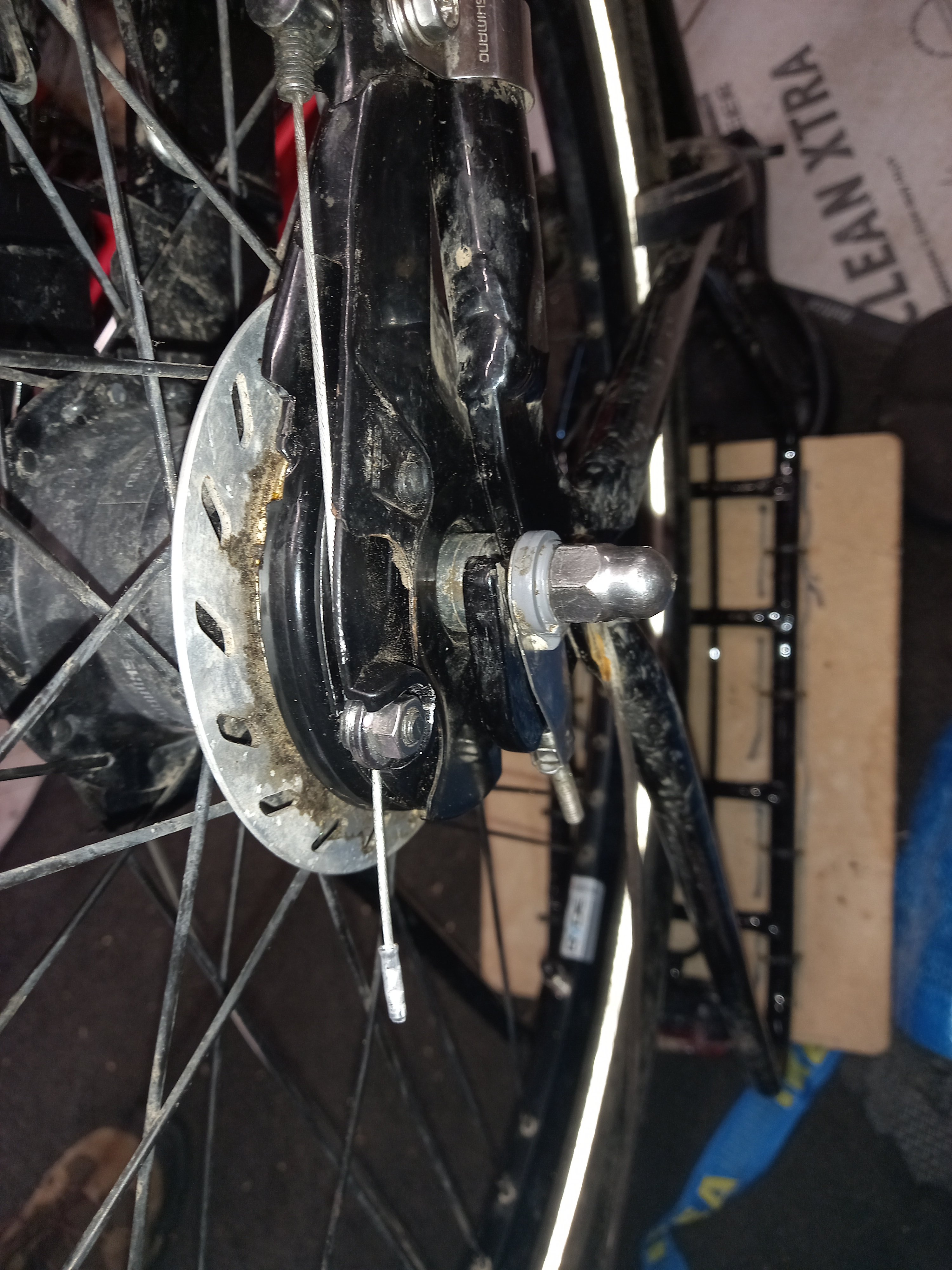

I was fixing a rear wheel puncture on my partner's bike yesterday, and opted to replace the inner tube rather than patch. This meant I had to remove the rear wheel, which was much more of a mission than I'm used to. It has hub brake of some sort on one side, which I did managed to disconnect the cable of, and this gearchange  thing on the chain/other side.

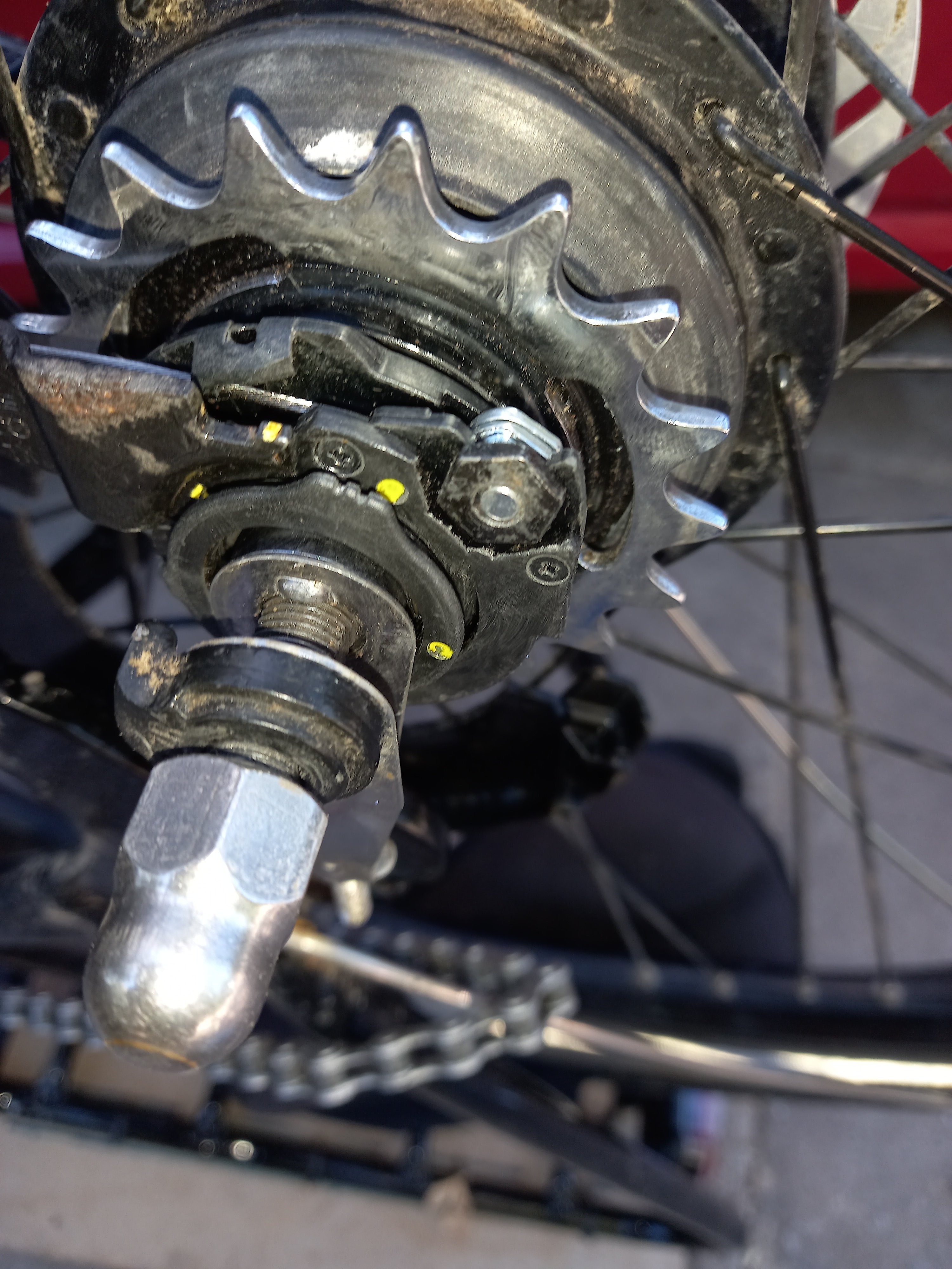

There was probably a way to disco the cable and leave it in place, but I thought I'd dive in and start undoing/removing the bits and pieces with the yellow markings on.  This went well in terms of disassembly...
...but had me close to tears when I went to try and refit it afterwards.  The image is with things just loosely in place, not locked in properly.  Had to put it away unfixed before it had me smashing things up! :mad:
Anyone got experience of this type of thing, or even know what the gear system is called, please?  It's a Dutch city-type bike I believe - won in a competition - haven't got the name of it on me, but can ask the missus to have a look in the shed if helpful.
