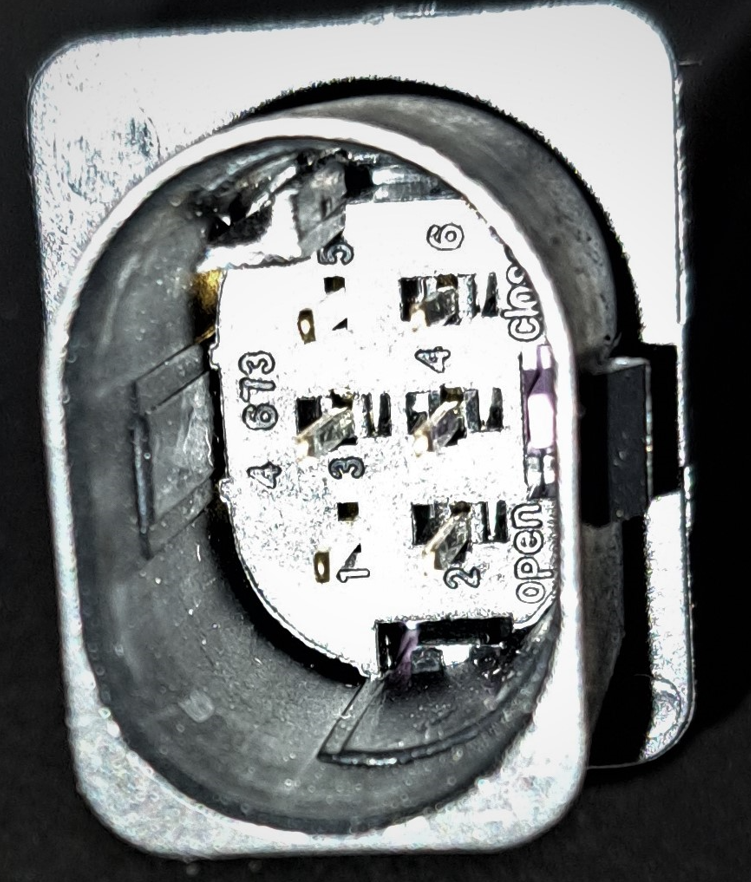

Sorry for late reply.  So bought a 5 wire O2 sensor from a well know aution site. The pinouts seem identical to those on the existing unit.
However it wont fit due to a plastic lug in the top left of the plug. (The skoda original plug does not have this).
Is it safe to remove this with a pair of snips?  The unit was advertised as suitable for a 2013 MK3 Skoda octavia.
Obiously i dont want to cause damage to the new sensor or the ECU.
