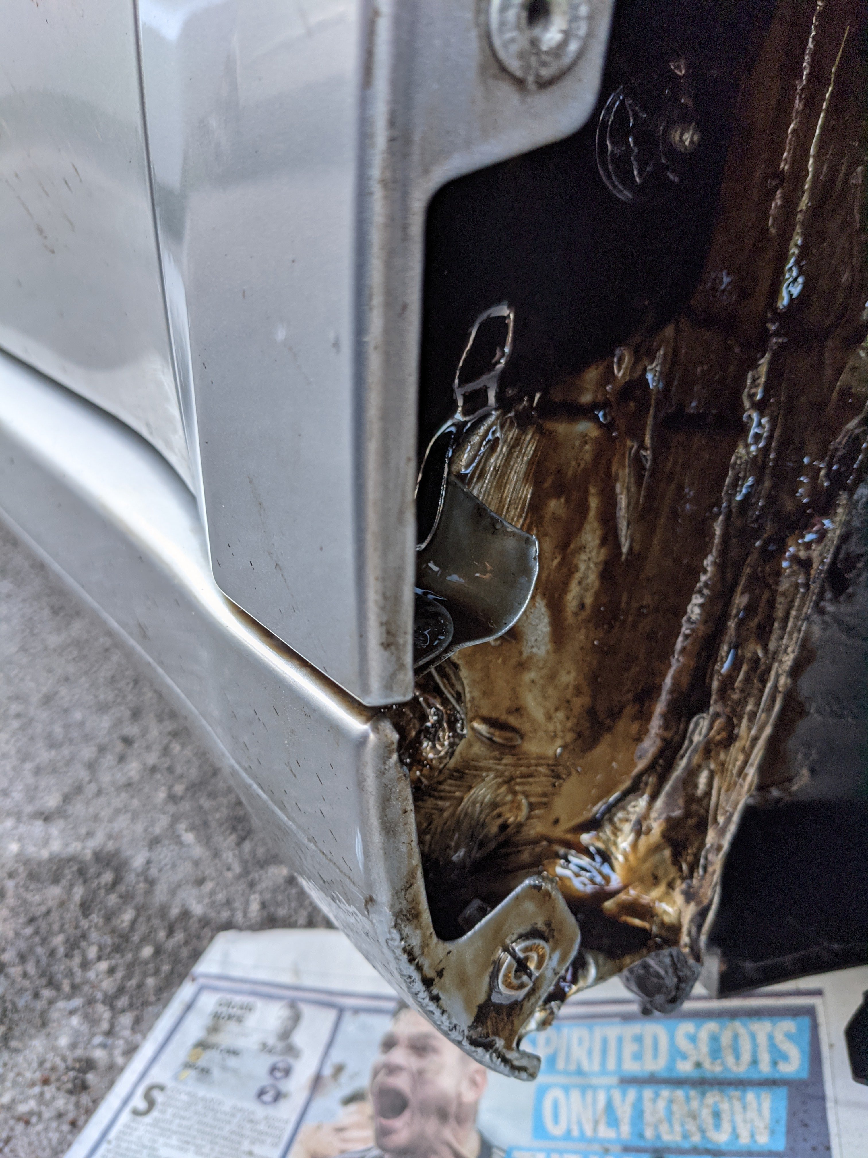

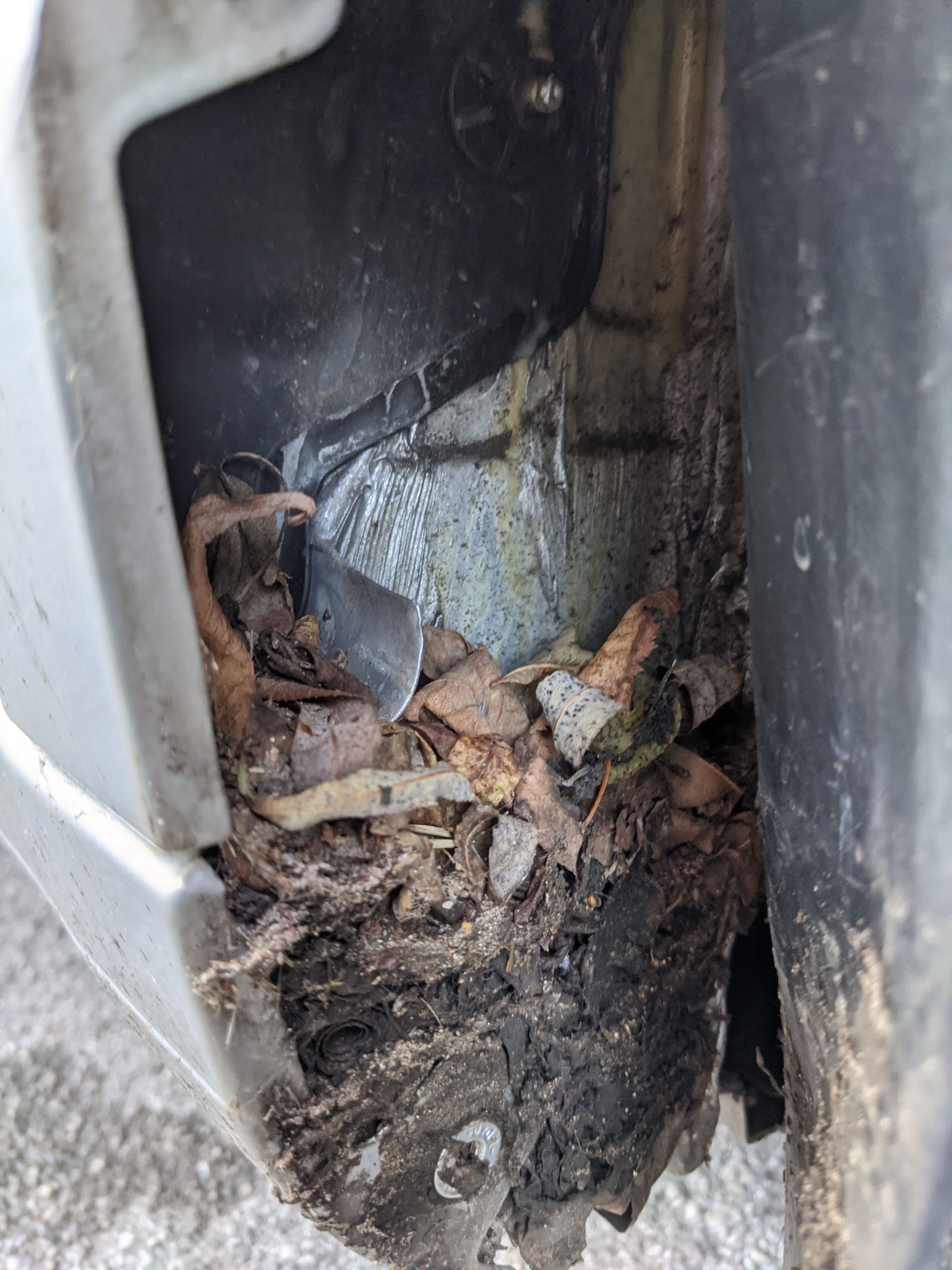

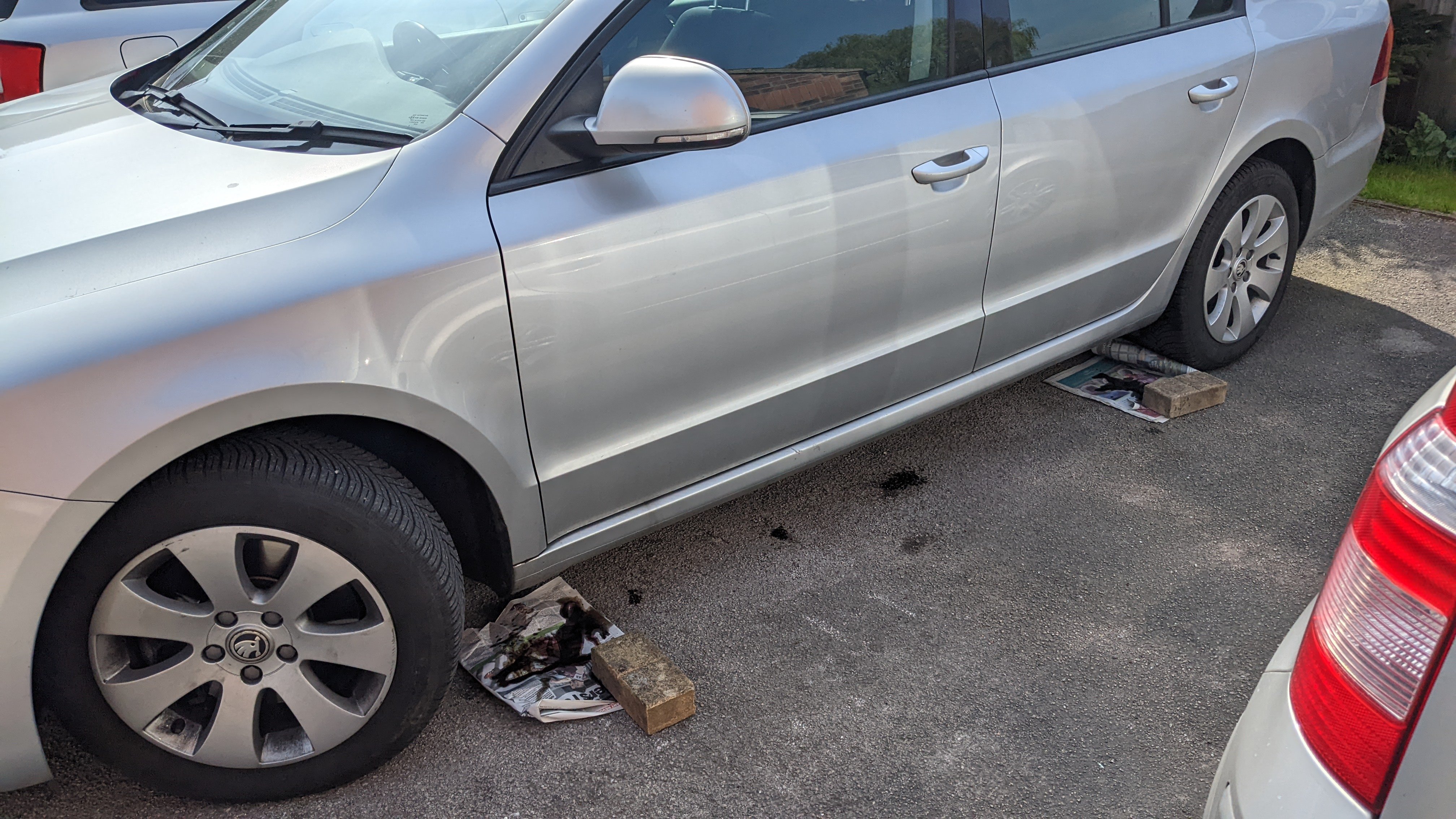

My car is slightly newer but has done over 100k miles however I'd suggest you undue a couple of screws on the wheel arch liner each side front/rear near the sills to see what's behind. There is a design flaw especially on the front that traps all sorts of carp. Easy to clean out and rust proof but if left then eventually it would rot out.
It's also worth finding the drain channel at low level entering the sill front/rear and checking if clear, one of mine wasn't! I used a thin knitting needle to insert. I also squirted Dinitrol deep into the sills front/rear.
All the above jobs are quick and easy - if not a bit messy!
Photos before/after + rust proofing sills:-

Thanks that is extremely helpful and I am hands on for that sort of work. I will get around to doing that sooner rather than later.  I've got Kurust gel in the garage and some Hammerite paint in silver to seal any bare metal as well.

Myself - I love Owatrol oil (Rust inhibitor) that sets to a kind of resin finish. Seems to handle road spray very well - and you can see through it afterwards to keep an eye on it.
Inside sections/sills/door bottoms, bonnet front, boot edge I use Dinitrol.

Both sides were rather full of leaves, dirt and road dust. Cleared them out. Both sides had rubber plugs on the sills which were in good condition and holding up.  I sprayed it out with ACF50 for now.  Will use some Owatrol etc when I get some in or a bitumen spray.

Hmm, sound like that's a difference between the facelift and pre facelift models. Mine has no sill rubber bungs. There is a small drain channel at the front and rear of each sill ie at the bottom of all that rubbish!! I got the Dinitrol flowing - probably a little too much and didn't wait long enough as some flowed out as I set off.
The reason I first checked is I walked past a very early mkII (2008?) a while ago that had rusting sills at the front - and I've got a bit more time on my hands these days!! A friend of mine has a Golf (circa 2010?) that had the same design issue but even worse - VW put in extra foam bits around the wheelarch I think are for extra soundproofing which were soaked through with water(Rust will love that!).
PS - I don't recommend bitumen spray on its own. I found things can rust underneath the bitumen and track along - almost makes it worse! - and you can't see it until it's too late. I did have success with Waxoyl underseal if pre painted with clean engine oil the day before (at least) - and yes it does cover but makes a right royal mess - but it works. A few years ago I re visited a Morris 1000 I'd restored in 1988 and the oil/Waxoyl underseal was still tacky and made your hands mucky if you touched it.  Not bad for over 3 decades ago. I'd also blatted a mix of hot clean oil/Waxoyl into cavities. All was rust free except for the bottom of the boot lid - which had been perfect at the time of restoration(should have rustproofed at the time!).  Again I found Waxoyl on its own kind of sat on top of layered rust, ok if metal in good condition - mixed with oil it soaks in nicely. Dinitrol seems to soak in /protect straight out of the tin - so these days that's what I use internally and obviously Owatrol Oil if exposed to the elements - which that part you've photographed is. It's a design flaw in that everything from the plenum above drains through that area and any solid-ish bits are trapped.
