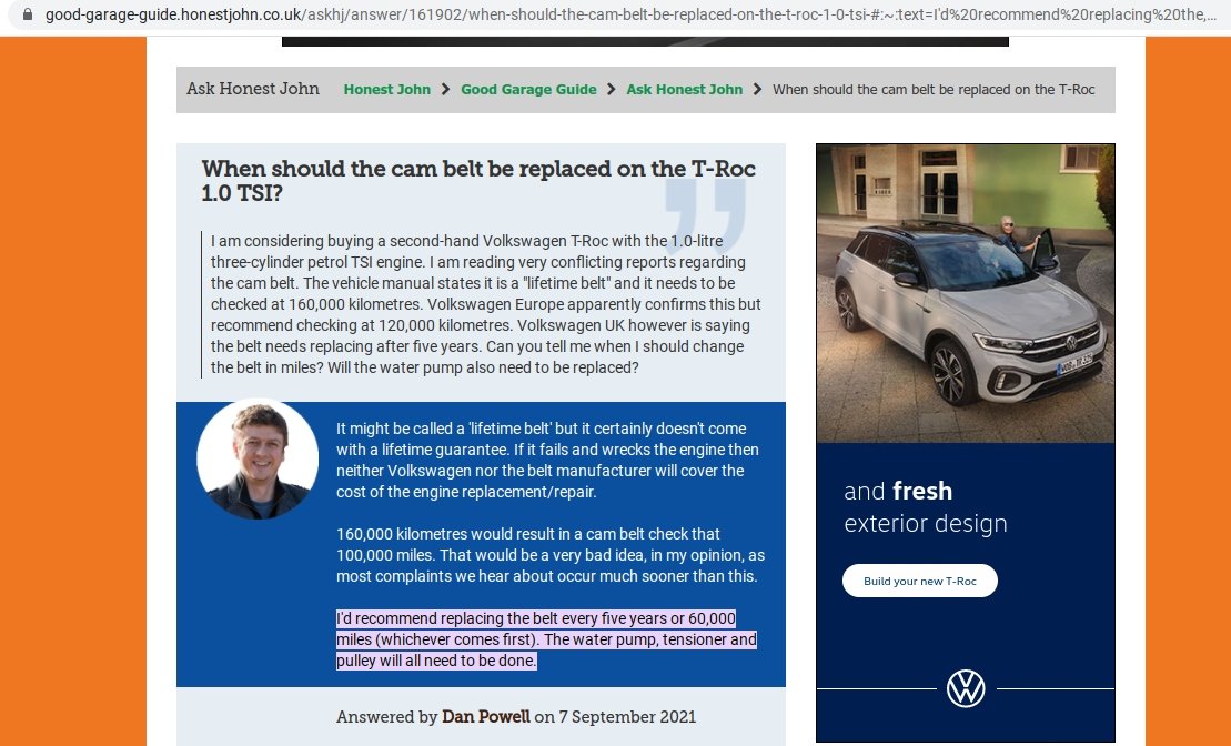

Maybe @varooomor @ApertureSknow or someone will check on 'erWin'.
*Whoever does it will not only need all the gear, but more than just ideas.*
http://www.mechanexpert.com/timing-belt-replacement-on-mk7-golf-1-0-tsi
Edited by roottoot
Skoda dealer is saying replace the belt at 5 years (will have about 25,000 miles on by then.  So am I right in saying that the water pump doesn't need to be changed at the same time as it is on the other side of the 1.0TSI petrol engine than the cam belt?
