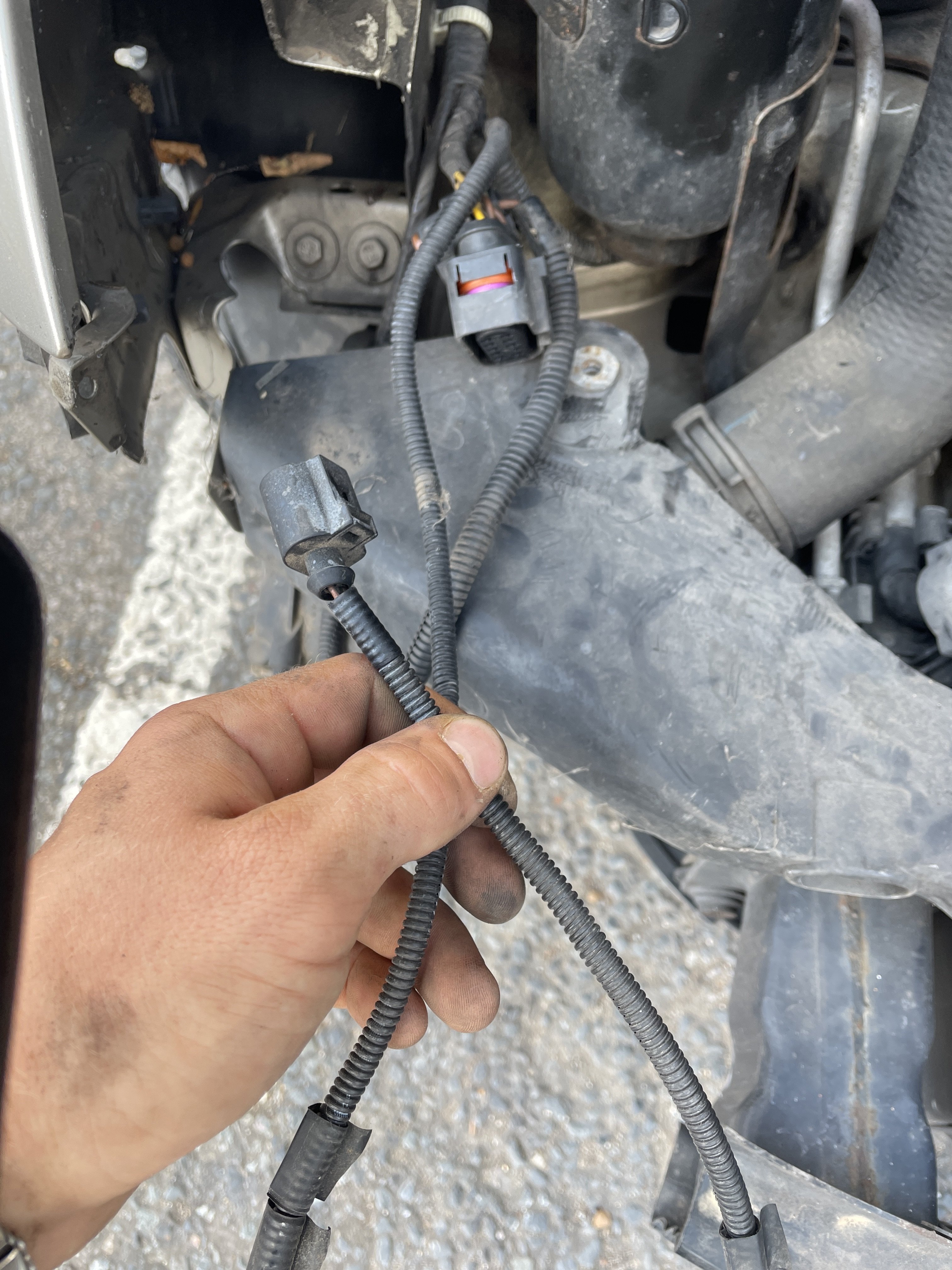

Unknown wire?
Where does this wire go to that I’m holding I saw it hanging from the front one day and can’t find where it goes ?? Any help would be appreciated
At a guess it plugs into that female connector just in front of your hand I the picture.
That's the headlight, I reckon it's for the front foglight in the bumper...
No, Unfortunately that is the wire for the headlight
The fog light wire is below my hand
Air temperature sensor?
How many pins are in the end...   Its hard to tell number and size from looking at the back of the plug
That looks a good shout if two wires and one yellow and blue and one yellow and brown.
The sensor itself is usually plugged into a hole in the grille next to the fog light or nearby

Brown/white and brown/yellow for G17 ambient temp sensor on a 2005 Fabia.
No that’s on the other side.
2
The only othe thing I can think of them is the bonnet latch switch if it has one that would indicate the bonnet open for the dash telltale or alarm??  After that I'm struggling unless it's an A/C sensor???
Good ideas, I need to see another Fabia to follow the wire on it?
If you look down the back of the slam panel below the latch mechanism you might be ae to see the other end where the connection fits if it is the bonnet latch switch.
