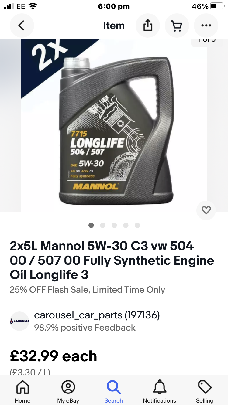

84C95F9C-ECD9-42E4-8E8E-AA45211A45DD.thumb.png.164c95bd2d085efce61da98fe6a1e26f.pngwould something like this be ok ??
oil brand any good ?? It will be serviced twice a year regardless of mileage,, or should I stick to castrol, millers etc never really put cheap oil in me cars but if this stuff is correct I’ll try it
Yes.
No need to pay that much though.
Often Super Markets are using it to beat other super markets in a Price Match.
From personal experience I would avoid Asda oil.

Ahh lovely mate 4.3litres of oil in the CEGA engine so only need a 5 ltr tub

I  normally get 20 litre drums of Fuchs, Castrol or 5 litres of Quantum.
The links for Mannol are a good price. I have never used it. Is Mannol any good?
Not sure mate I’ve never used it either. But I went for the petronas in the end
@FatblokeVRS
It's currently in my car!
It's a reputable brand and their other products are good so I've no cause for concern.
