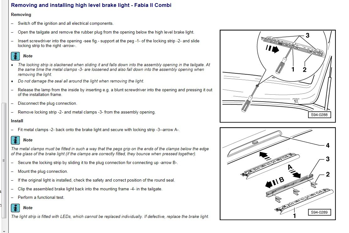

part number is
5J9945097
it has a seperate "holder" which the spring clips hold it into, I think it has to be unlocked......
I don't think the lens is supposed to seperate, it's the bond / glue between the lens and body of the lamp which has probably failed allowing moisture ingress and subsequently lamp failure.
removal procedure below..........

it tells you above its LED...........to be honest, for about £50, why mess about, just fit a new one.
