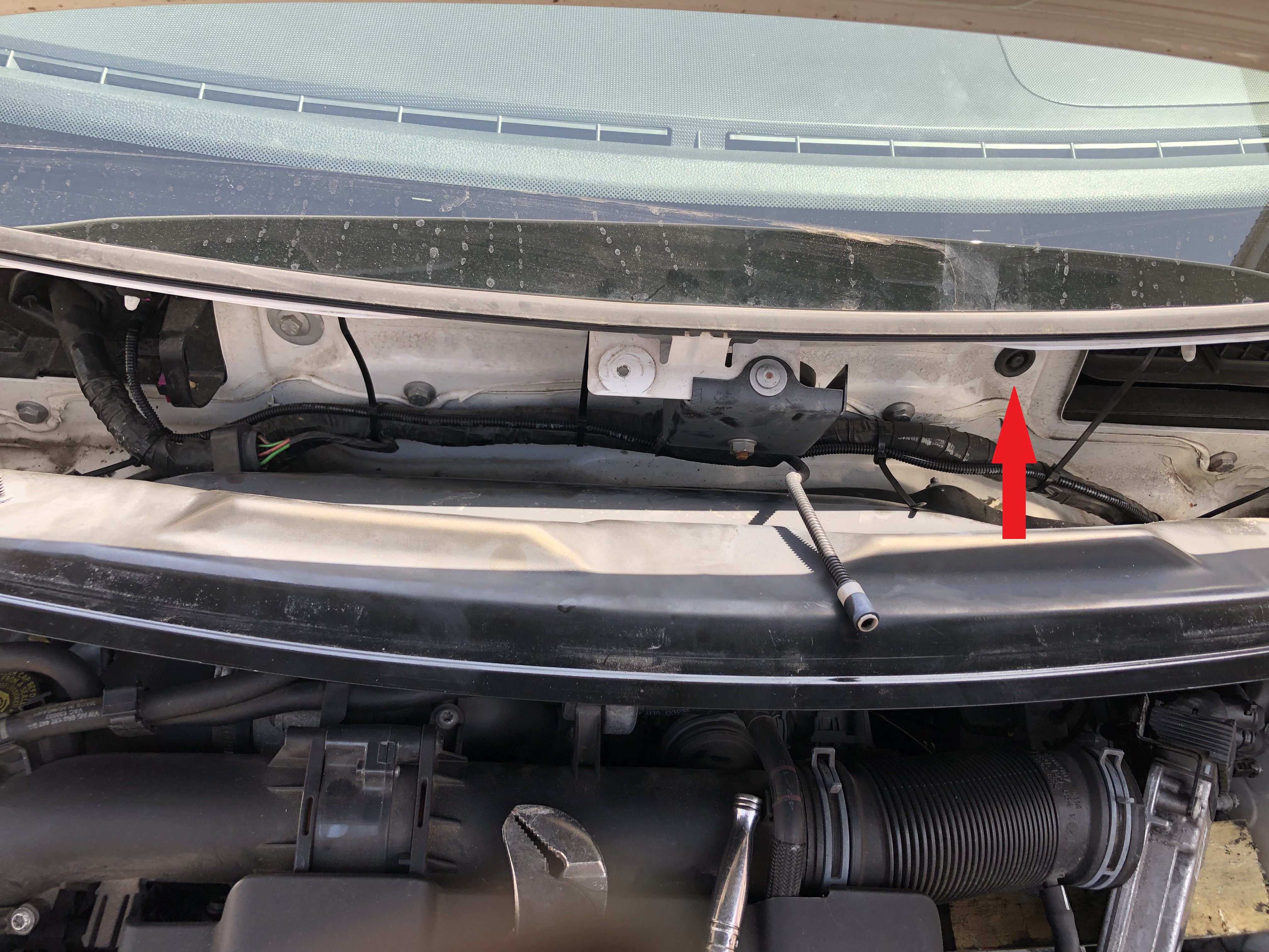

You need to remove the wipers and scuttle panel, then you can see the view attached. I have arrowed a "potential" entry into the left side of the cabin but you would need to locate it up under the dash to ensure you can access the other side.

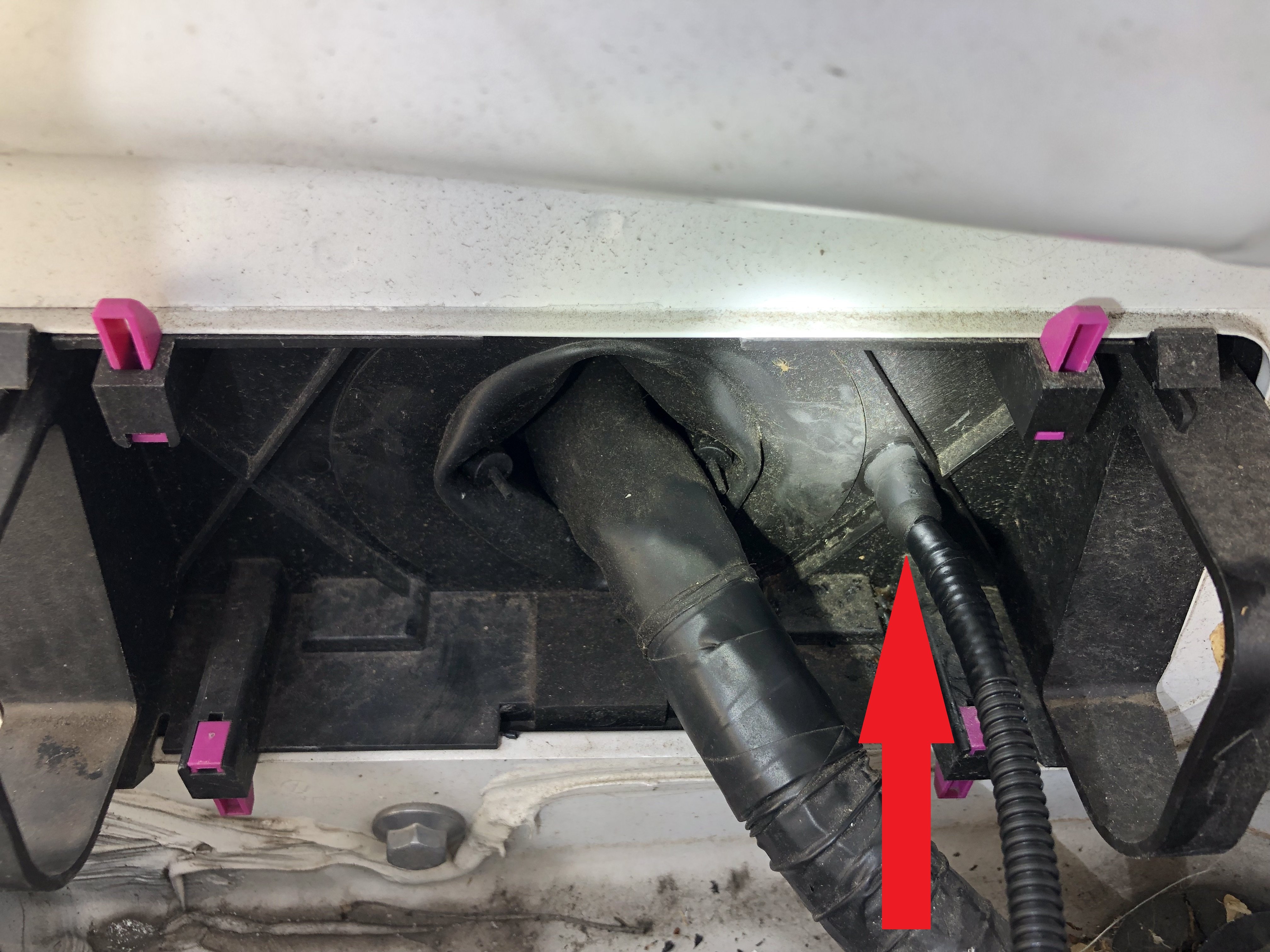

If thats not accessible, then on the drivers side, there is the main electrical loom entry, you can access this by looking up above the pedals on the drivers side, you can see "arrowed" where I went in with the factory cruise control kit.

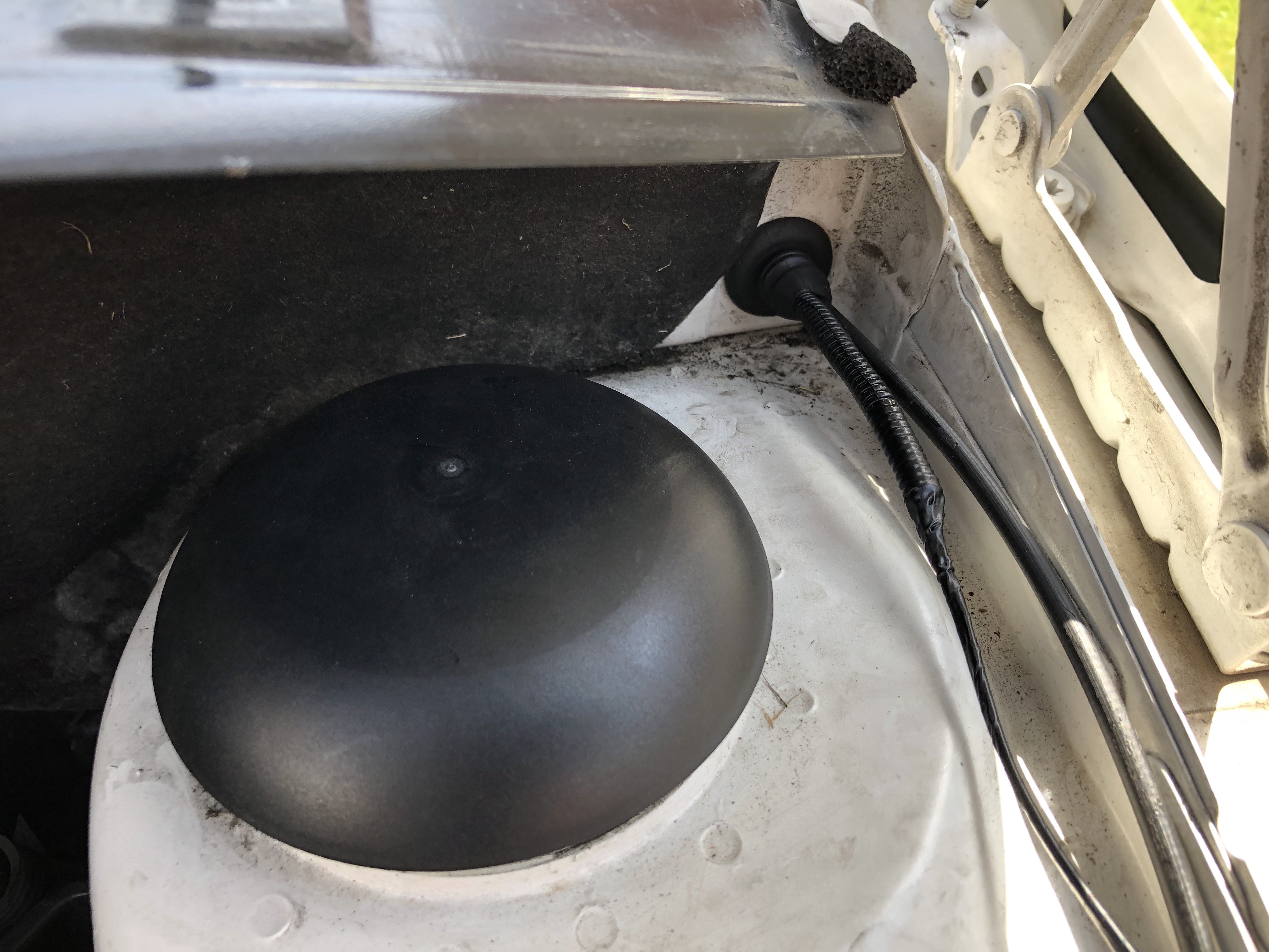

Using both scenarios you would need to get through the engine firewall first, that can be done through the bonnet release cable exisiting grommet (if your new cable fits) or drill a hole near to where is is.

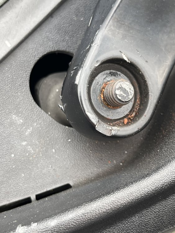

Hi there.I'm following petes advice to go through the grommet near the windscreen wipers. As usual I've hit a problem. I can't get the freaking wiper arms off! Are these things welded on? 😂
I haven't got fancy removal devices at hand either. Just a couple of spanners.

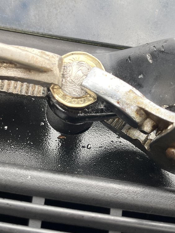

I've got the one off after using wd40 and a lot of elbow grease but the one in the  centre of the window won't budge. I've tried putting a pound coin over the top but in just deforming the coin
Finally got the sods off! Battered the wiper arm in the process but at least it's done
