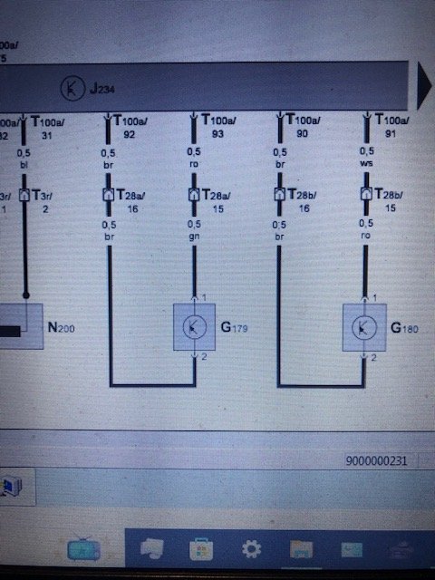

G179 is Drivers side impact sensor & G180 Passengers  T28a or /b are the main connectors for the door wiring on the A pillar
