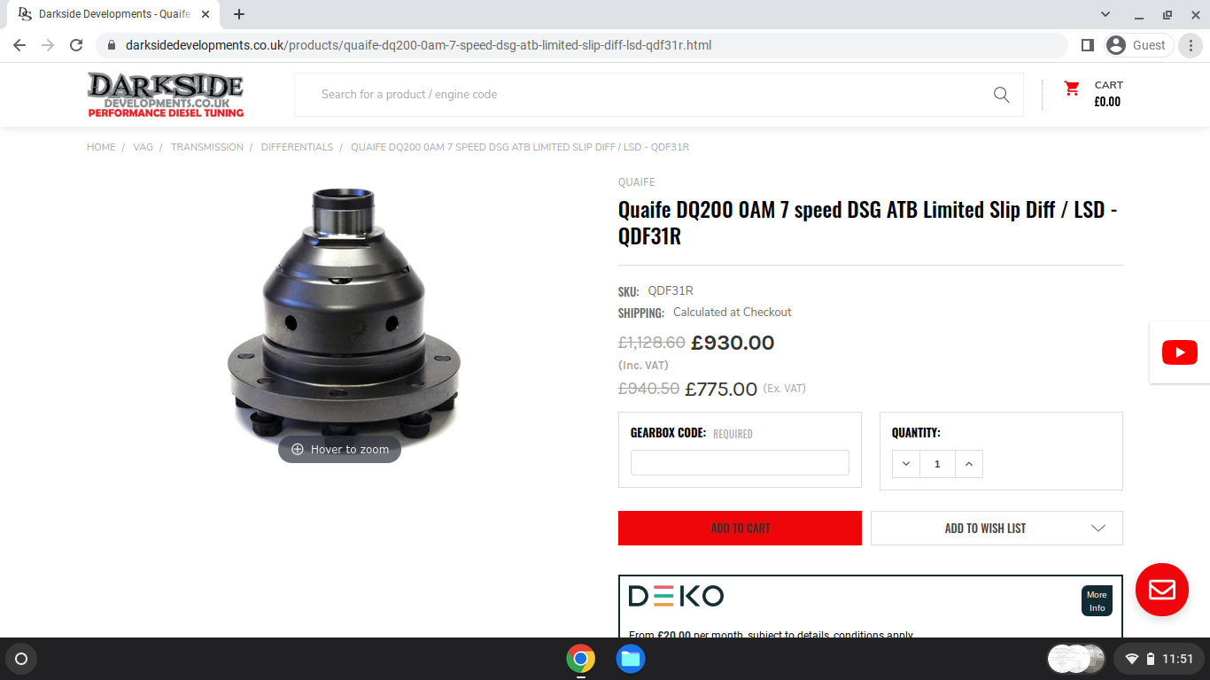

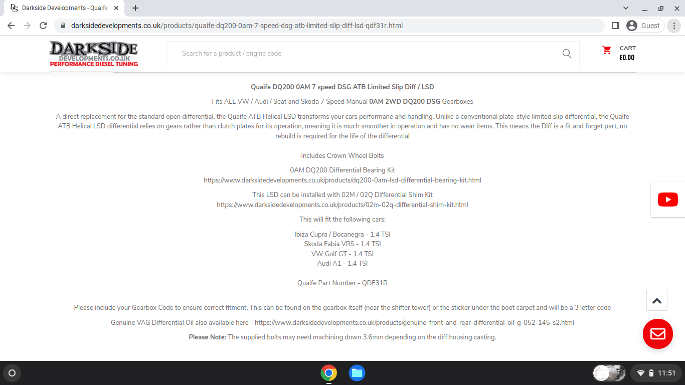

Is it possible to fit a limited slip diff ? I find the stability system lacking
@Crucian. Why do you need to know?   Your car if it still has the original DQ200 it left the factory with should maybe have had service campaign 34h5 done since 2017.   Ps. Edit.    Everything is possible.   @thomasaspin should be able to advise.     Or use search and you can read the threads.    DQ200 Quaife LSD.    You will see it showing for the Polo GTI 2010-2014.

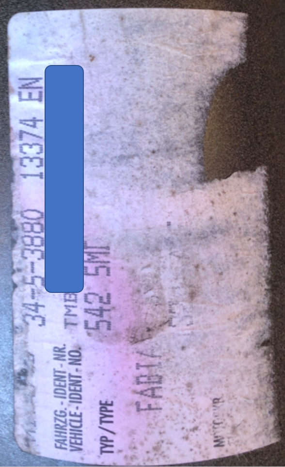

Hmm spare wheel well sticker has print rubbed off, I suppose a dealer will be able to send me a Build sheet ?

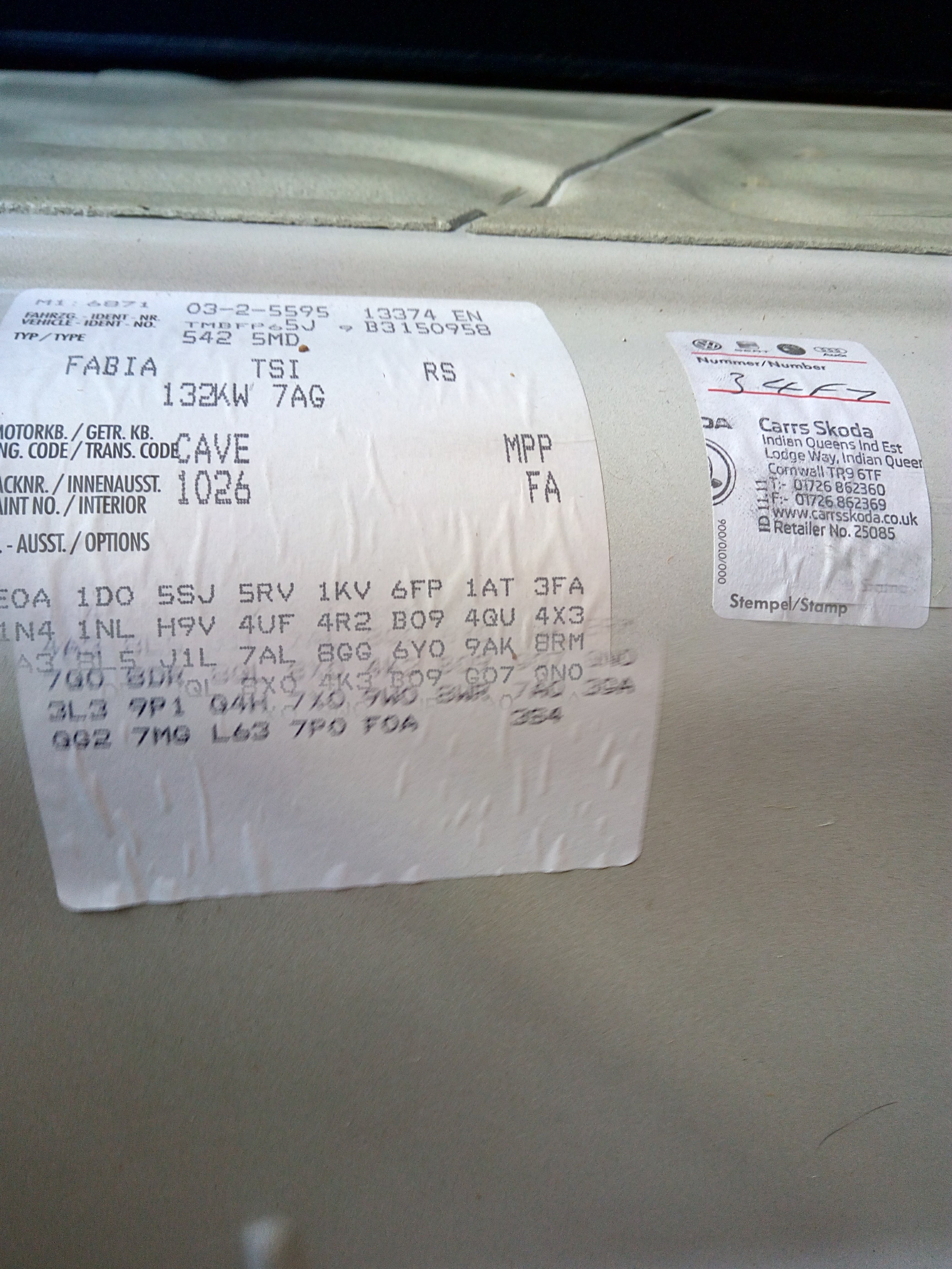

It will just have CTHE rather than CAVE and we know what the gear box is.
IMG_20171003_104733.jpg.7973812dd980dd31e9f629b718d24b04.jpg.386f346f8d3c28ce97708628f5ed3539.jpg
its a CTHE engine
