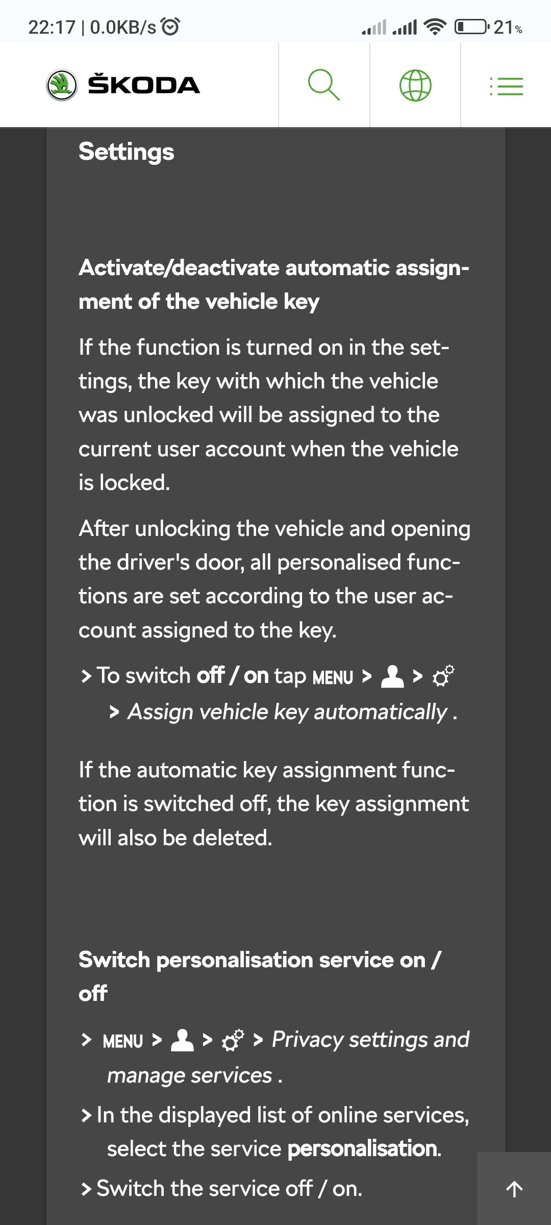

To answer your second question - yes, she will have to create her own account. She can do it through my skoda app on her phone and then log in on the infotainment or create an account in the infotainment (menu - users - plus sign). As for the key assignment, follow the instructions in the photo (haven't done that so am unable to help)
