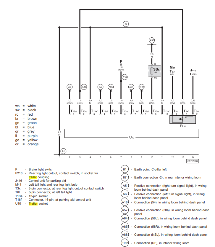

The factory 'trailer coupling' wiring is as shown here:
230613040_Screenshot2022-10-0310_09_52.thumb.png.7d191ea738c81f14db6782adb59f7c21.png
The various connections to the trailer light socket just tee off the feeds to the existing rear bulbs.  13-pin socket wiring is shown, 7-pin is obviously simpler and probably what most people will do on a car of this age.

So is U10 a factory fitted 13 min trailer socket or a 13 pin generic socket that a 7 or 13 pin trailer socket can be connected to with a suitable adaptor?
The waters are muddied by F216, the cut out switch is normally inside the trailer socket, that they have given it a connector number makes me think its within E10 and the towing socket is fitted as standard.
Can you put me right?
I searched in vain hoping to find a factory socket containing the wire feeds I needed for my Yeti, I could not find one but that doesn't mean it isn't there, I'll be peeved to learn that it is but it would enable me to remove 2 wires running across the rear and some splice connecters, albeit Molex glycerin filled telecoms ones but vulnerable nonetheless and a potential problem.
OK, I understand now having read the column on the right, they tell you how to wire it in and where to splice into the existing loom, strange that they would give the connectors numbers.

13 minutes ago, J.R. said:
So is U10 a factory fitted 13 pin trailer socket
I believe so, yes.
It's not showing you how to do trailer coupling wiring, it's showing how it's done from the factory.
Do you mean the A5, A6 etc? They aren't connectors, they are inline splices in the loom(s).

I very much doubt the same applies to a Yeti, but this is the 2-second coding change required on Polo 9N/Mk1 Fabia platform: VW Polo (9N) Central Electronics - Ross-Tech Wiki Can be done with VCDS Lite, probably even the unregistered version.
No the F216 and A10, but now I understand that it is the wiring diagram of the factory fitted trailer wiring option which would be a different loom I understand.
Thansk for the VCDS coding, I will have a look sometime.
If perchance that option is available then I would have to remove the bypass relay or the additional bulb loads could not be sensed.
I doubt that it is given there exists a canbus node towing module.
