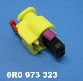

does anybody know the part number for the yellow plug that goes alongside the green one, under the drivers seat

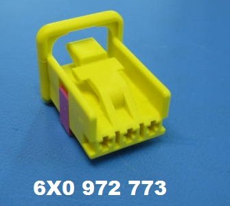

I "think" your after either of these 2 ???
One is 2 pin, one is 3 pin.

The top one — thanks! I don’t want to solder the wiring but I may have to.
