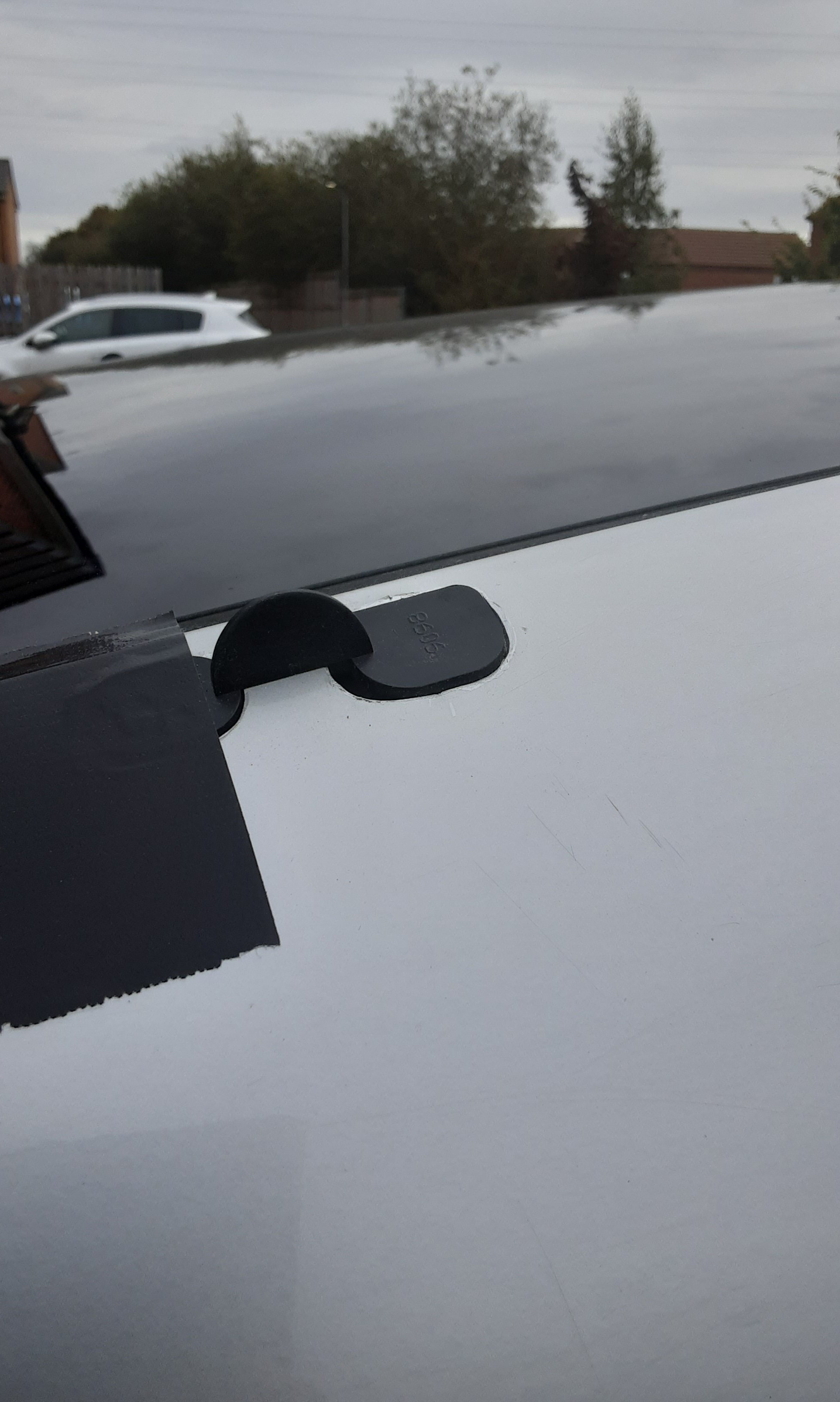

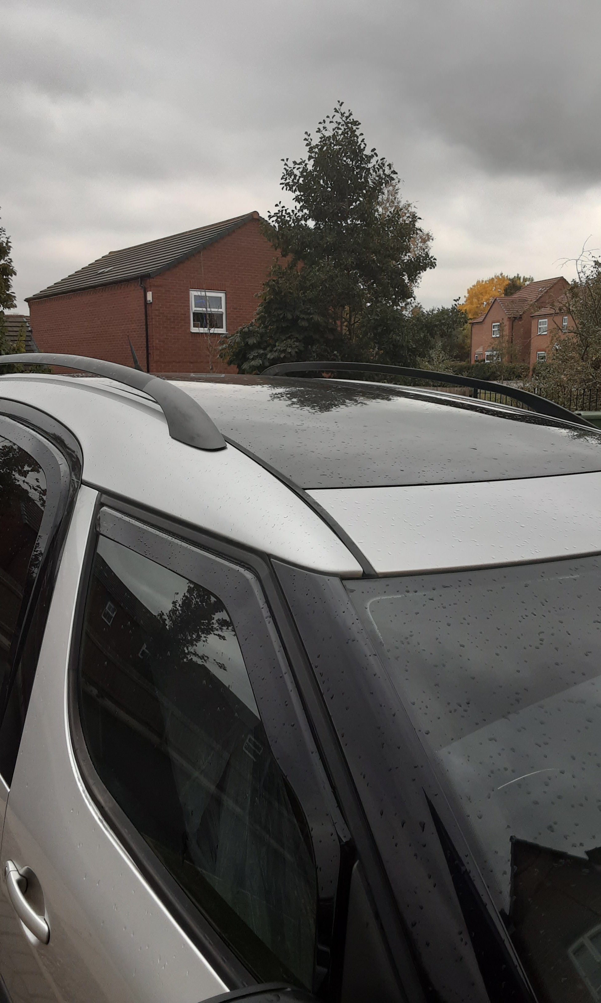

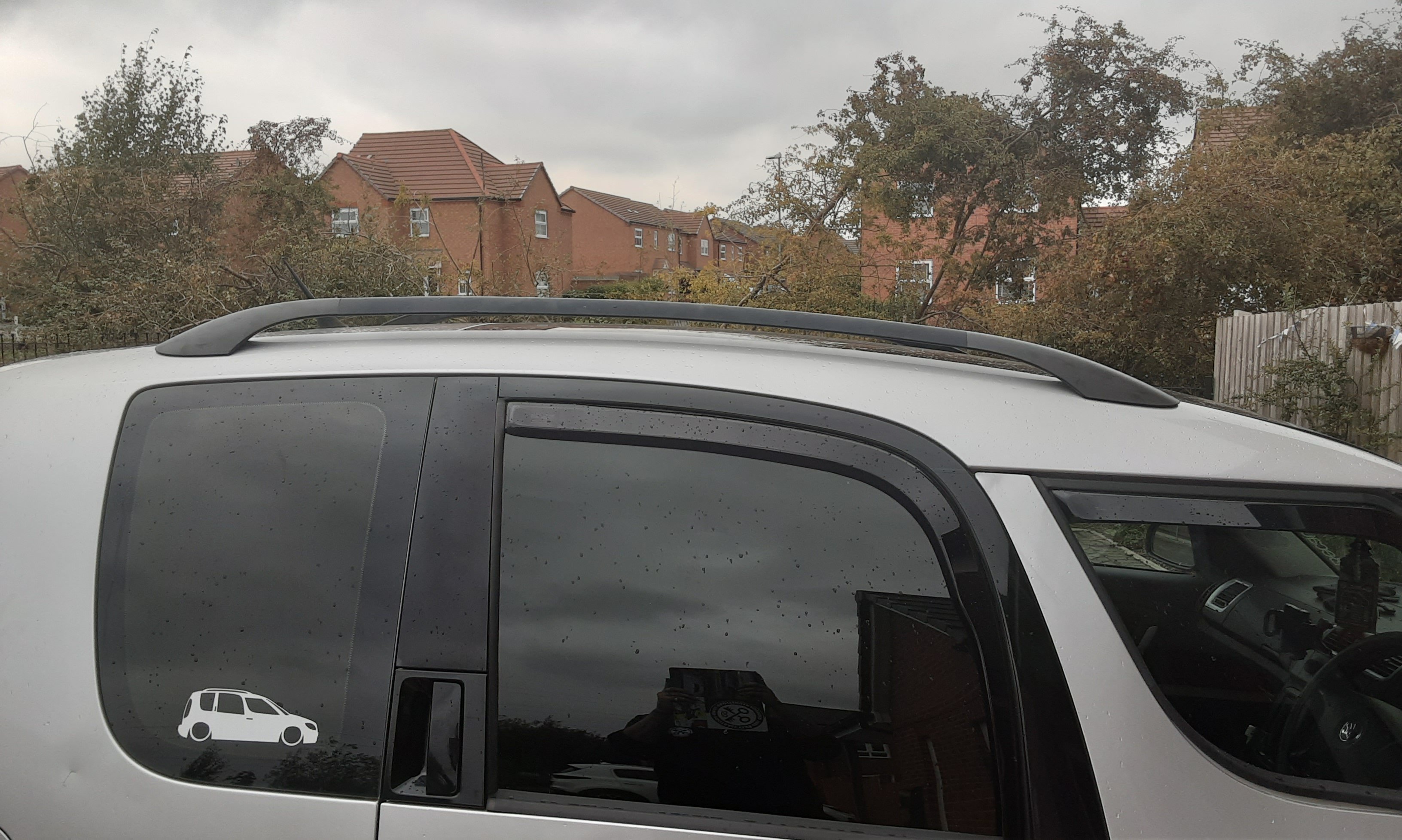

So, as many members know I've been wanting advice on how to fit the roof rails to my Roomy.
I just thought to let them know that as of yesterday they are on 👍😃
I brought the template fitting kit from Skoda Parts Direct (£140) and it comes with the locating bungs.
I brought some second hand roof rails.... (recycle ♻️ save land fill 😂😂)
And I got a local bodyshop to widen the holes to the correct size
And no, the headlining does not need to be removed (even skoda dealerships say it does) it doesn't, all done on the outside.
I'm pleased, I'm happy I have my dream Roomster now... like it should of been when it left the factory back in 2007 🤣😂🤣
Just need a roof cage now 🤣😂🤣
Thanks to everyone for the advice - much appreciated 👍👊

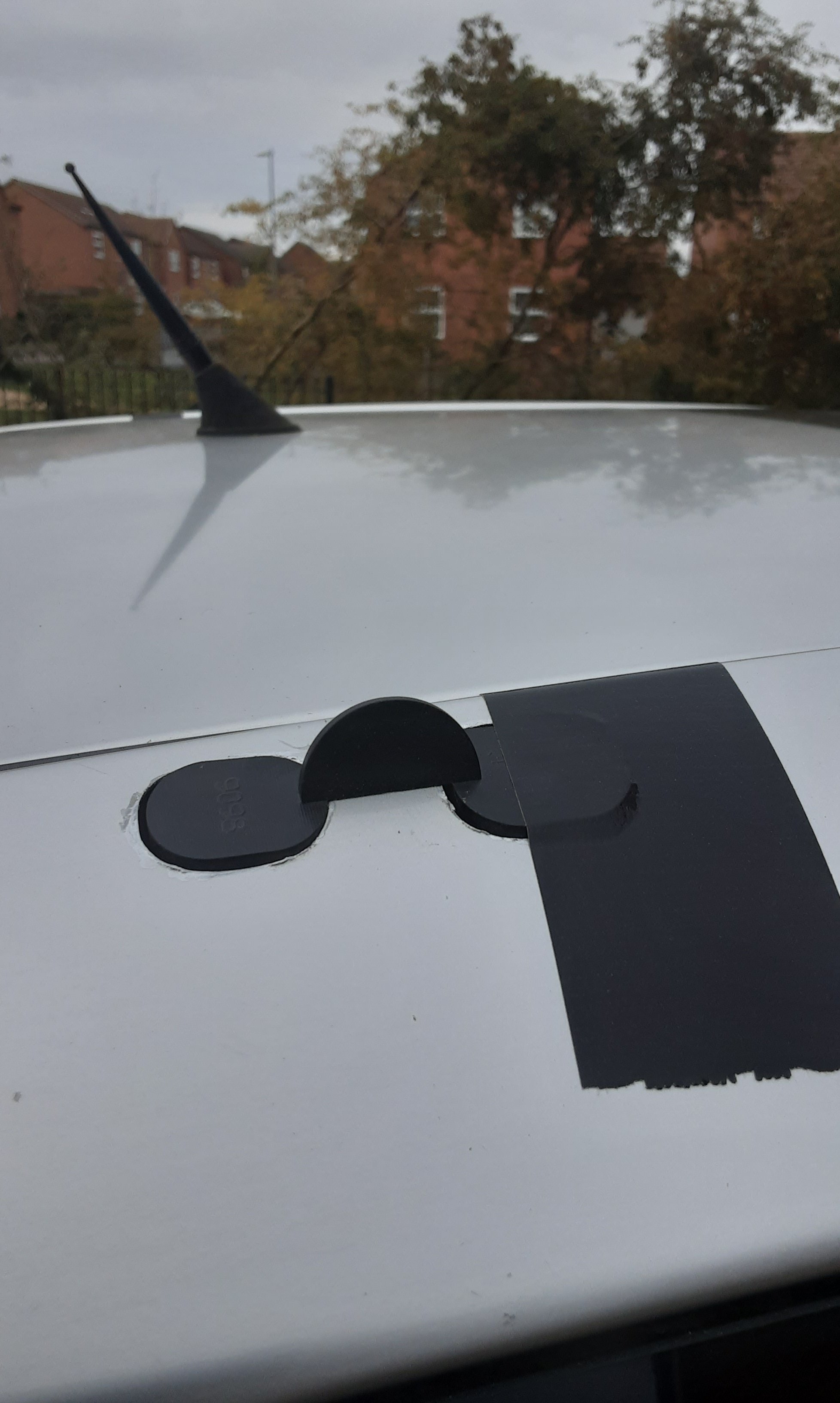

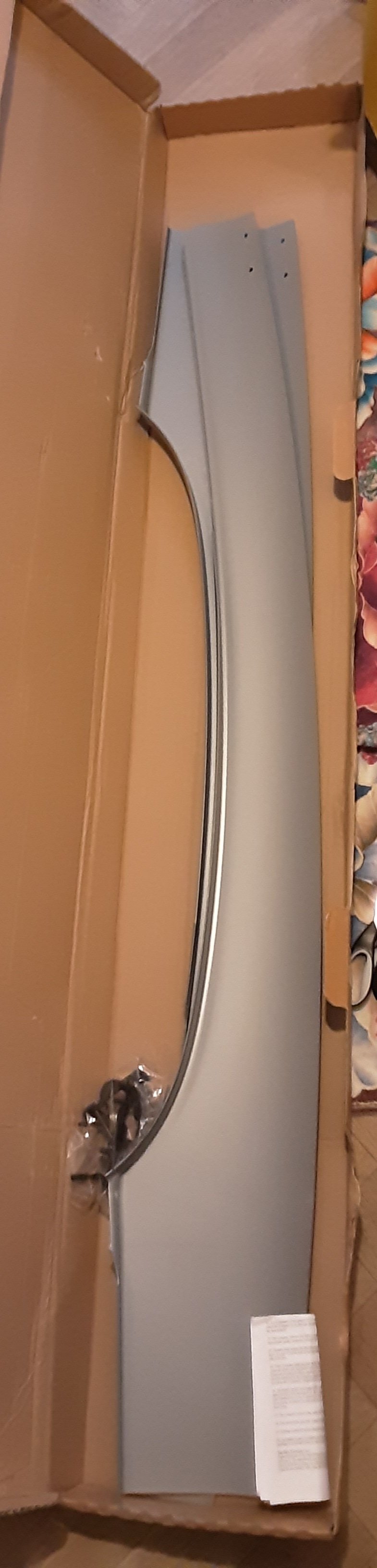

Hi J.R. yes you do get a bit more the sticky back plastic.
The black tape is what my local bodyshop put on so I could drive home.
I have attached the templates, which are hard plastic.. and the black bits are the locating parts so you can widen the holes upto correct size.
