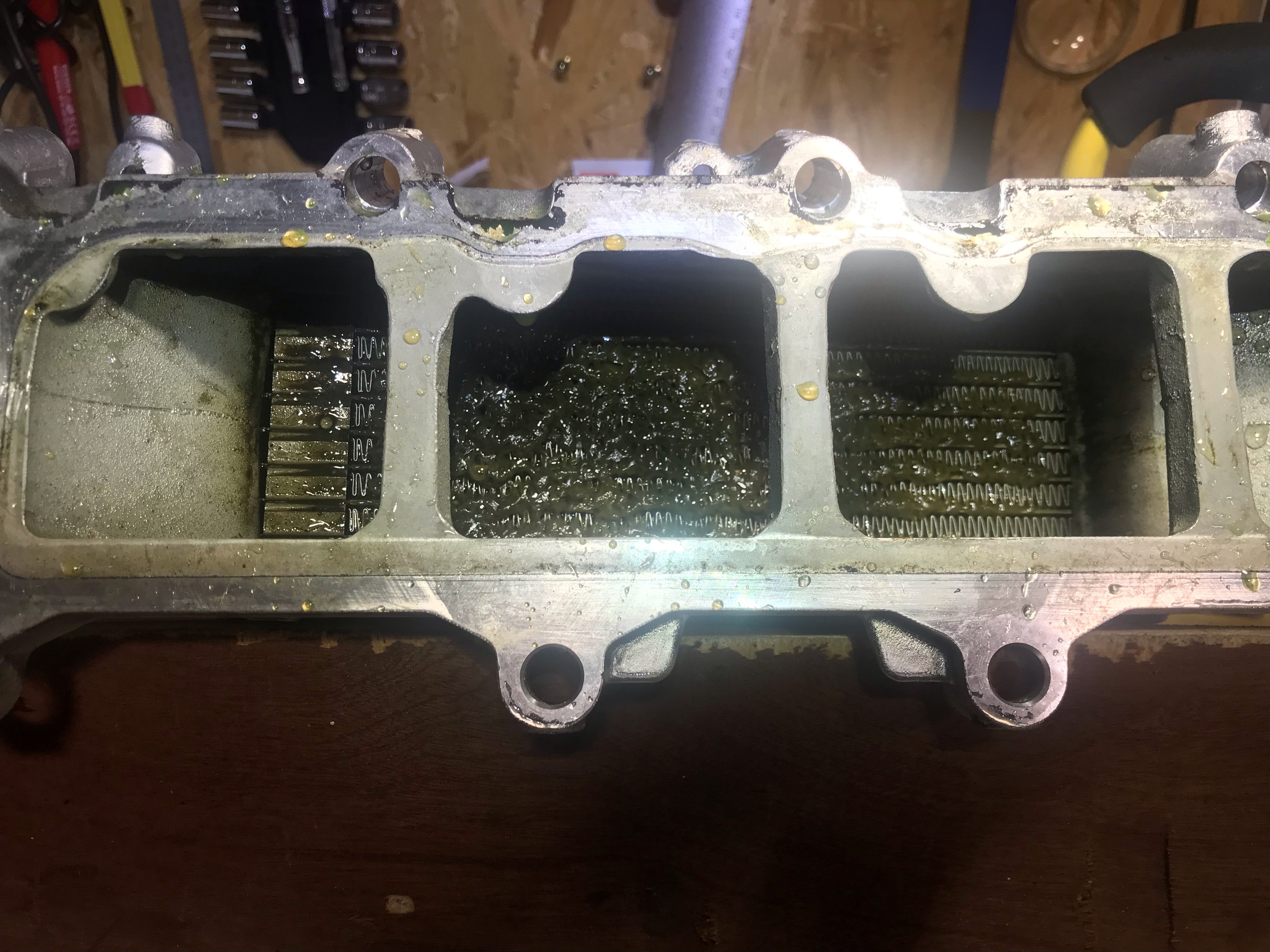

Well that was a pig. Lots to disconnect. The service manual is useful but was easier just to start stripping things that were in the way in the end. Lots of gunk in the charge cooler. Wonder are these not getting much fresh coolant flowing through them as they are on a separate loop so corroding sooner? Might also be the case that when coolants being flushed they aren’t flushing this circuit? Here’s hoping I get a few more miles out of this one!
I assume that gunk is just emulsified oil from the turbo and CCV mixed with the coolant on its way out of wherever its leaking. Would be interested to see where it has failed
Do you have access to a bandsaw, would be cool to see a cross section also, that would tell you if there is any corrosion, more likely maybe is failure due to vibration, a failed weld??
Ye it’s just a mix of oil and water. There’s a tiny bit of oil misting in the throttle body.
No bandsaw I’m afraid. It was leaking from numerous spots when pressurised under water. Who knows how far into the cooler they were coming from.  Wasn’t just the one point there were bubbles coming from.
