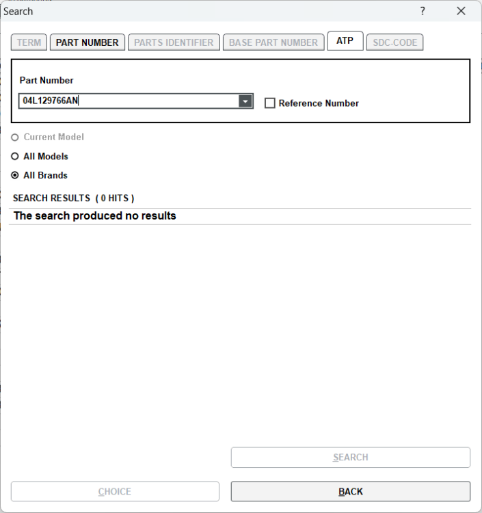

  • Could also be AH. I just can't see dots where dots should be to make that last letter read as an M?
  • @varooom may be kind enough to confirm/deny whether those other numbers from the skodaparts page are all supersedences of one another.
  • 04L 129 766 Q --> 04L 129 766 AM --> 04L 129 766 BA   This is how your part changes to the latest version
They should all be revisions of the same part. Not sure how to work out what order they came in. Usually alphabetical but sometimes not.

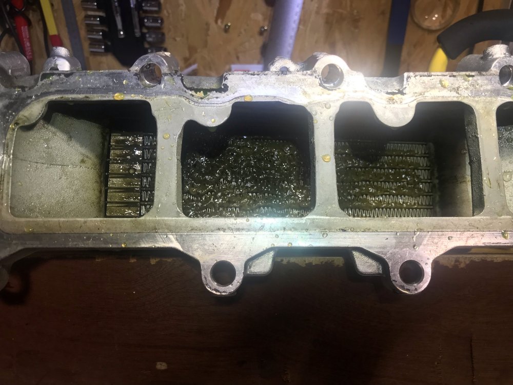

Things I'll note here for the benefit of folks trying to diagnose in the future.
I got a weak-positive sniff test - This was a red herring and was likely recirculated exhaust gas into the pressurised manifold then the coolant - it didn't mean a cracked block or post-engine leak for me.
Borescope into the temp sensor on the manifold when the coolant was hot and pressurised showed coolant leaking into it.
