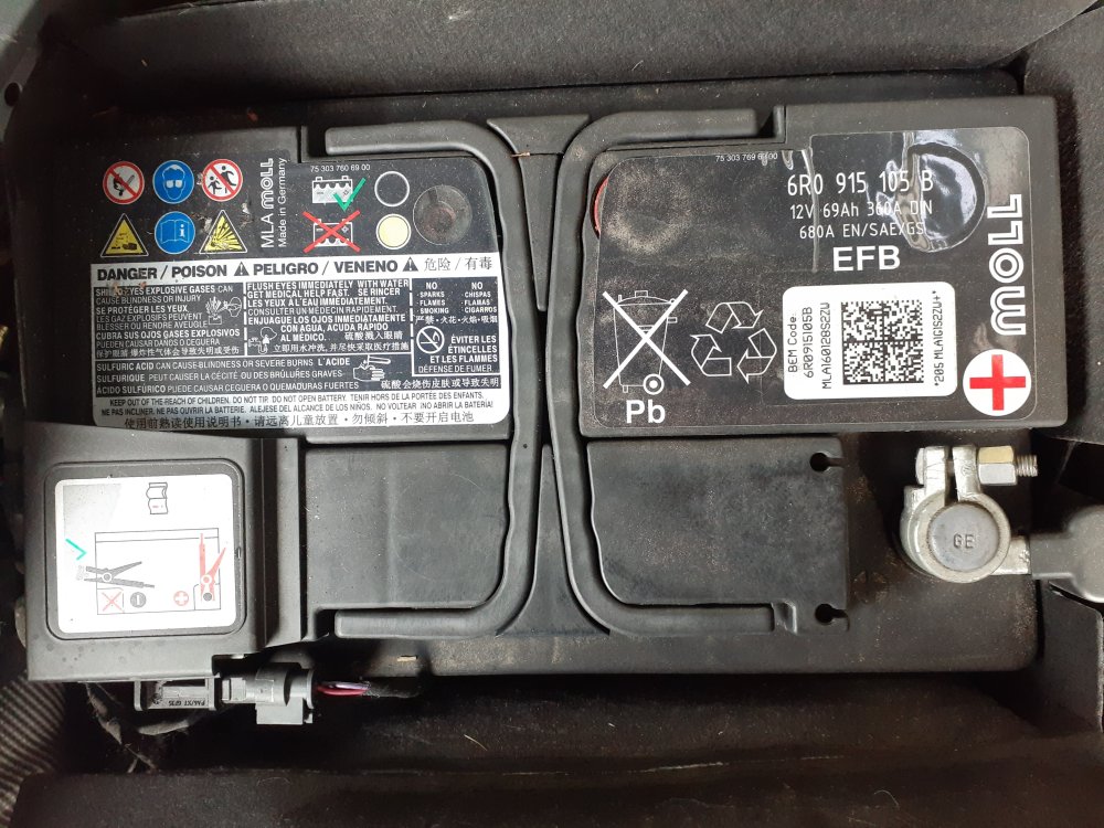

What year is your car? If it is the original make a note of what battery you have, they’ll be a sticker saying AGM or something else B?? Then buy a direct Varta replacement. If it’s not obvious to you post a picture on here

Battery ooks like the original. Is there a best place to buy an exact Varta replacement?

You have an EFB battery

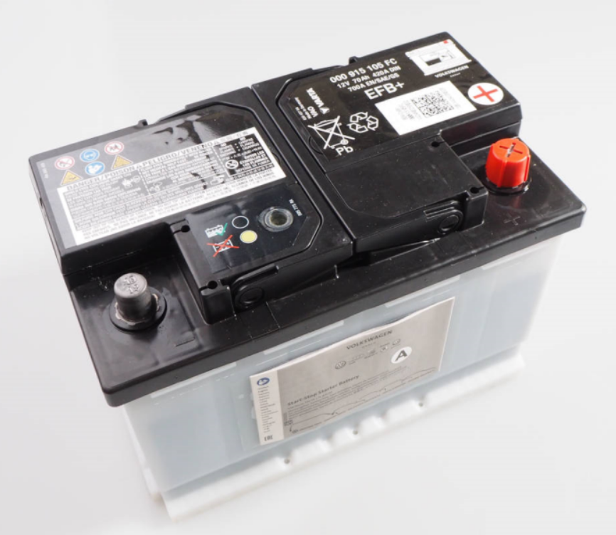

6R0 915 105 B that is eventually replaced by part number 000 915 105 FC
https://www.autodoc.co.uk/car-parts/oem/000915105fc
EDIT: You will need to adapt the gateway of the car to let it know the new capacity of say 70Ah and just increase the serial number by 1.
EDIT 2: An image for the new part number, zoom and rotate for Varta branding
Just above the no bin option = Varta
