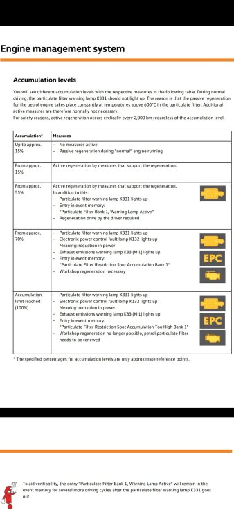

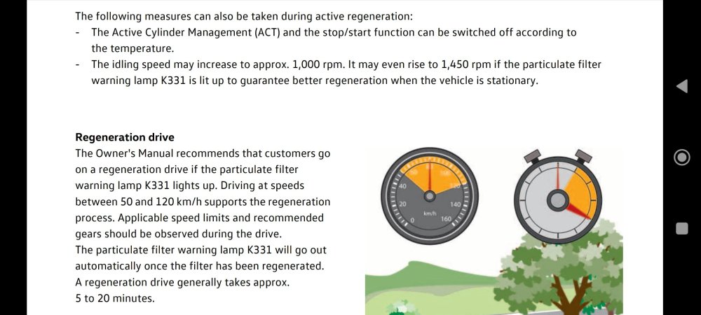

  • These SSP documents should be useful to read (for anyone wondering how GPF works)   SSP558 Close-coupled Petrol Particulate Filter - Design and Function.pdf   SSP590 Underbody Petr
  • Check manual, see if you have a GPF (or what the petrol exhaust filter is called) trying to do a regeneration cycle?
  • The GPF might just be the issue.   It is a matter of time before posts on these will become more common. People will be asking at dealerships and employees will have not a clue.

If my 60 mile blip up the motorway and back the other day really has cleared the problem then the 200 mile lincolnshire trips i do say 3 times a year most of been enough. Its pretty much all motorway until i get to near Grantham on the A1 then take the back roads to Sleaford.
Car always sounds much smoother and usually can't hear the engine running when i stop to park up. All being well will be doing that journey middle of next month.
I'm doing 18 miles a day through the week on the work run. Its all country B roads with a about 5 mile 50mph section. its like a 20/25min journey with a clear run, i can get home in 15mins if the roads are empty. Obviously not enough run time at higher speeds.
I can get on the motorway but its the M27 and its crap where i am so never use it on the work run.
I'll just have to work the engine a bit harder to try and get the exhaust temps up and go and visit the family more often!
