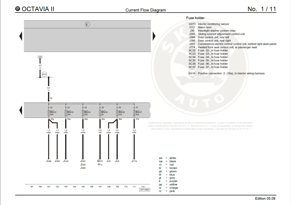

I looked at wiring info yesterday and there seems to be two power feeds to each rear door, but they share fuses, so if offside rear door is working OK then fuses must be OK too. Both are red wires with another colour tracer.
Maybe the brown  earth wire to NSR door module is bust somewhere. See if  you see power on either of those red wires if you put your meter earth on some other earthed bit of chassis?

The door control modules are getting their power from the electric windows fuses.

Sadly, they both use the same fuse and the right-hand door is working just fine.
