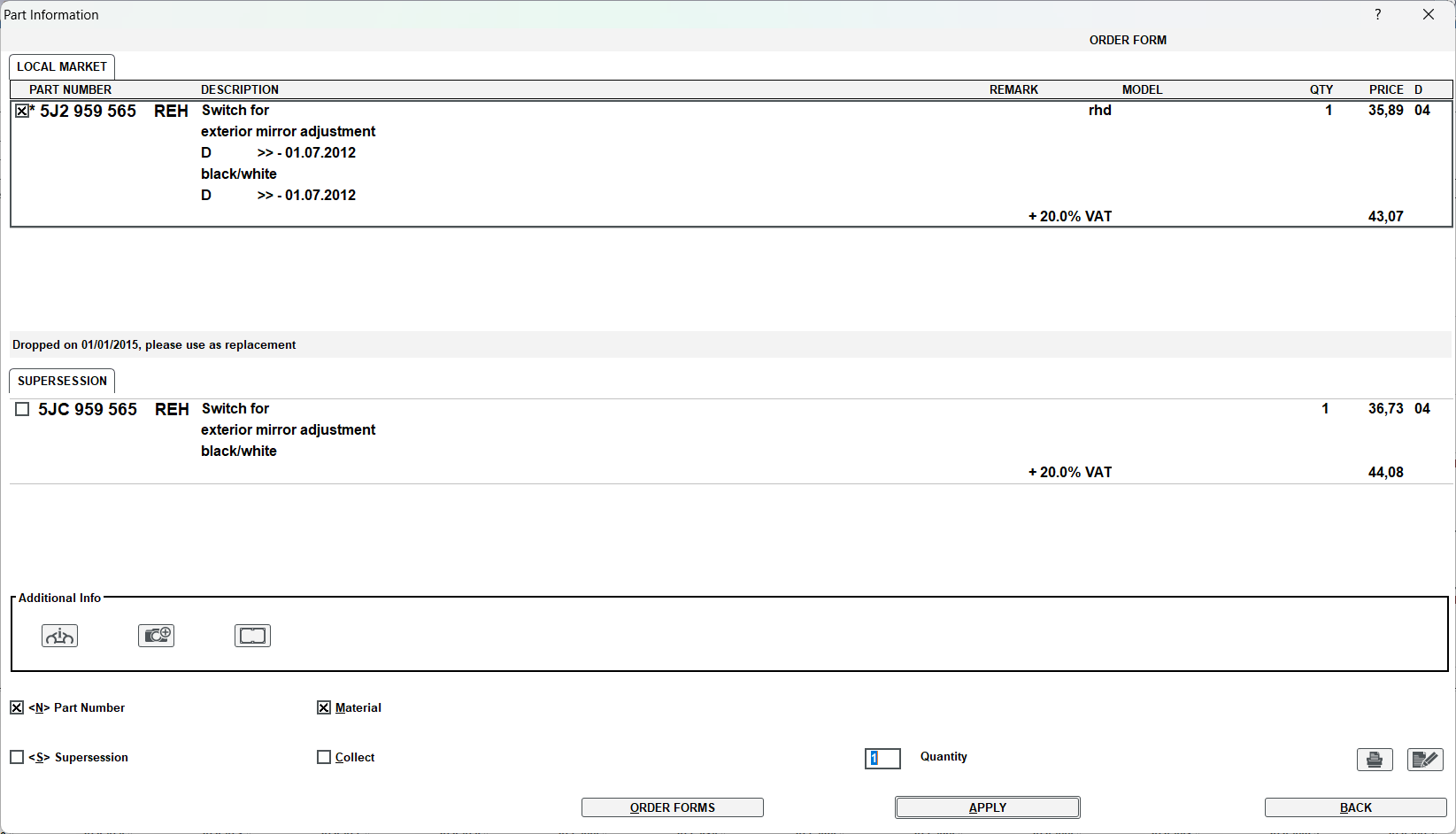

The RHD part number should be as shown here, also it has been replaced (either number second hand should suffice)
