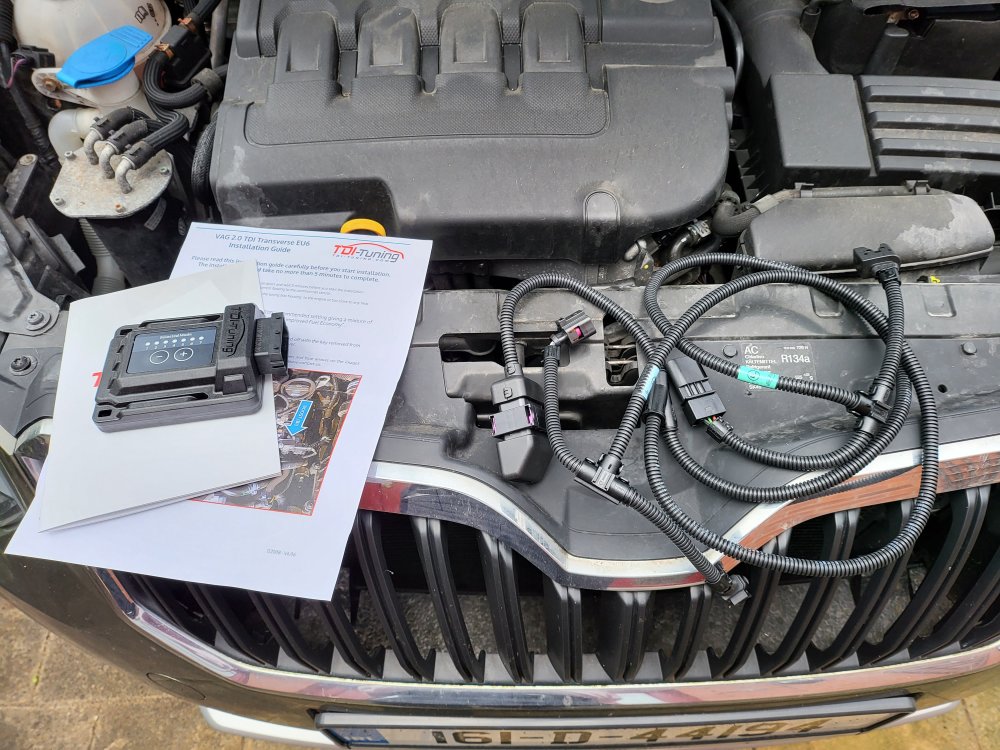

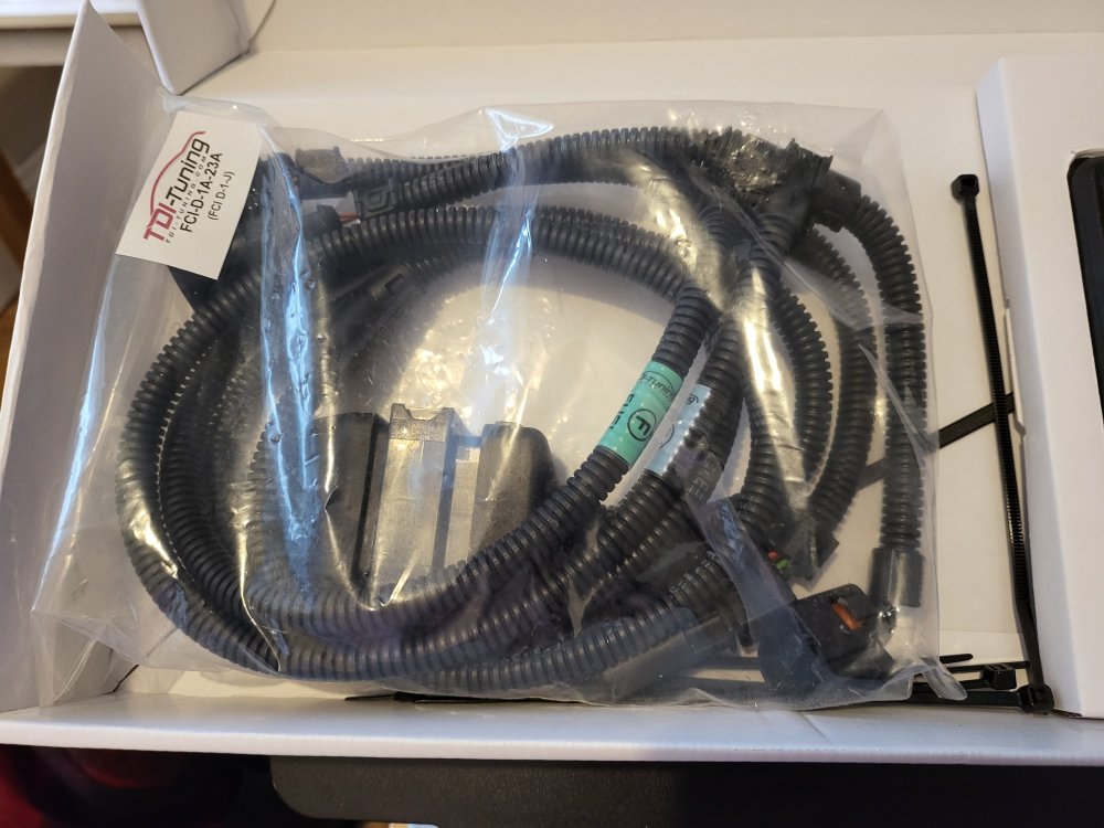

Box with the device, the cables, and instructions:
The cables, with two connectors: the fuel injector and the booster:

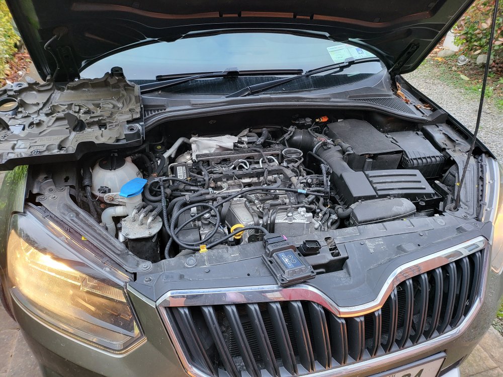

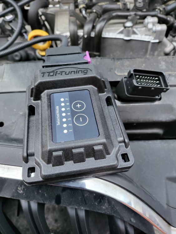

Device and cable laid out on top of the engine compartment:

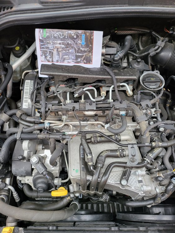

Remove the engine cover, starting at the top left or right corner (snaps) then the lower corners (laid out the instructions to aid me):

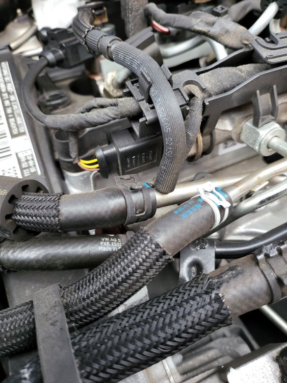

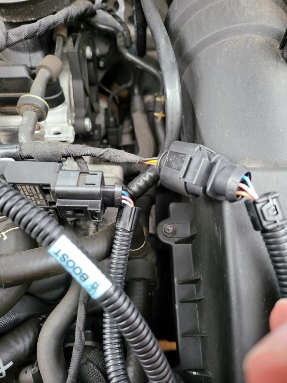

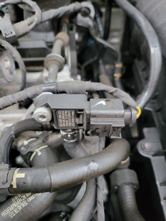

The Booster Connector (connects to the blue TDI Tuning connector), it has a locking mechanism that needs to be released before unplugging (on the top of the connector, pull up, lower right of this picture):

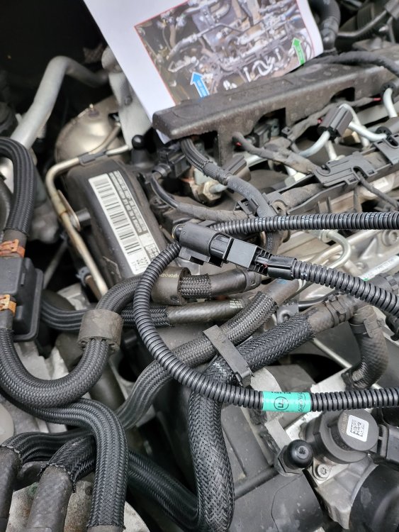

The fuel injector connector (connects to the Green TDI Tuning connector), locking mechanism is on the other side, and must be released before unplugging:

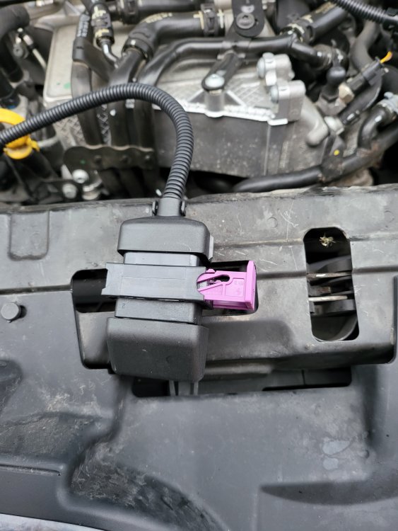

Connect the TDI Tuning connector to the Booster of the engine, and the Booster connector to the TDI Tuning cable:
Connect the TDI Tuning connector to the Fuel Injector of the engine, and the Fuel Injector connector to the TDI Tuning cable:

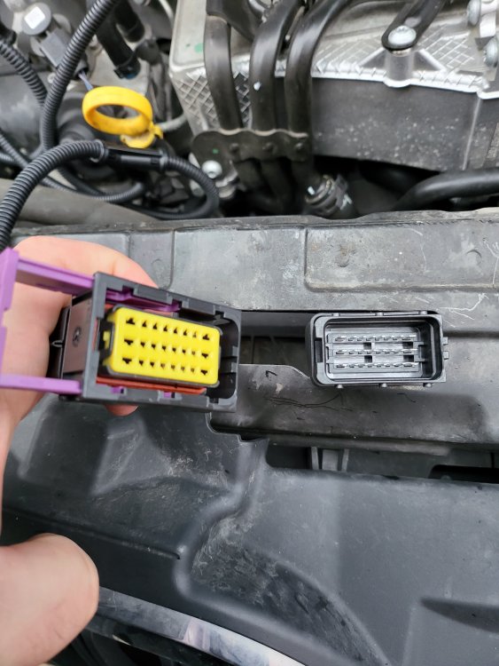

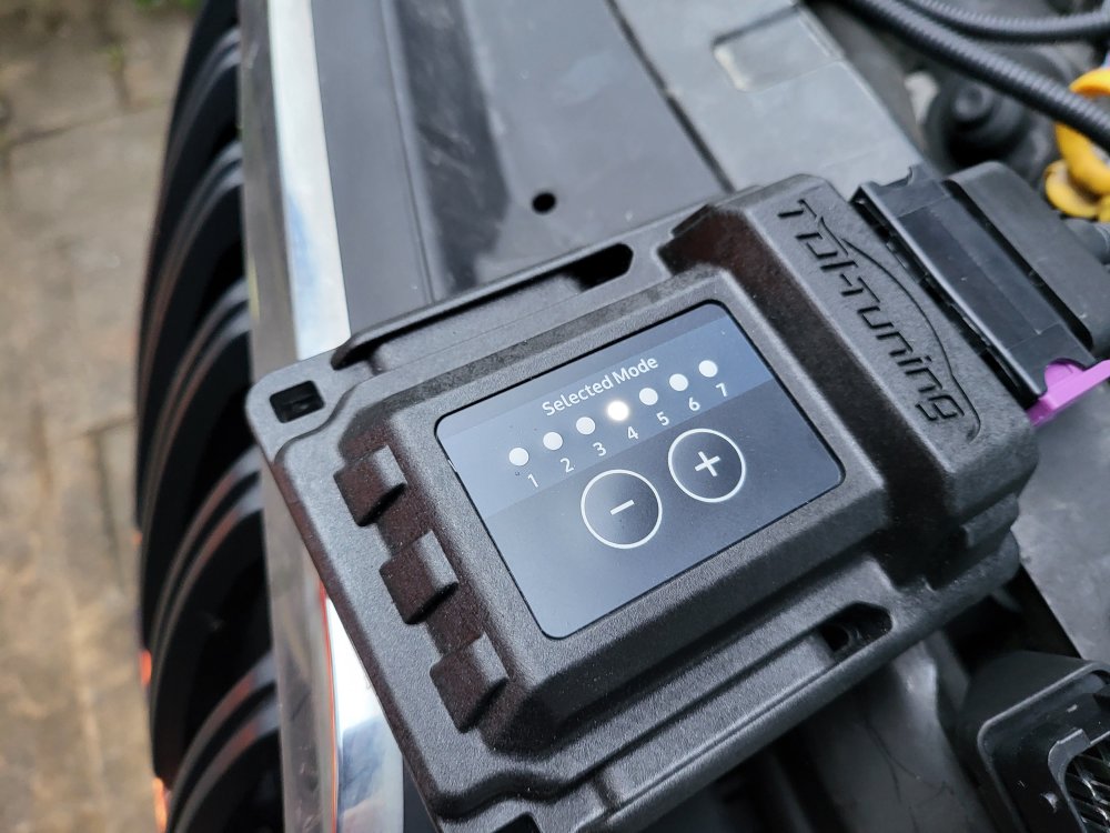

Disconnect the plug and connect your TDI Tuning device (it only fits one way, though take a look before trying to plug it in, and lock it):
Start the engine, and check the dashboard for any warning lights, followed by checking the lights on the TDI Tuning device:

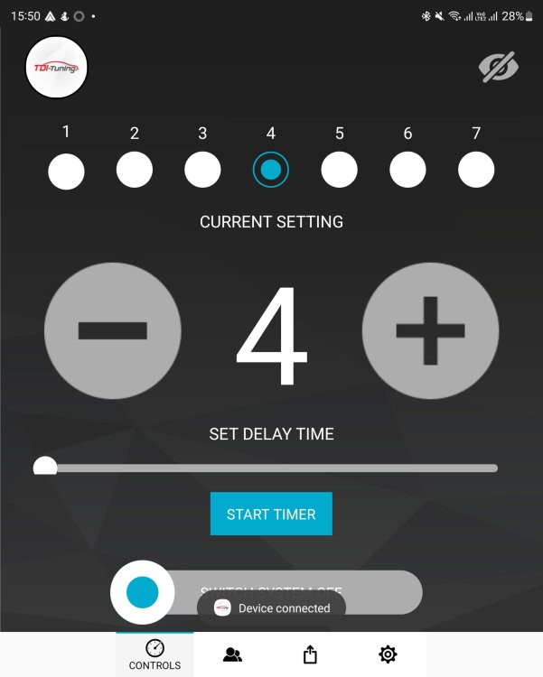

Download, install, and connect your TDI Tuning app (only if you bought the BT connectivity) using the last 6 digits of the TDI Tuning's serial number (on the actual connector of the TDI Tuning device):

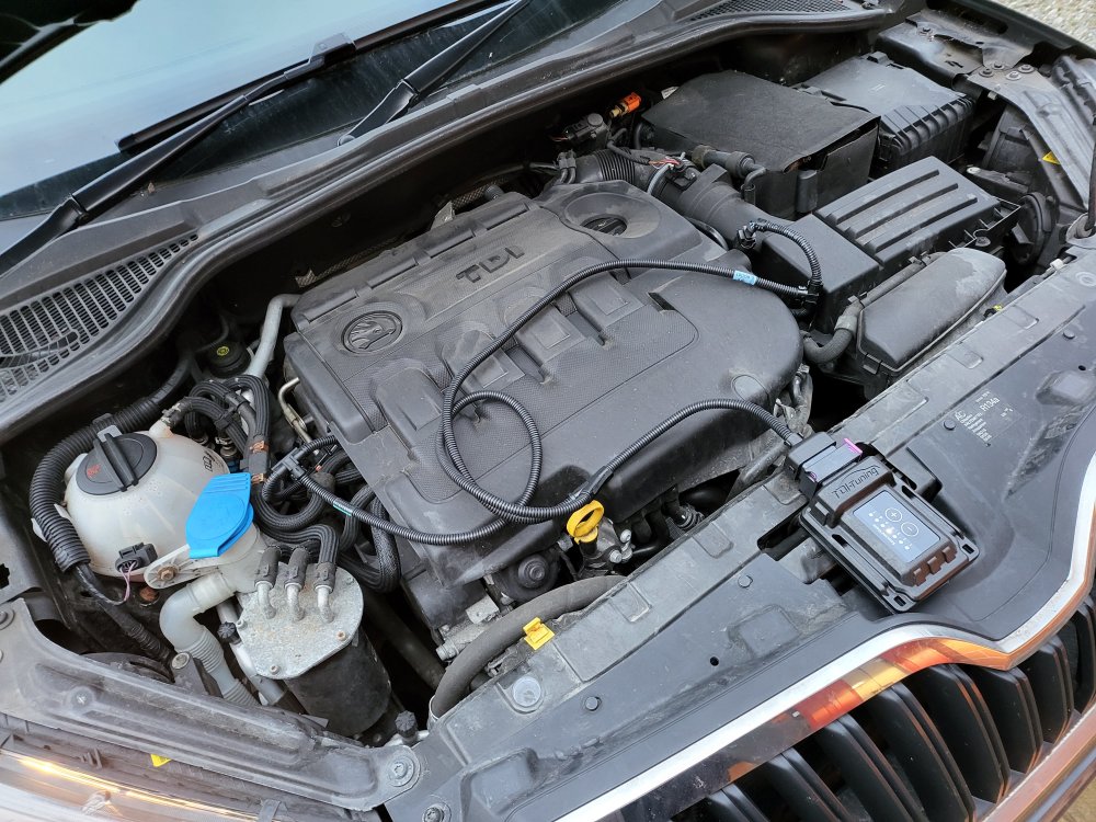

Snap the engine cover back in place, being careful not to trap the TDI Tuning cables underneath. Route and fasten your TDI Tuning device and cables. I ran the cables around the front of the engine cover and placed the TDI Tuning device in front of the battery (not shown):
