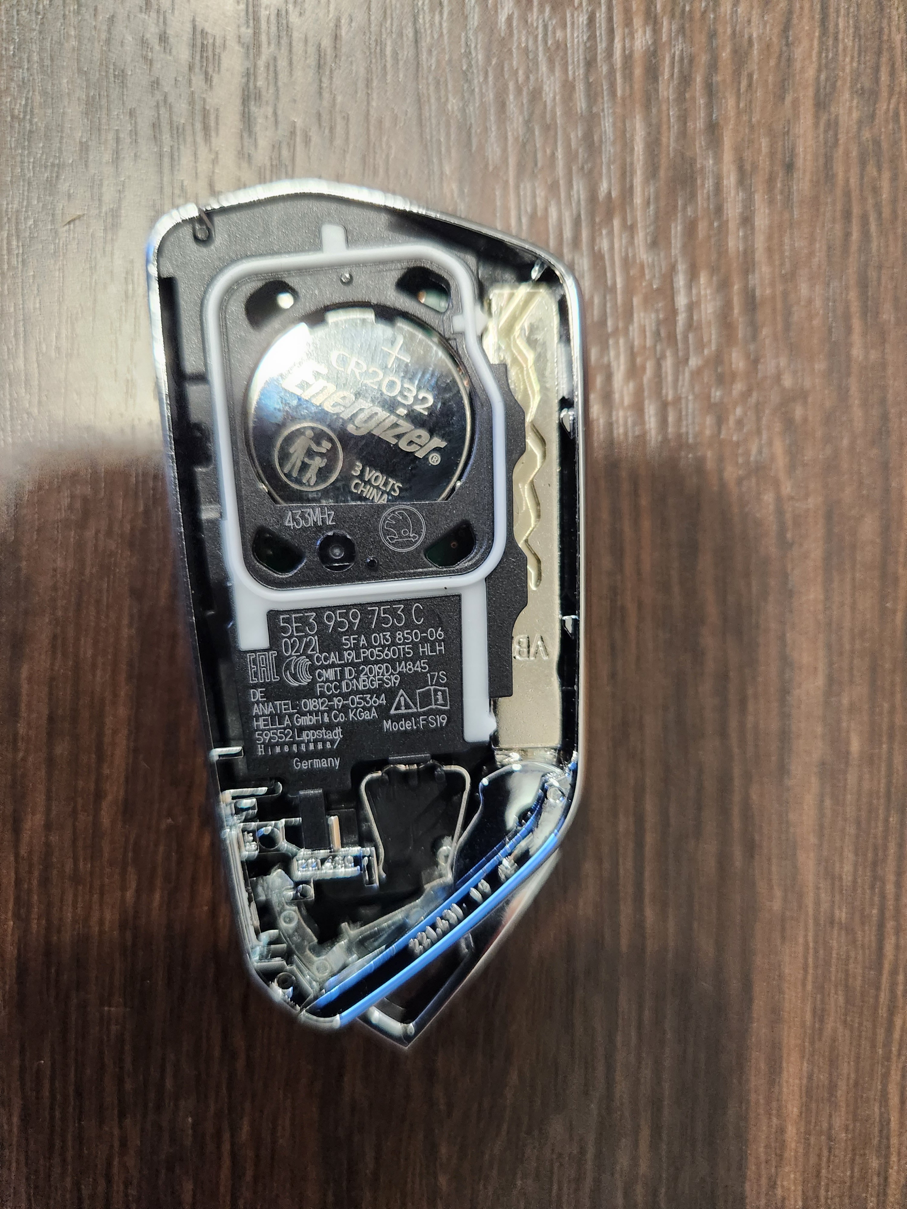

I had a similar issue after installing a new battery in my main keyfob. The mechanical key wouldn't stay inside. Very frustrating...
It wasn't until I opened my spare keyfob and looked for a difference in position, did I notice that the little spring wasn't sitting correctly inside.
With the cover off, you just have to ensure the spring is sitting flat on the plastic guides inside and allows the key to ride in and out without drag. I.e. not twisted.
Hope this helps.
For reference here is a photo of the key with the spring in the correct position.
