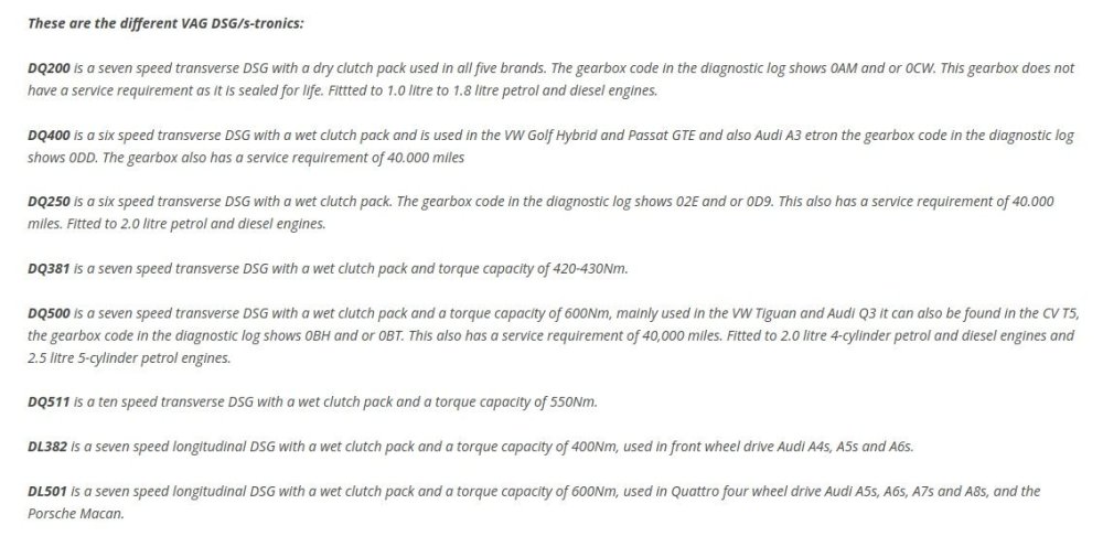

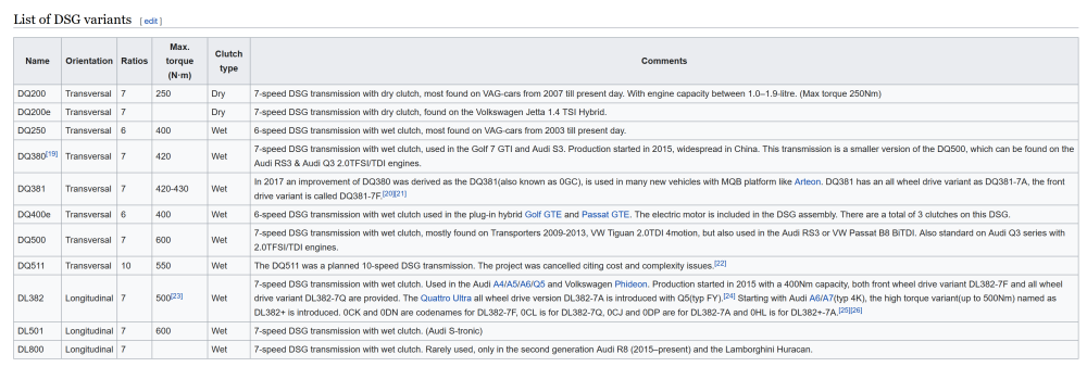

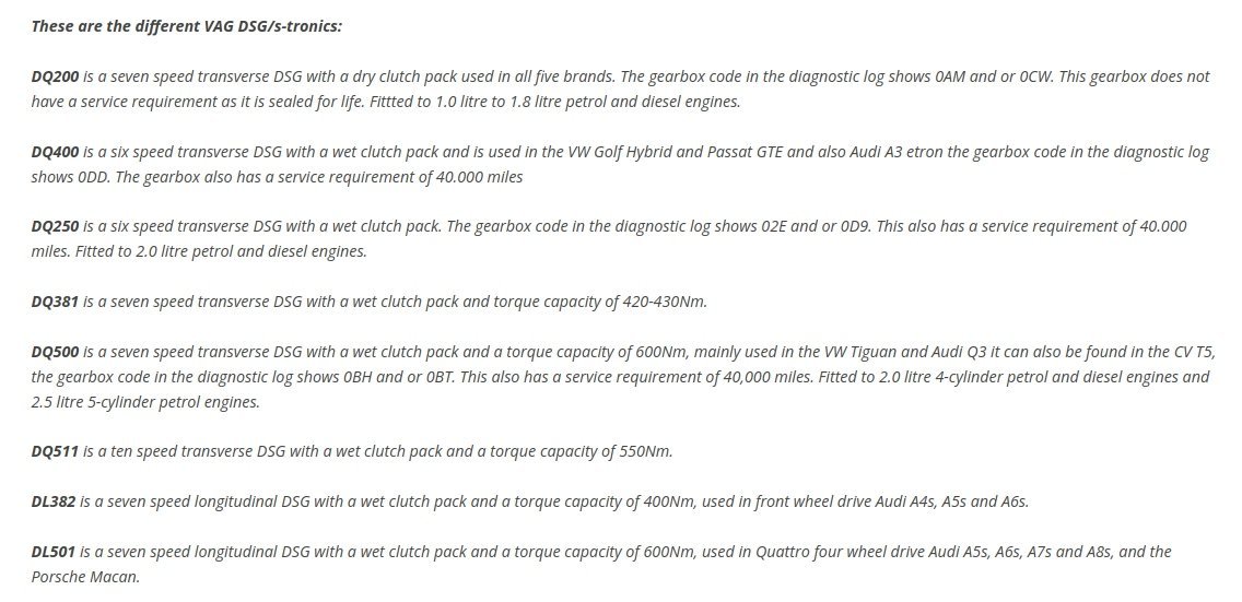

There are a whole load of variants of DSG, if you get a vin decode of the vehicle, you can see what type of gearbox you've got.
The wet-clutch 6&7-speed boxes are great.
Have a search on Briskoda and you can read accounts of people who've had manual gearbox clutch issues after a remap.
That said, you can always put a beefier clutch in, so it doesn't have to be a deal-breaker.
Just the chart I've been looking for, thanks! Seems from the year the box in the MK3 VRS will likely be the DQ380, but I'll check the VIN when looking at cars. I'm looking to go with a DSG box, don't think I can go back to a manual but thanks for the advice. So long as the DSG box is solid enough to take stage 1 then I'm happy.
