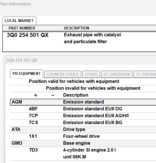

17 minutes ago, langers2k said:
Grabbing a list of PR codes for the VIN would be the easiest way to check, if you have PR-7CS listed, then it'll have a GPF.
Timeline for the reg changes from VW:
As the vRS was an existing model, the changes would have applied to cars built after the 1st September 2018. That means it'll be MY19 (Model Year 19) or '68 plate onwards. Some very early '68 plates built before September probably avoided the GPF /cdn-cgi/mirage/5f4ef285c808150b3f209d495b21415e83a1029349e39555bc33d19ff4f54894/1280/https://www.briskoda.net/forums/uploads/emoticons/emoticon-0100-smile.gif
Had a quick look on eBay at downpipes, Both shown below were listed as Golf MK7 GTI's which has the same (or very similar) 245ps engine as the vRS.
I believe the left is a pre-GPF and the right is with a GPF, it's probably that massive cylinder at the bottom /cdn-cgi/mirage/5f4ef285c808150b3f209d495b21415e83a1029349e39555bc33d19ff4f54894/1280/https://www.briskoda.net/forums/uploads/emoticons/emoticon-0102-bigsmile.gif
/cdn-cgi/mirage/5f4ef285c808150b3f209d495b21415e83a1029349e39555bc33d19ff4f54894/1280/https://www.briskoda.net/forums/uploads/monthly_2022_12/image.thumb.png.946d4ab999a10696a3da84a119b0f27c.png

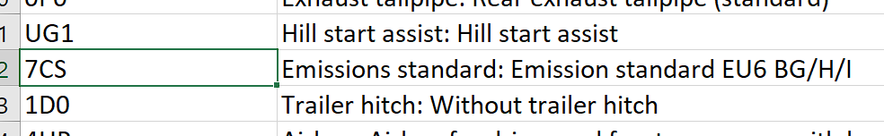

Ah ha! Thanks @langers2k, that code I have.
So the "rule" about indirect injection engines not having GPFs does not hold.
There are a few additional codes for anyone else that follows this thread.

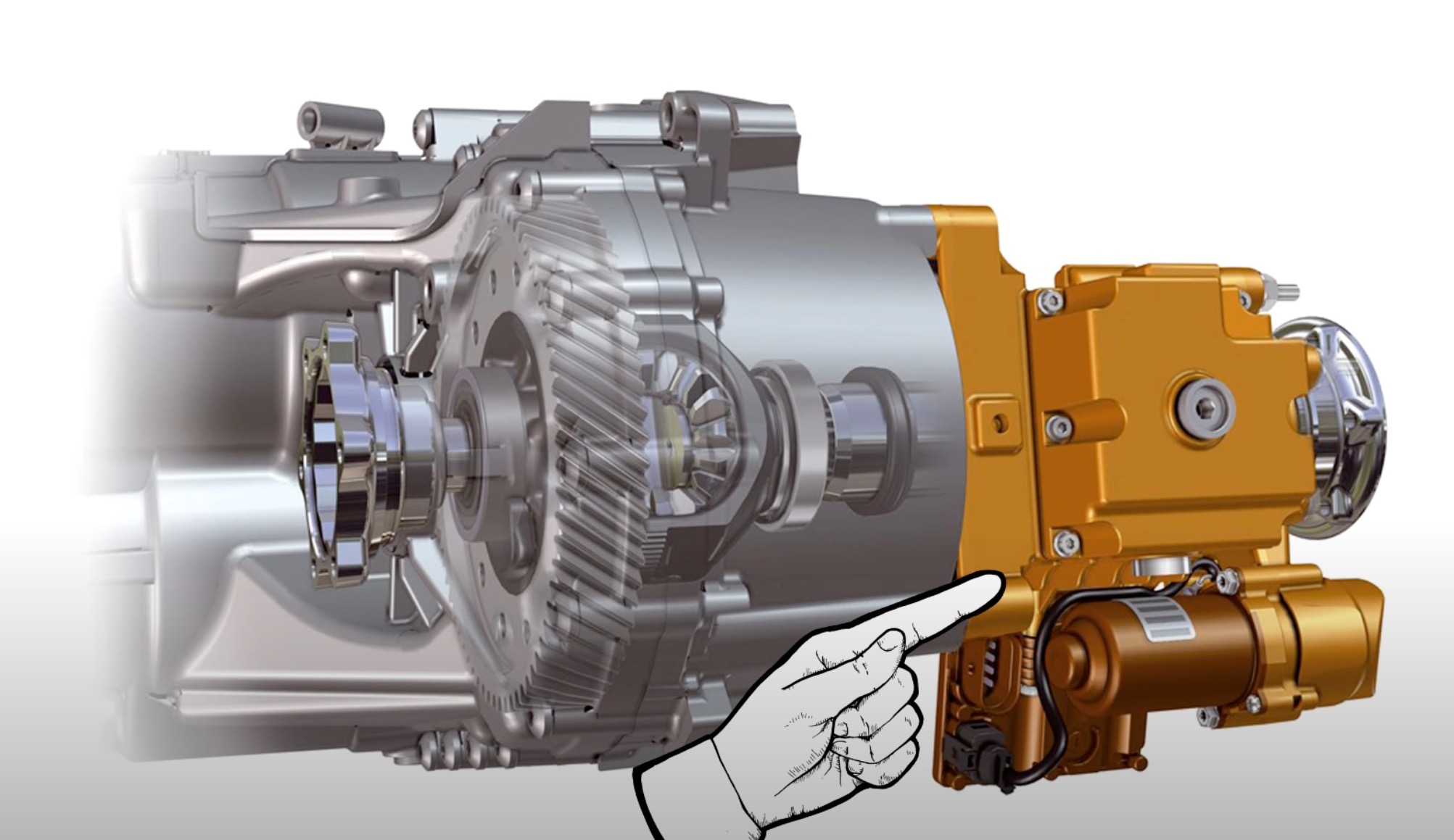

Stupid question: is there a sure fire way to check if a car defo has VAQ? Apart from age and release date.
Cheers,
Matt.
Isn't it physically visible?:
938451418_Screenshot2022-12-28at19_40_11.thumb.jpeg.15fc55048269433619b3f8697883a182.jpeg
Taken from here:
Gaz
Yeah I guess so, might be abit hard to see on a car lot though haha.
