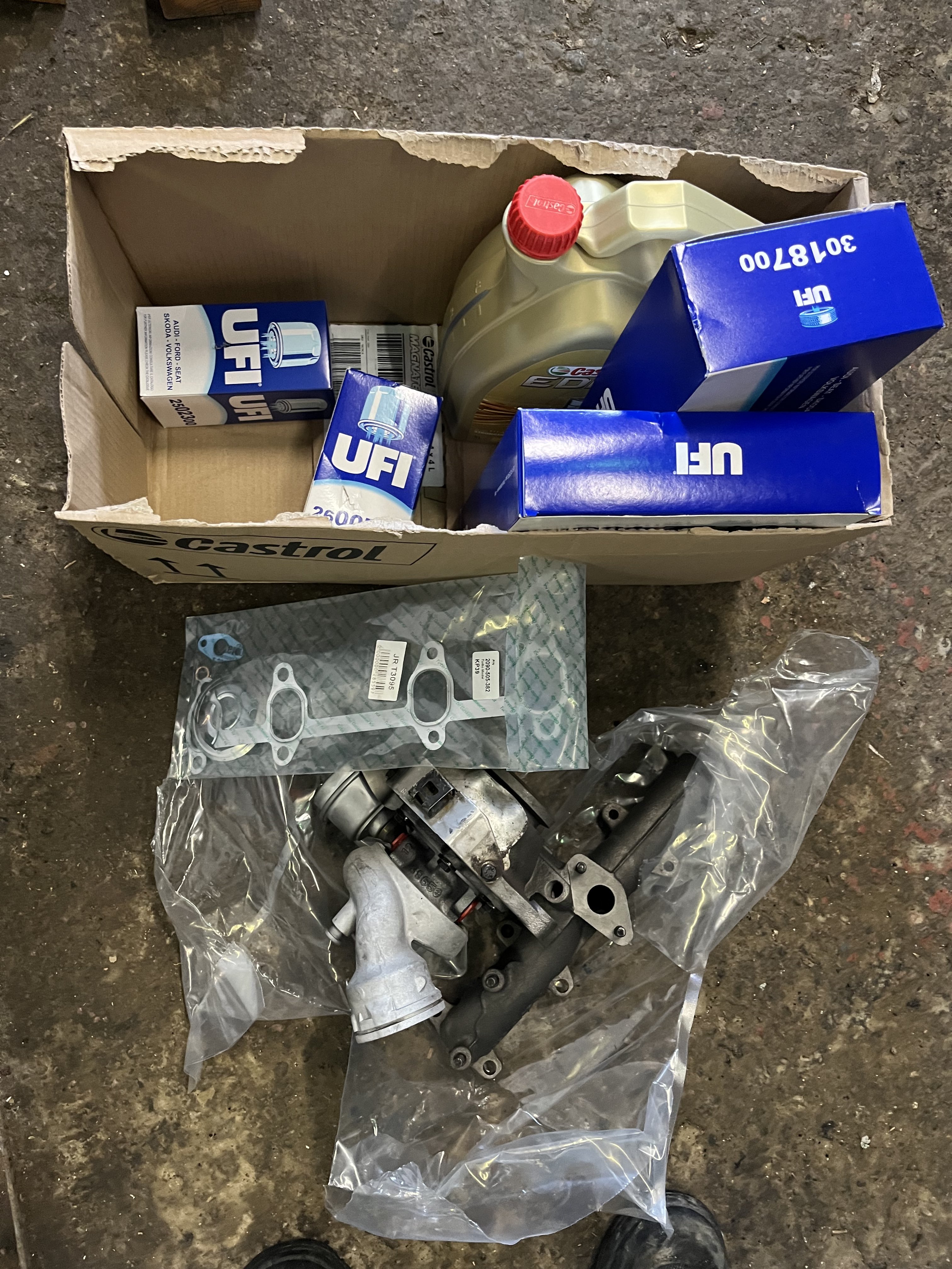

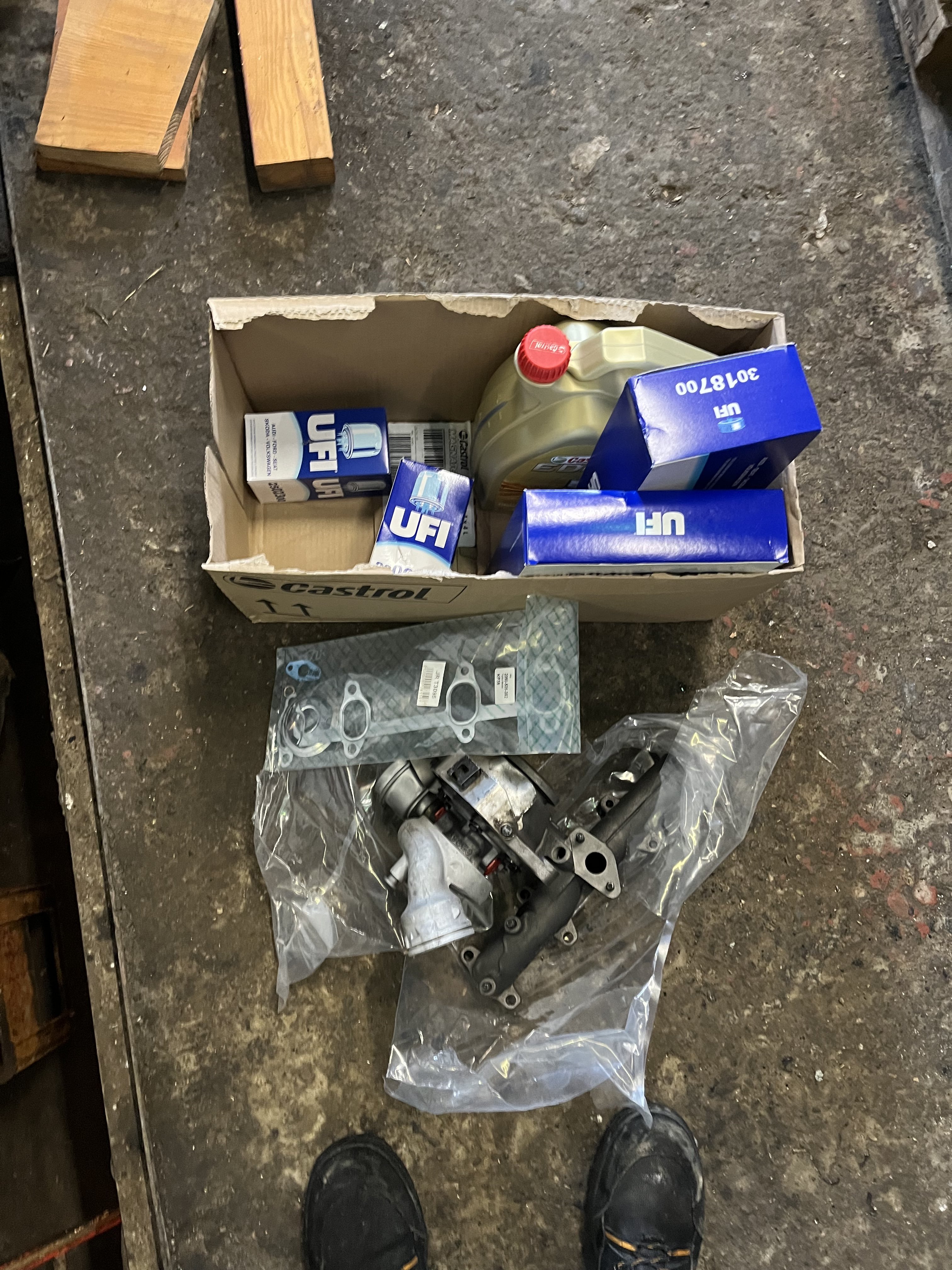

im replacing the whole manifold.
Thanks Jakubini, a workshop manual probably will be good to have

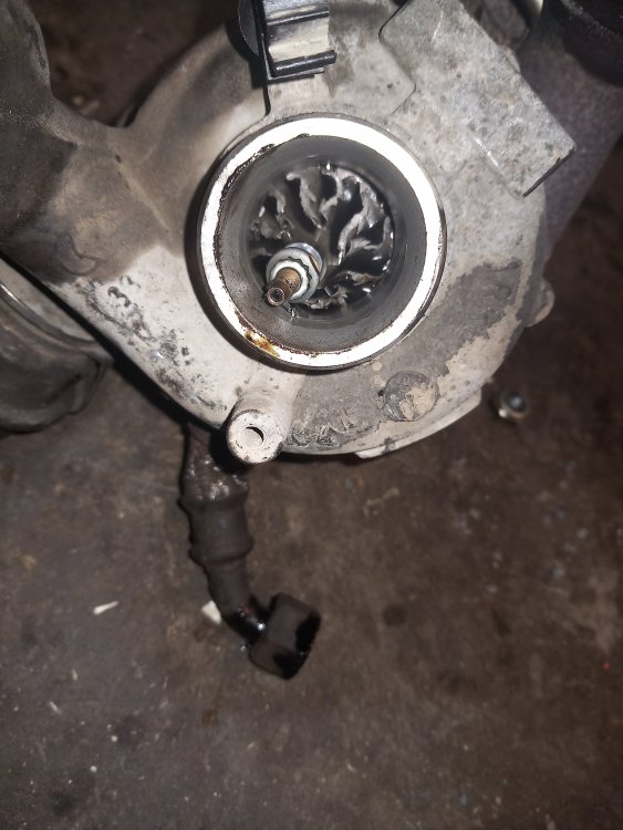

Heres a picture of my turbo, and theres no bearing left.

That's quite something, consider the cause and not the effect.
It would be prudent to drop the sump and check the oil pickup for obstructions and replace the oil filter and immediately check the oil pressure upon starting the engine.  Otherwise you could kill your new turbo prematurely.

There are many variables to consider e.g. oil quality, driving style, previous indications of impending doom.
It's just speculation on a forum, we cannot ascertain the situation first hand e.g. how much oil was ingested, how quickly etc.
By the looks of the turbo it was shagged out and on its last legs and suffered catastrophic bearing failure when the turbine side oil seal failed.  I say turbine side as you previously mentioned oil from the exhaust, the compressor looks clean and you did not encounter a runaway engine.
Check the air filter assembly and pipework to the turbo inlet for integrity and foreign objects, the damage to the compressor suggests FOD damage, possibly from a loose intake pipe drawing in something, the resulting damage and unbalanced turbo assembly causing it to self destruct.
Food for thought but you are correct in looking at the bigger picture, all relevant air/oil systems need thorough checking if a repeat incident is to be avoided.

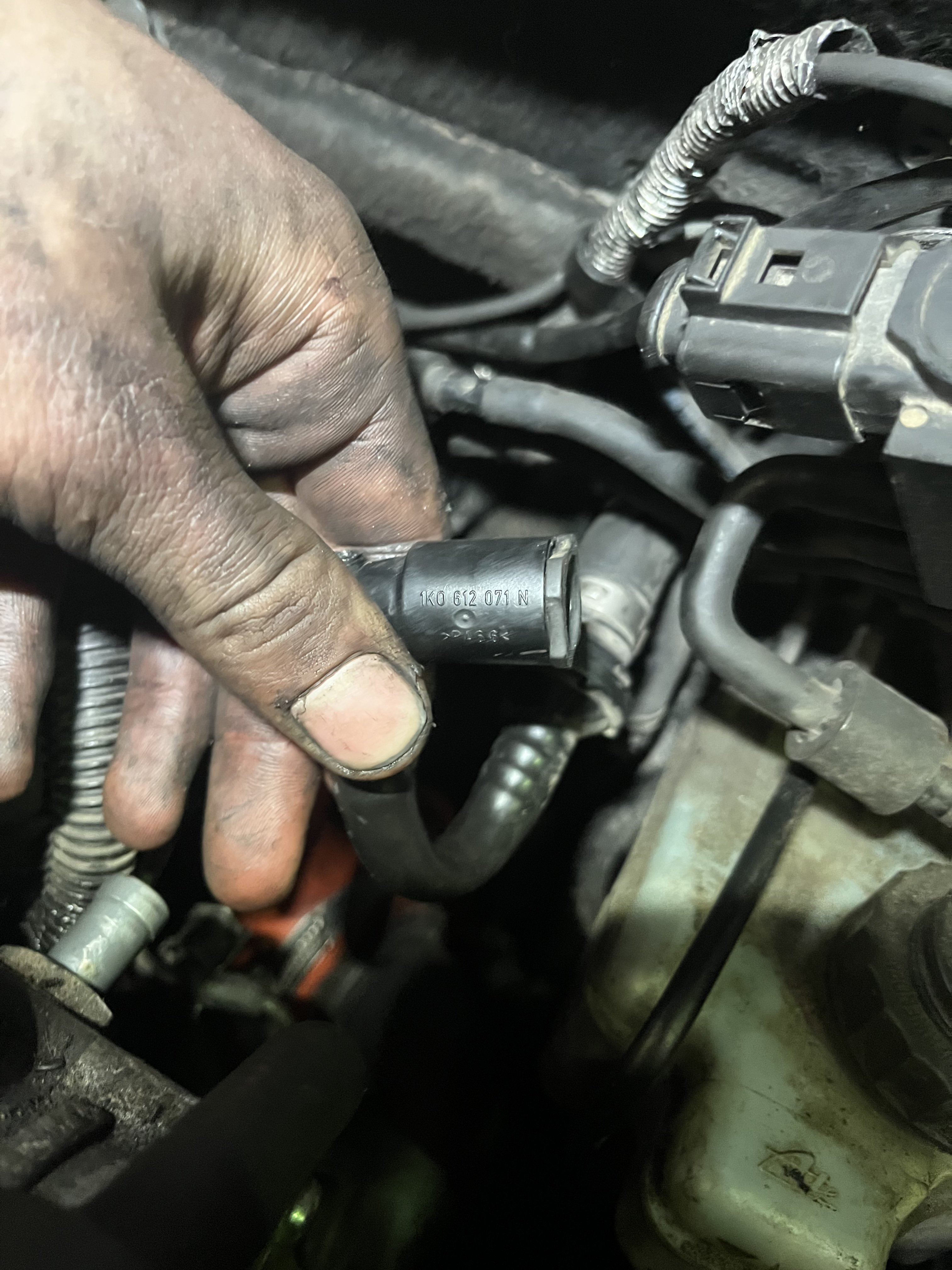

Thats nice to hear ! 🤩 turbo looking so destroyed 😀 do you want buy brand new or refurbished ? And be careful with this tube, I broke it and it was carrying a booster for brakes (that is translated) brakes were not working properly 🤦‍♂️ it's coming from vaacum pump to servo cost around 40€ 🥶
