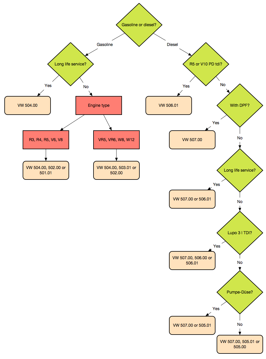

If you are doing fixed service intervals which early Fabia were then VW502 00 so 5w 40 FS was fine, or the VW 504 00 / 507 00, 5w 30 FS III.
TSI's MPI's.
Same as when Skoda gave the code that the engines could be Variable / Flexible Oil & Filter serviced.
TDI's.
require VW 504 00 / 507 00  For fixed or variable service intervals.
Petrols.

You want 5w 30 FS III to VW 504 00 / 507 00.   So what oil are they using?

Longlife oil used in a car set to QG2 is OK. So use either 50200 or 50400
Non-longlife oil used in a car set to QG1 is not OK. Use only 50400.

It is a Mk2 Greenline II with a 1.2 TDI is it not?
So it shows as 'VW 504 00 / 507 00' required.

Agreed: I inexplicably thought we were discussing a petrol car.
I’ve checked the rest of the paperwork and the maintenance list says they’re using VW 507 00.
