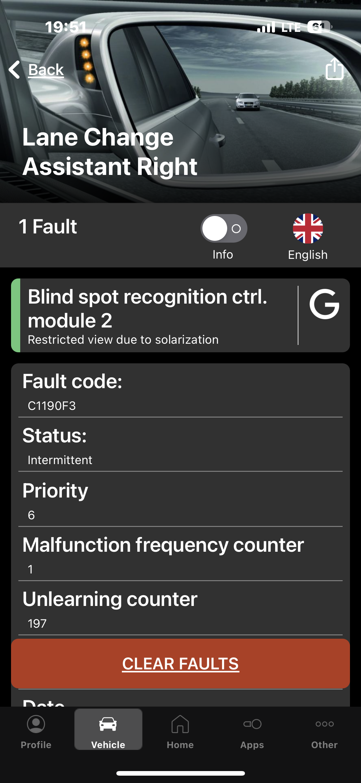

i have today error on my skoda superb 3 2017.
On display says Blindspot sensor error.
I do a scan with obd and this is what i get.
whats wrong i dont understand?
Likely nothing wrong and the system confused itself.
Clear the codes and see if it reappears and if it does reappear, get it scanned with VCDS
Bear in mind the radar sensors for the blind spot monitoring are in the rear bumper, I’d check that there is no excessive build up of dirt or ice in that area which could possibly degrade the radar signal.
Like either the master or slave blind spot module is faulty.

Thanx
will check today.
